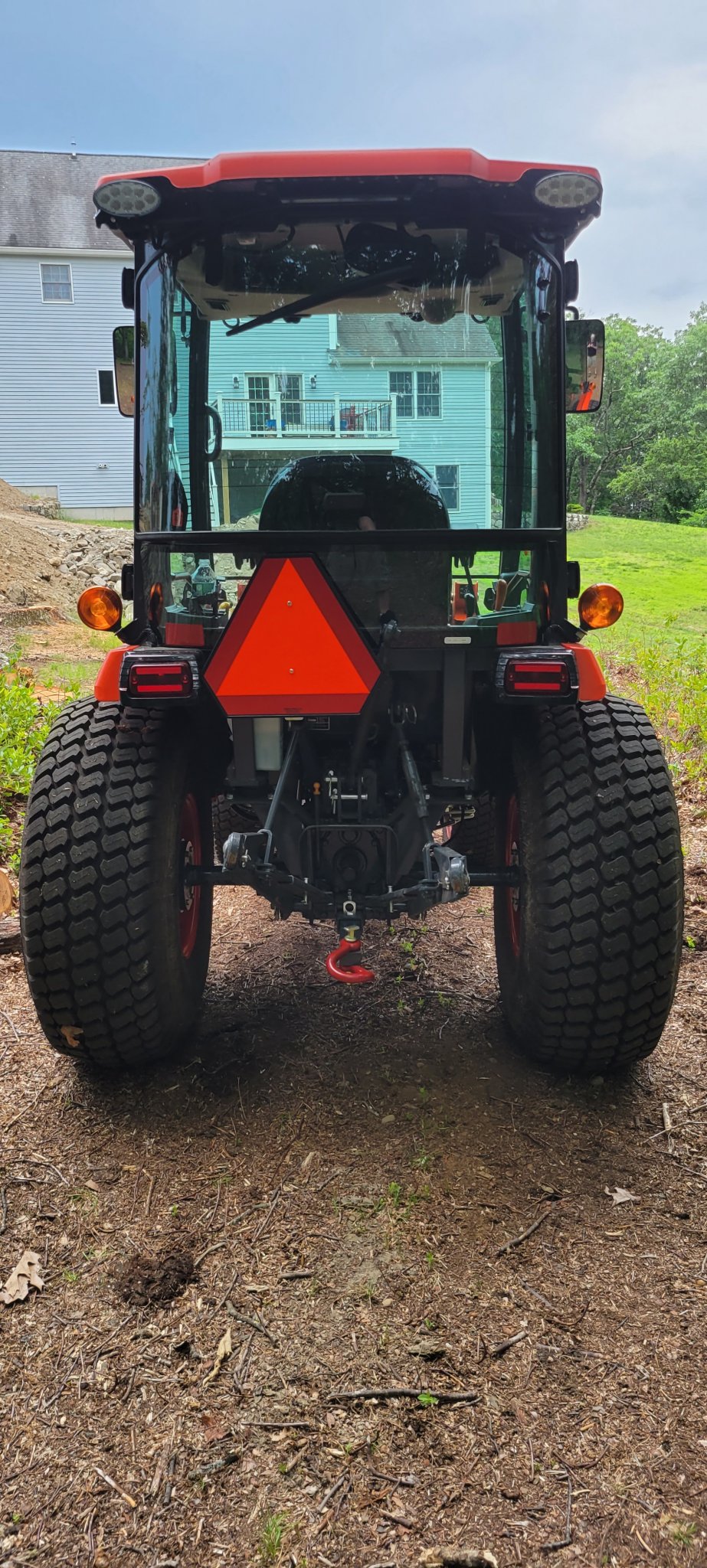

Jack@Northeast
LX2610HSDC
May 15, 2021
37
34
Natick, MA
BRO-TEK 3", no stud removal necessary. Took about 3 business days from order to door.
Hub and wheel centric.
Much more stable. I struggled with 2" VS 3", Bro-tek strongly recommended 3" and it was the right call.
Completely satisfied with size and product fit and finish.
