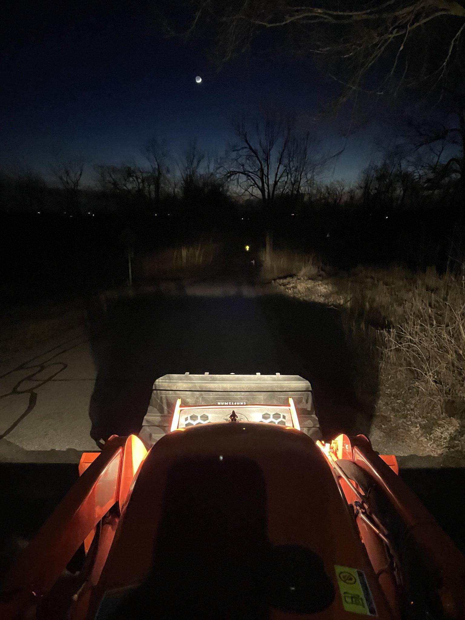

I think if want more visibility to others, I would question if you have already added light bars on rops (FWD and RVS)….if you have a high output lightbar people that arent texting will see you. Below is before and after…most people will see that and slow down and proceed cautiously, at least where I live they will/do…they may even waive with just one finger to let you know your the best. 😉
Anyway if not worried about the flashers maybe consider to add some more light front and back. Personally I would leave the flashers alone so you have that extra visibility in the daytime.YMMV.
