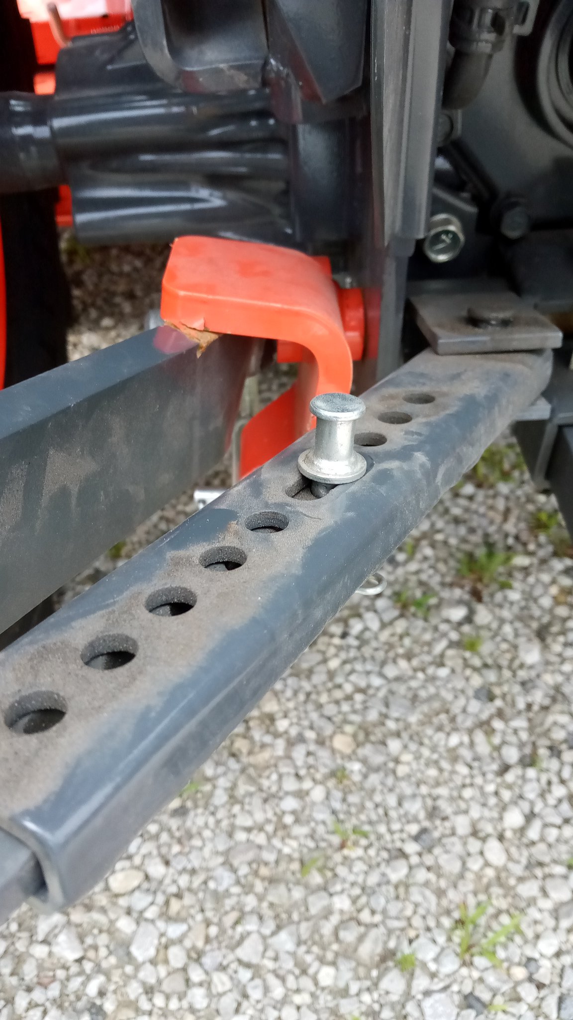

Thanks. I will check it as best I can.
I hope ours is adjusted correctly now. It's been back to the dealership 3 times, just for that. The orange piece that hooks over the 3 point and connects to the deck lift linkage kept bending.
