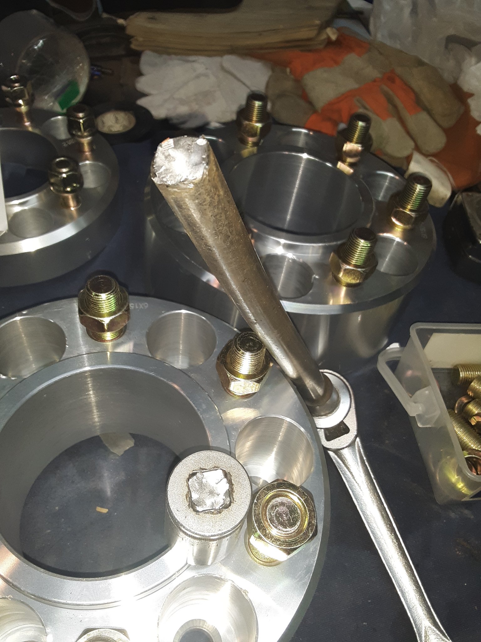

Not to hijack too much, but I just did this today trying to get off my rear wheels. My air impact wrench won't touch it, and I snapped a no-name 1/2" extension on bolt number 2. I am guessing this is normal? Wowzer that's seriously on there. Not sure what to do if I break another extension. Any helpful ideas?

Use a torque multiplier or a larger size socket set like 1 inch and a shorter extension if possible

Not knowing you experience I do not mean to insult you. If you can get a heavier socket set. Use a 6 point socket if you can. Do not jack up the tractor yet. Then place a jackstand next to the wheel. Adjust the stand so that the socket is on the bolt head and the extension is level attach a breaker bar on the extension so that you can push down on the breaker bar. The end of the extension being supported will make a big difference in the transferring of the power to twist the bolt.
Or at least a good-name 1/2" extension and breaker bar. Quit abusing that ratchet before you ruin it, if you haven't already :mad:. ( :) )

I don't have nothing bigger than 1/2" and some missing bits at that. I have been on the lookout for a deal on an old quality set of 3/4 or 1". I will see about getting a decent breaker bar, another extension, a jack stand and a beer holder. I only had a 30" cheater on that wrench, it shouldn't have broken.

You got some good tips above, try that first - definitely a breaker bar. I actually had some nuts on so tight that I ruined a breaker bar, so if you have something that stuck on, what helped me was heating the nut with a butane torch - be careful to keep the heat focused on the nut - it will expand and loosen a little, might be just enough to break it free.
But don't do that until you've tried everything else suggested first.
