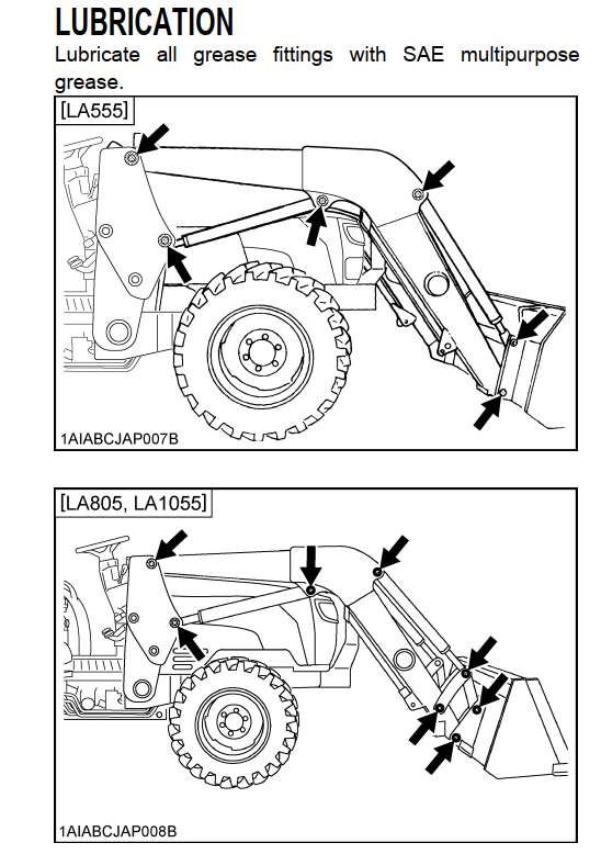

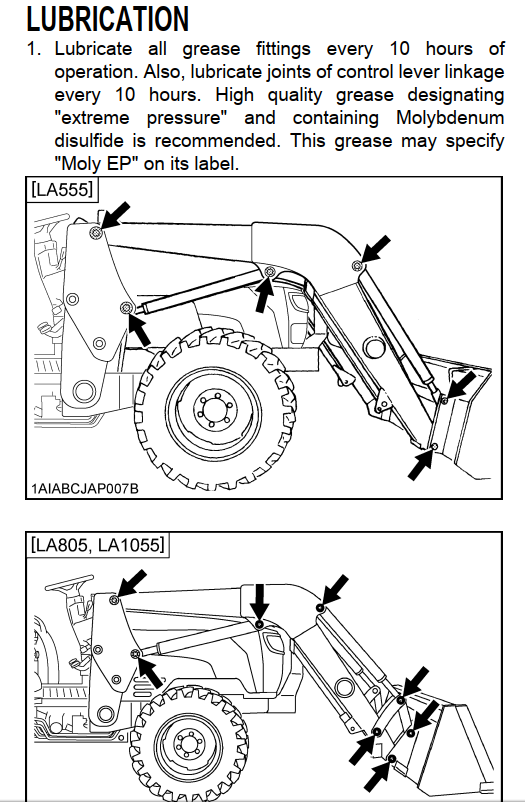

Hi Bark
I am new to the forum.
I greased my 765 loader a couple of weeks ago to my newly acquired 12hr L4701. The ops manual called out for GP grease, buy the loader manual called for moly. So I used a 3% moly lithium base grease. Did I go overkill ?…..because regular grease would be less messy…that black moly is a pita.
I feel your pain. My manual states to use MP and later is states to use Molly EP. My take away, just make sure it is greased. Molly is preferred, but MP will work. (I use Polyurea grease (MP). )
30 pages later it states this
You have it absolutely correct!
GREASE is most important!
The flavor......not so much!
