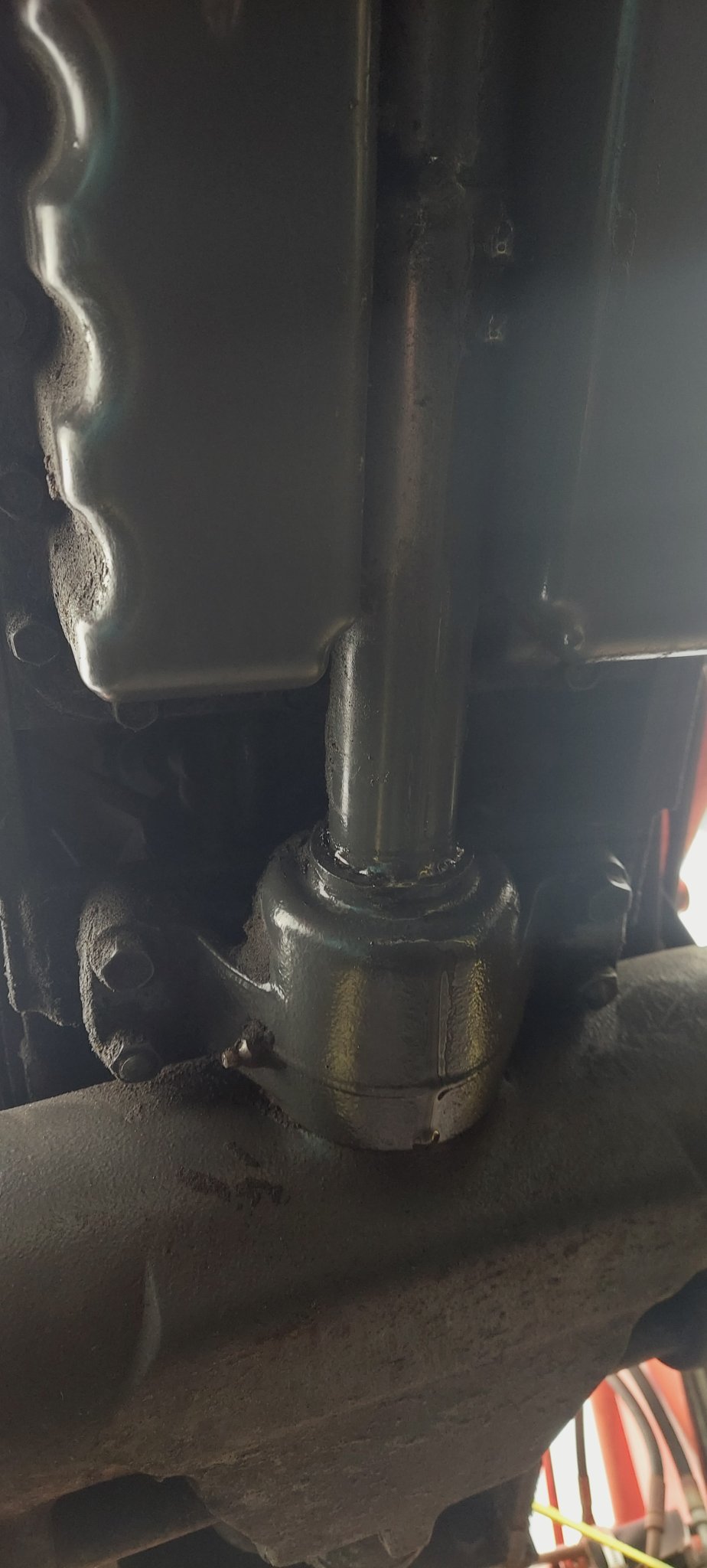

After reading https://www.orangetractortalks.com/forums/threads/kubota-udt-substitute.4036/#post-29179, I suspect a previous owner, likely the shady seller/flipper, put in some cheaper alt oil that ruined a seal and caused a leak and loss of power. Photos are two days after driving home tractor. Wouldn't move in H, barely made it up ~5% grade in L.
