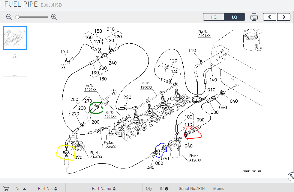

First try removing the input line to the fuel filter from the tank (RED), (have container at the ready.
You should be setting a good flow of fuel from the line.
If your not getting good flow, you'll need to remove and clean the tank.
If you are getting good flow, put it back on the filter housing.
Now remove the line at the lift pump input (YELLOW) (from the filter housing) and check how much flow you get there, it should be the same as the line from the tank.
If it's not getting good flow you probably have a clog on the input fitting of the filter housing, remove both lines (RED, BLUE), and blow air in the output (BLUE) flushing out the input fitting.
If you do get good flow, replace the input to the lift pump and remove the input line at the Injection pump (GREEN).
Crank tractor you should get good pulsed flow out of that line.
If you don't get good flow, you have a bad lift pump.
Anything beyond that is much more complicated.

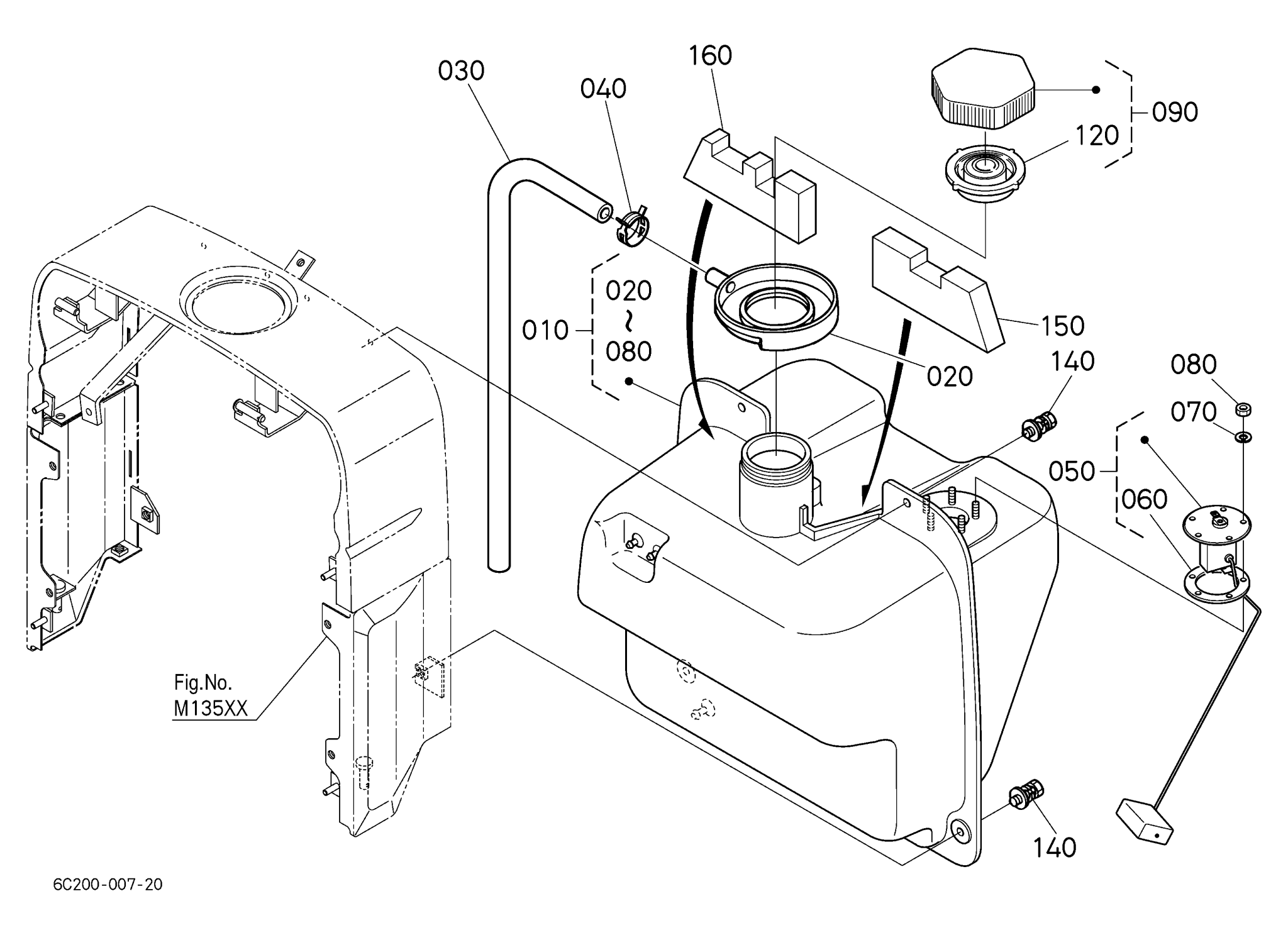

found this on the Kub Cda site, looks like an EASY tank to clean while on the tractor.
I'd disconnect hose as NIW says at the red circle and let ALL of the tank drain into buckets. Remove those buckets.Then add some fresh diesel,say 1/2 gallon and let it drain into a new bucket. You'll get a 'feel' if the fuel is clean and flowing. if not, do it again. Ideally poke a strong LED light inside and a camera to see how it looks. Worse case, tank has to come out for a proper cleaning. See if the WSM is available at www.kubotabooks.com. You just remove whatever's in the way of getting the tank out. Online parts places have the drawings as does Kubota, to help show you what's involved.If tractor wasn't used for a few months,there could be 'black algea' in the tank.
6,807
2,344
If the tank is steel I would suspect that it has rusted inside and will need to be cleaned out and repaired with some sort of tank liner paint.
When draining the tank out you can use a paint strainer or coffee filter to see what is in the tank.
