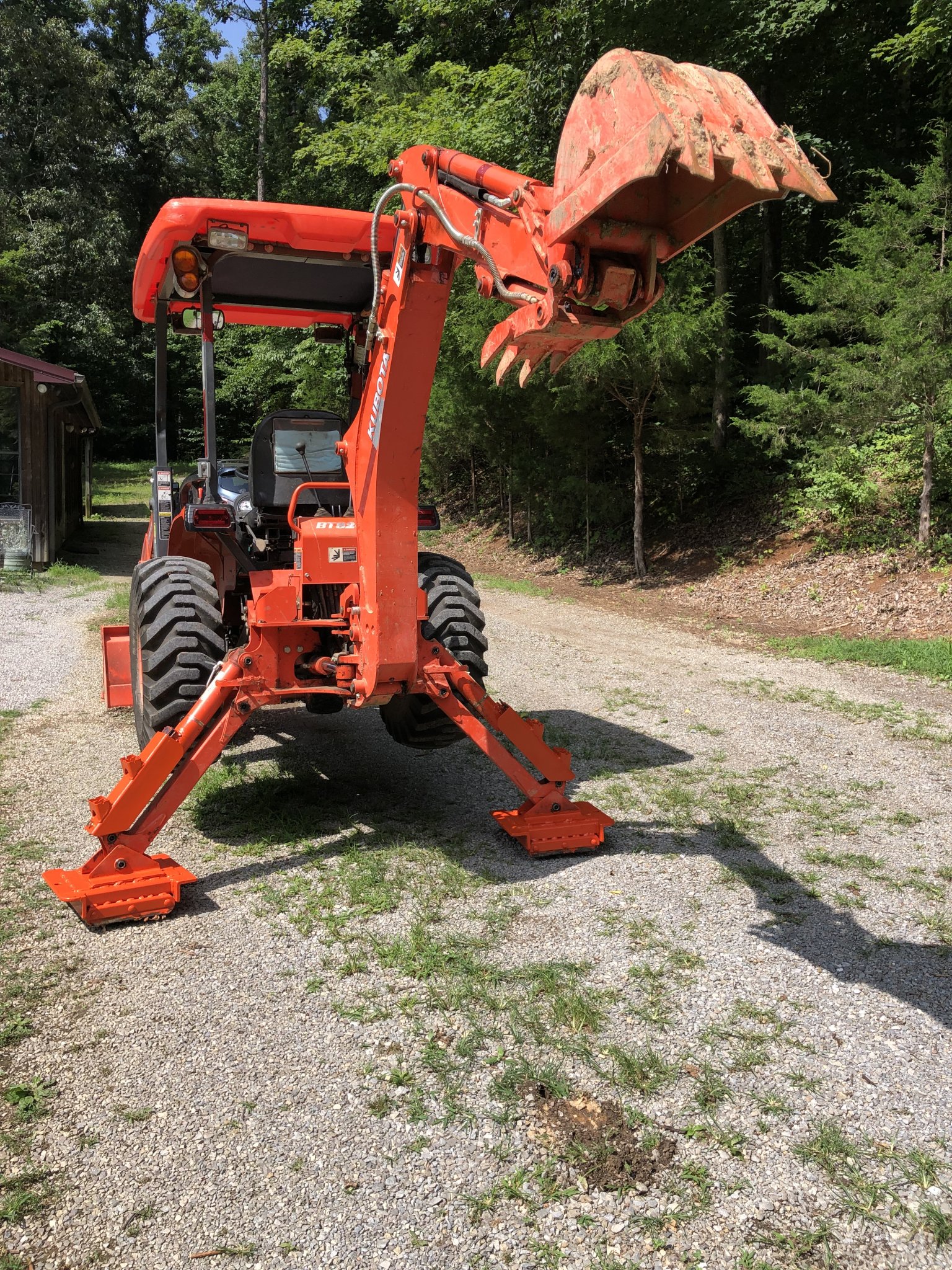

We like our B26. Replaced a B20 model we had for over 20 years. Tough, capable little TLB tractors with a big heart.
Often used by rental companies even Home Depot. Operator friendly. How well it was maintained an issue with any used tractor. We bought ours used from a local rental company with 50hours, <year old with every option, buckets like brand new. Auction saved us about $10k from a new one. It might gone up in value in 7 years.
Maintenance is critical with any machine. Kubota filters and oil. Greased regularly? 3pt arms? Thumb? QA backhoe buckets? 3rd function? Weather worn or shedded? Manuals? Recent repairs?

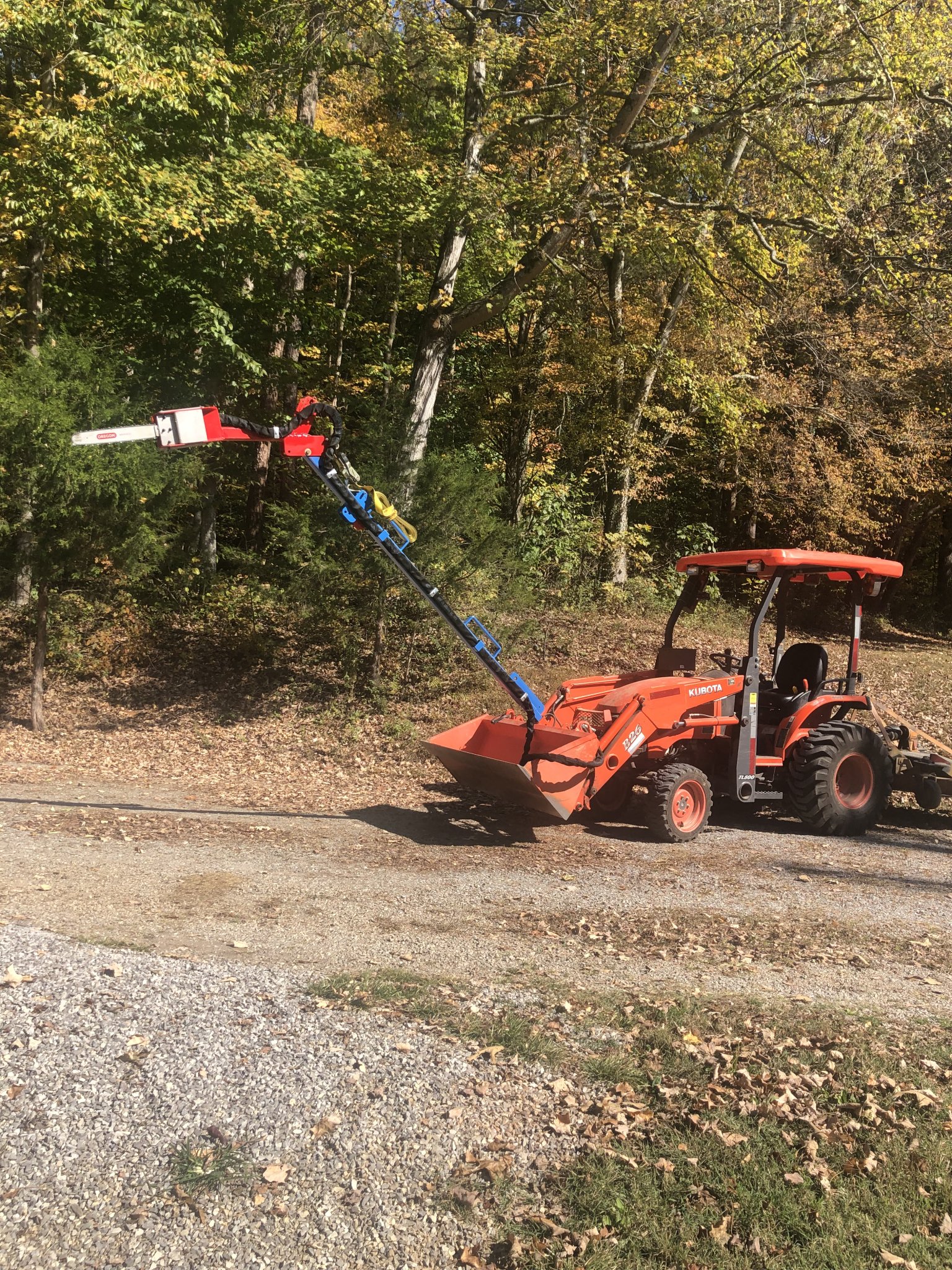

B26 with chainsaw tree trimmer.
B26 is an expensive but extremely useful first time tractor. Easy to learn to operate. More powerful FEL and backhoe than it’s AG cousins.
Fits where the bigger tractors can’t. Many modifications to better serve our hillside farm.
