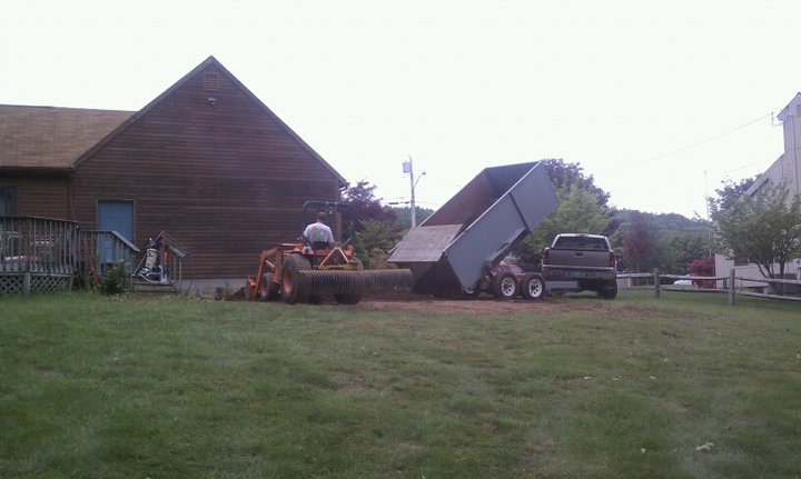

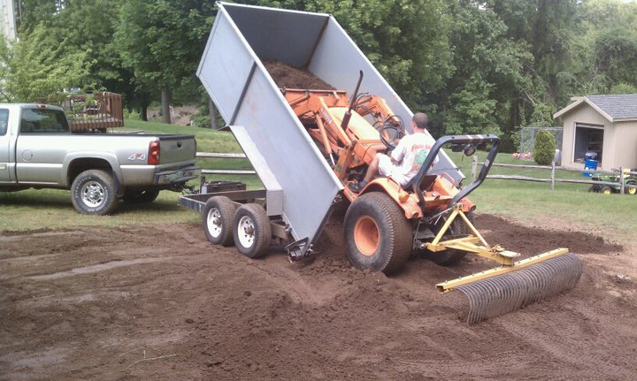

I see Eric really hates trailers for many reasons, I respect his opinion.
Just posting up some pics of my 10.6 yard dual drop axle 10,000lb trailer that I bought used and completed for less than $1500. (Thanks Craigslist!)
I could buy a new battery every year (or every month) and never get close to the price of Insurance+taxes+depreciation+maintenance+registration on a comparable dump truck.
There will always be some areas where a dump truck will be more maneuverable than a trailer, however the trade off for me is a HUGE cost savings and increased usability of my pickup truck. I also stay out of the CDL territory and CT DMV doesn't mess with private trucks as much as commerical rigs. All trucks 1ton and greater require Commercial reg in CT and thus require appropriate insurance, registration, taxes, etc.
<snip>
2500HD duramax with air bags is the trick.....
Agreed on both points. Love my 2500HD Crew 4x4 DMax.
I think a big part of the difference of opinions is usage. He wants something to use ALOT, and something to tow his equipment at the same time as hauling material. That completely kills the pickup and dump trailer. For me, it would be a few times a month at most, and as you say, a trailer wouldn't need maintenance, insurance $$, etc like a truck. And which is easier to use at any point is going to be determined by many factors specific to the task at hand, so probably no clear winner in general.
Are you kidding me!?!? Out here you couldn't touch anything like that for twice the money! Man, I gotta make some shopping trips back east…..
