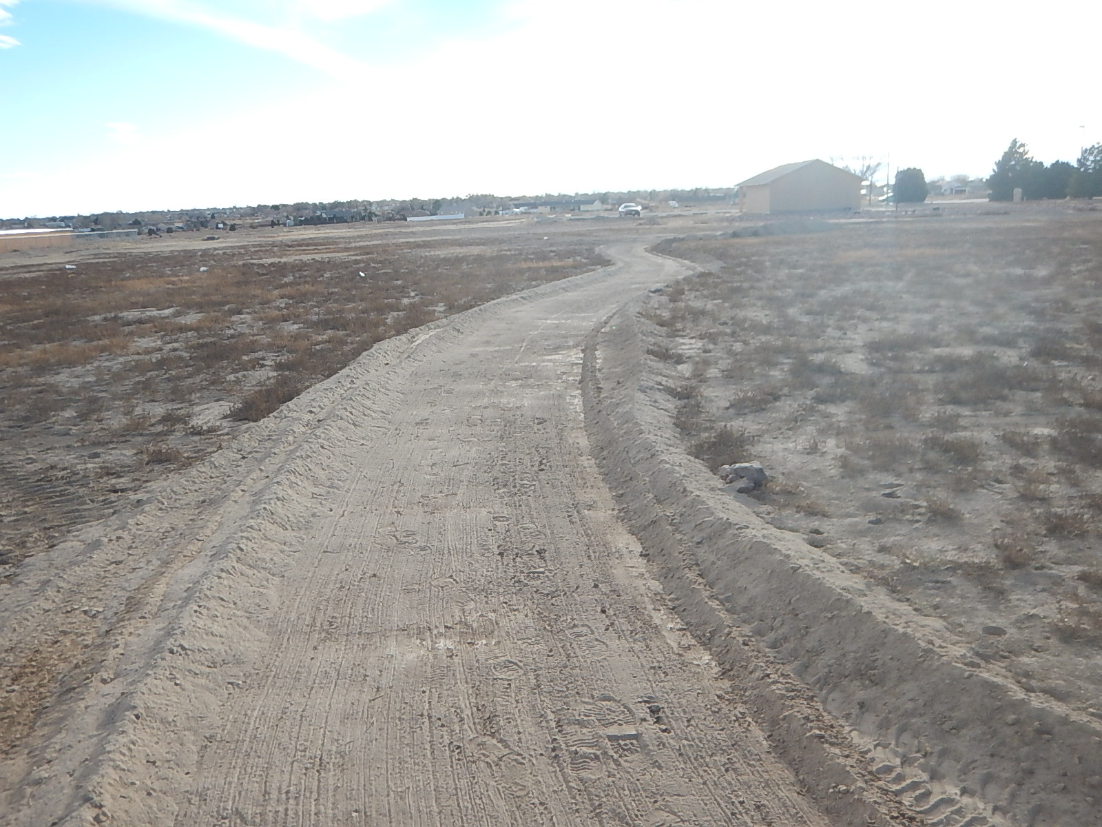

I currently have a 7 ft wide landscape rake that does a good job grooming loose gravel, but I have a project to make a 1/4 mile path.
The dry powdery ground here in Pueblo has few rocks and the path will involve removing about 2-3 inches of top soil to the side, then we plan to spread a layer of 3/4 inch ground asphalt to 3 inch thickness, level and run pack it in. Then I intend to taper the loose soil back to the path edges with my landscape rake.
I am looking for a 6 ft blade to cut down and level the surface with a couple of passes both ways throwing the soil out. It would be nice to be able to offset the blade, but I think that the 6 ft angled should still cover the five ft rear R4 tires on the little 2501.

Looks like you got the job done. Thanks for the follow up photo. :)
