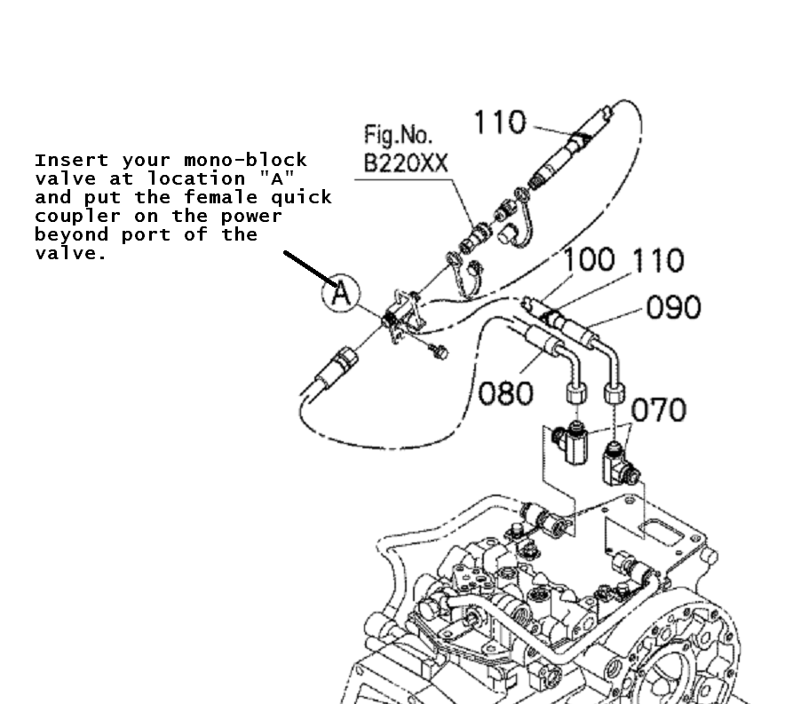

  3. After you get the tractor purchase a small three spool add-on valve and install it and the outlets yourself. Mounting and plumbing it is trivial. The picture below is one possible location for the valve - you will need to bring it out in front of the seat and up a bit to stay clear of the factory valves. There are plenty of other locations if you don't like that one.
  4. Put a quick coupler on the power beyond outlet of your addon valve set and use it for hooking in the log splitter when needed. If you want to get fancy use a selector valve in the power beyond circuit and another set of outlets.
You can add all of the extra functionality for significantly less than the three factory remotes will cost and it will be neat, trouble free, and easy to use..

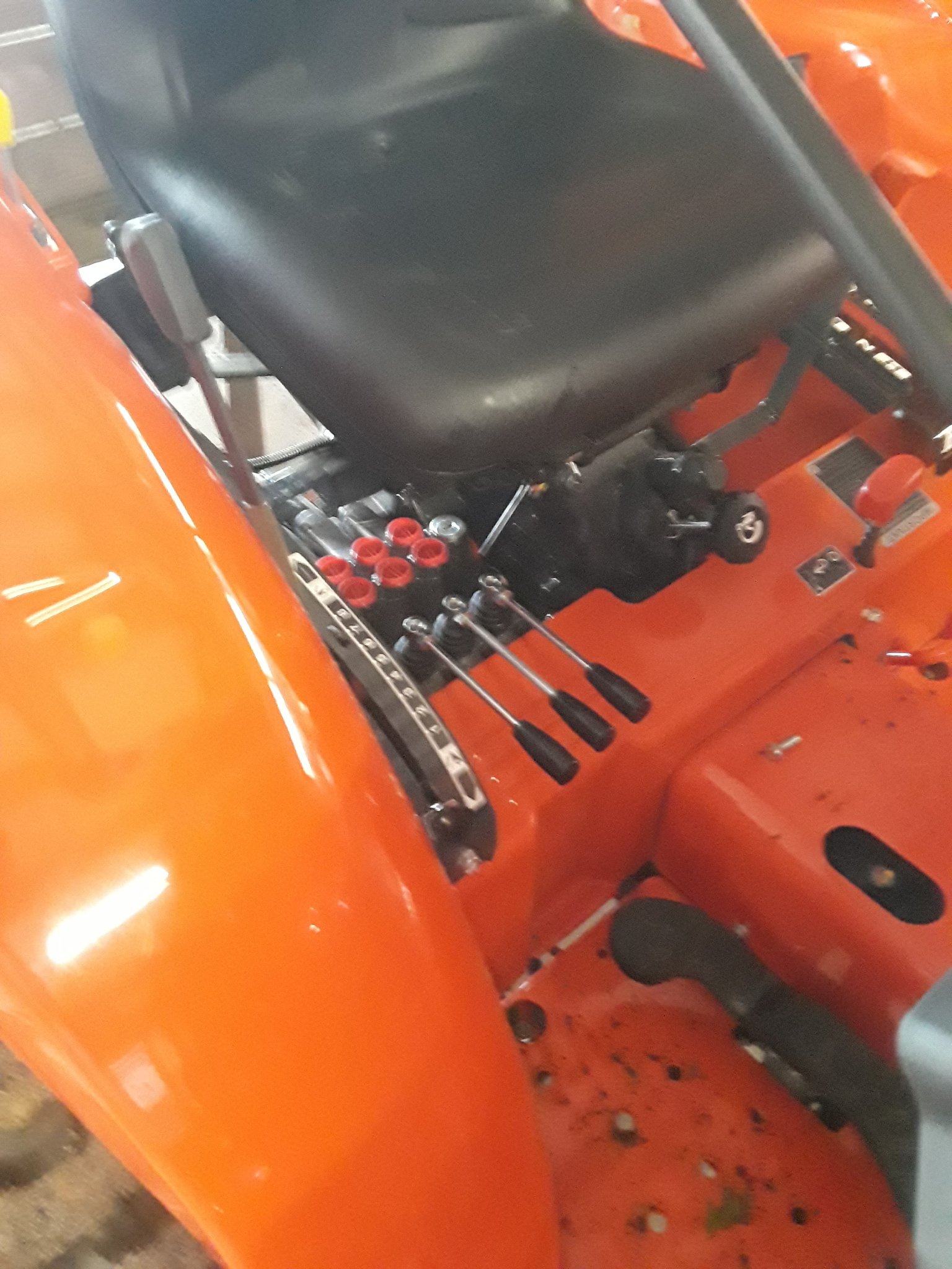

wondering if it'd be easier plumbing to have triples on both left and right side of the seat area ??
Have no idea what ,if anything, is in the way, jes thinking about options and 'ease of use'....
9,911
5,244
On the L01's no room on the left. When you start talking six valves you probably want to start thinking about remote mounting and cable or electric controls.

Ultimately I decided to buy a Grand L6060 with 3 factory RR floats, a 3rd function up front, and with a power beyond loop set up so I can plug in either a logsplitter, or a Summit Hydraulics monoblock valve which I'll bolt to the ROPS to get additional remotes and valve types. I can design and 3d print and then cast in aluminum some mounting brackets to bolt the valves and additional ports to the ROPS.

I assume the dealer is providing the same power beyond loop used on the back hoe. if you are going to put another valve on the ROPS just plumb it directly off that power beyond. Then you can put a female coupler on the power beyond port of that valve and use it for your log splitter or anything else that needs a constant flow outlet. And if you pick a suitable valve you could also put the quick couplers for your extra remotes right on the work ports on the valve. That would eliminate a lot of hose clutter which is going to be a real issue with that many valves.
PS - I would not pay the dealer for that power beyond plumbing - you can do it yourself for the cost of a couple fittings and the hose.
PPS - You are also going to need a tank return for your add-on valve - is the dealer providing that?
