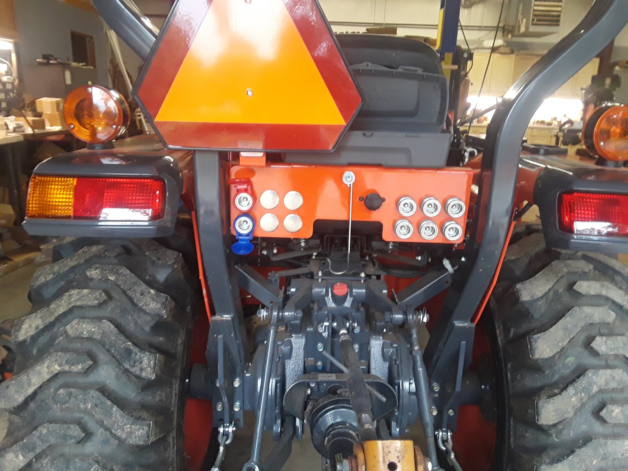

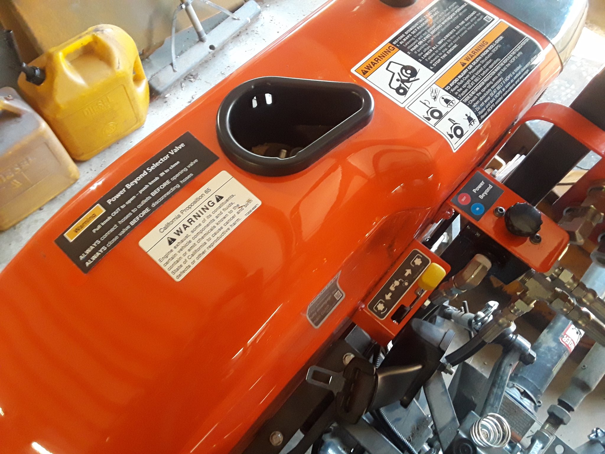

Your setup is not at all complicated. It just involves more valves than usual. I have plenty of those outlet panels but it may not work with the OEM hoses and couplers.
Assuming the L02 is the same as the L01 the factory remotes are a three valve stack bolted to the side of the hydraulic top cover. They are fed by a hose coming off the power beyond on your loader and return to the hydraulic outlet under the front floor board. It is cheap and easy to insert a two or three spool valve in the middle of that loop.
Feeding the log splitter off a directional control valve is a poor idea. Plumb it into the power beyond loop like any other valve. You can get fancy with a selector valve and a couple outlets or go cheap with just a male/female quick connect in the hose loop. The latter is exactly how Kubota connects their backhoes.
By far the cheapest and most effective way to add additional remotes is with an additional control valve inserted into the power beyond loop. Two additional spools is maybe $300 including all of the plumbing and outlets.

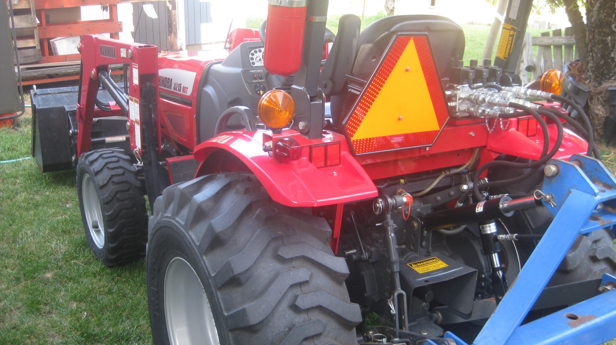

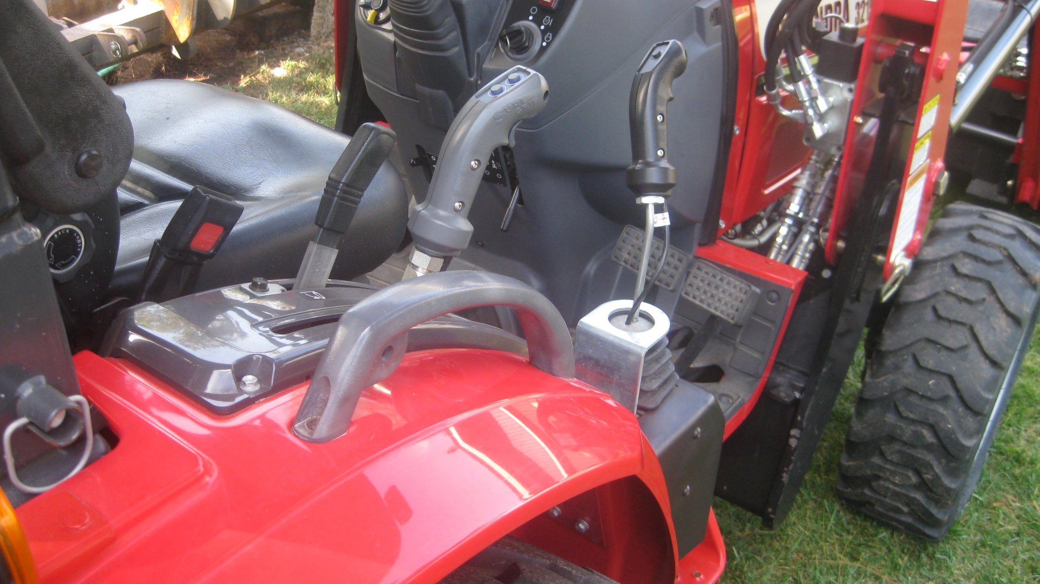

On my Mahindra 3215 which is the same physical size machine as the 3902, there is only a single factory rear remote available, I installed a stack of 3 Bosch cast iron diverters so that I have 4 sets of couplers to use all with a single lever with a 3 switch control grip on the lever.
This has worked out well for me, :cool: but there are times when I think that I might prefer 4 separate valves and levers. :unsure:

I think I have the outlet mounting situation pretty well covered :unsure:

The factory valve mounting is in an excellent location. The control lever placement leaves something to be desired in my opinion and their coupler mounting is even worse with the same mount being used in several different locations depending on if you have a backhoe and if you purchased some place other than the USA.
I have seen the same coupler mount situated at least 4 different ways.
Your coupler outlet is excellent (y)(y) other than it will not work for those with a backhoe. 😞

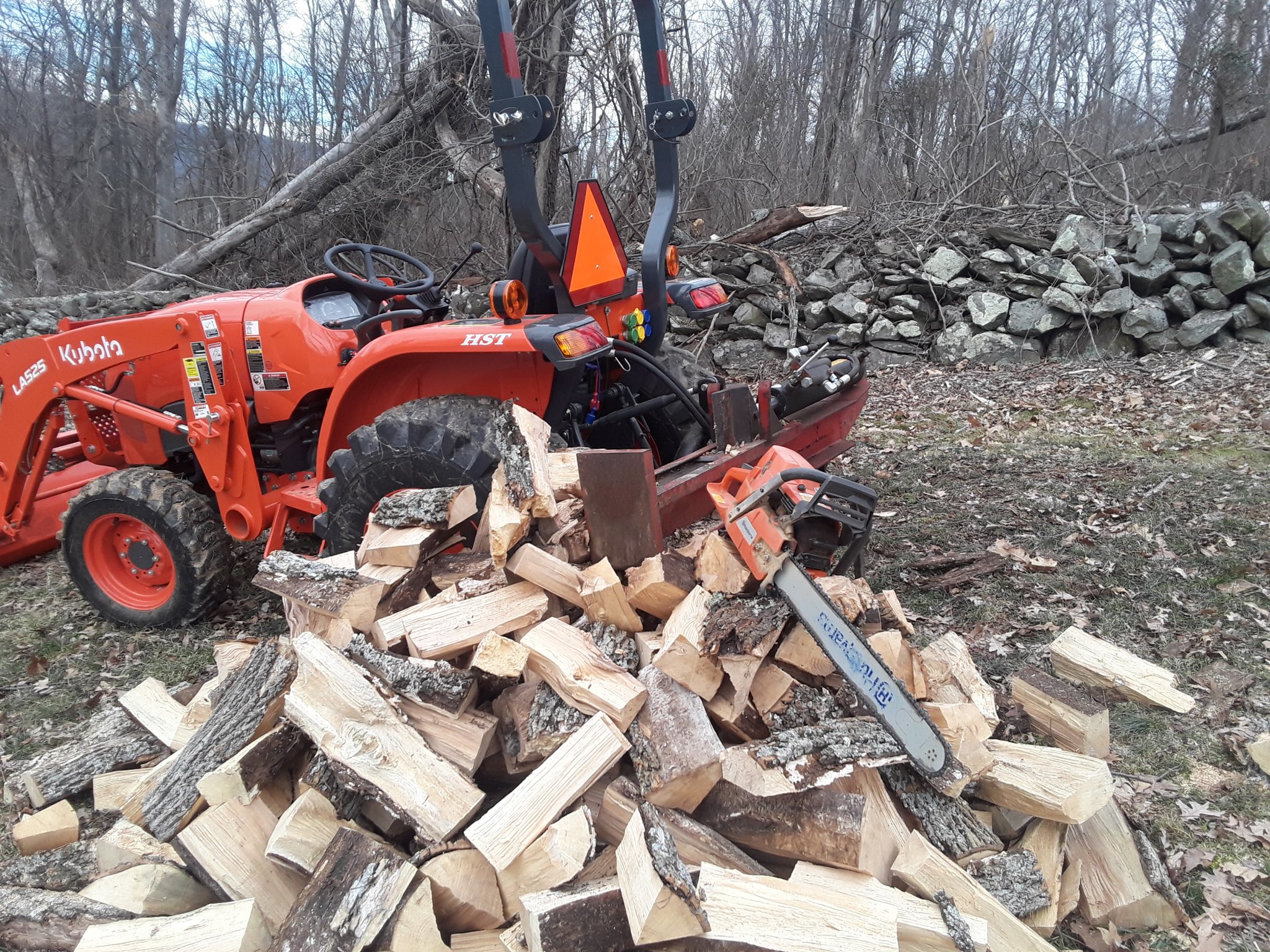

Also have you tried a tractor attached log splitter? They don't work well as the flow of the tractor is too low.
Actually I have and in fact last year on this very tractor. The 6.8 GPM flow rate and regenerative splitter valve cycles my splitter as fast as I can comfortably load and split. I have been using this splitter for almost 30 years and still haven't come even close to wearing out a tractor splitting wood. Operating it is no different than a trailer mounted unit other than I don't have to fight with starting a recalcitrant gas engine.
Here's my tractor at work with splitter and "too many" valves.

@TheOldHokie I think Kubota's configurator page is buggy and incomplete still for the L3902... if you add a single valve it allows you to choose all four valve types, but if you add two or three it removes some types. Last week it didn't let you add RR valves at all, and other stuff has disappeared from the options since which are still on the L3901 and supposedly almost everything from the L3901 is compatible with L3902 and vice versa. The dealer I am talking to said that the configurator is still goofy for L3902 and not fully set up yet, even on the dealer side.
Anyway, I would love to buy one of your mounting plates from you. I showed your mounting plate pictures to the dealer and they said they were willing to set it all up and support it assuming their hydraulic guy agrees. (And I have to settle on exactly which valve types to use and figure out what to do for the extra levers needed)...It's a really clean and protected setup. And the dealer said that the main reason they don't like to add more than 3 valves is that they don't know how to mount them without somebody fabricating something.
I am a bit concerned about the problem noted about leaky valves. On the other hand, I'm not wild about installing the hydraulics myself.
