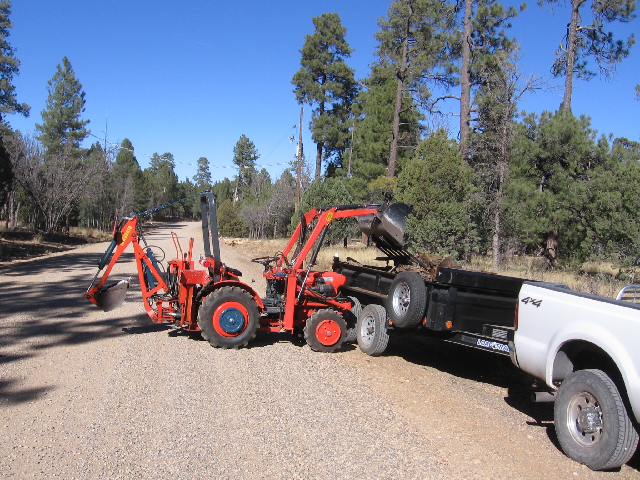

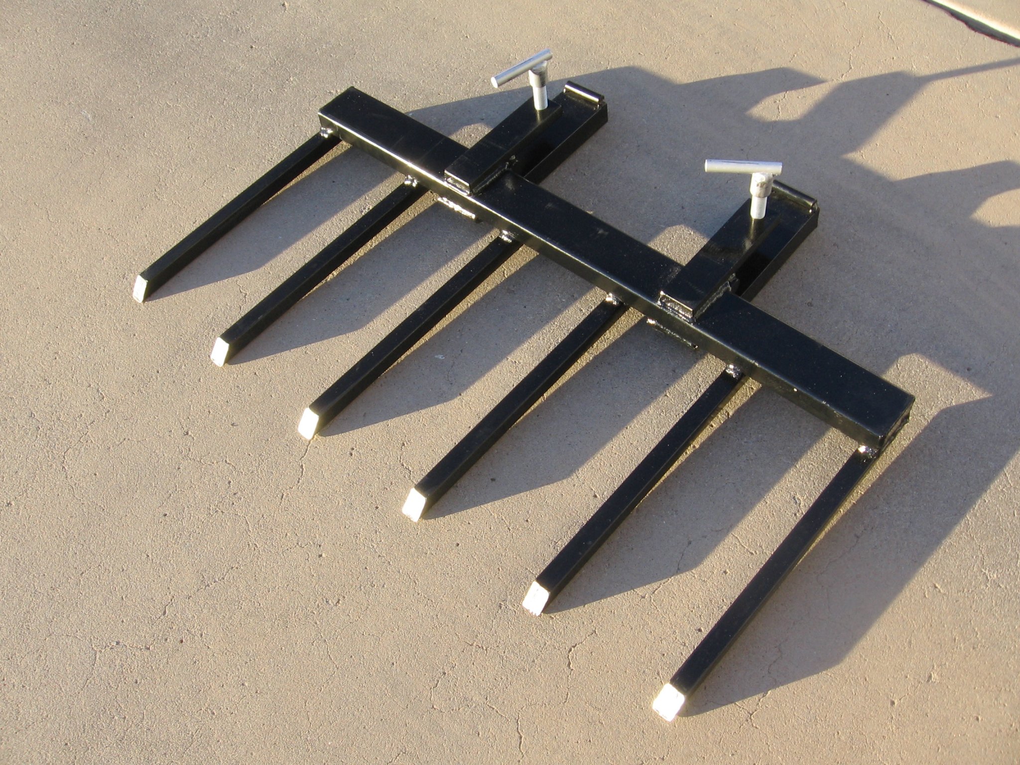

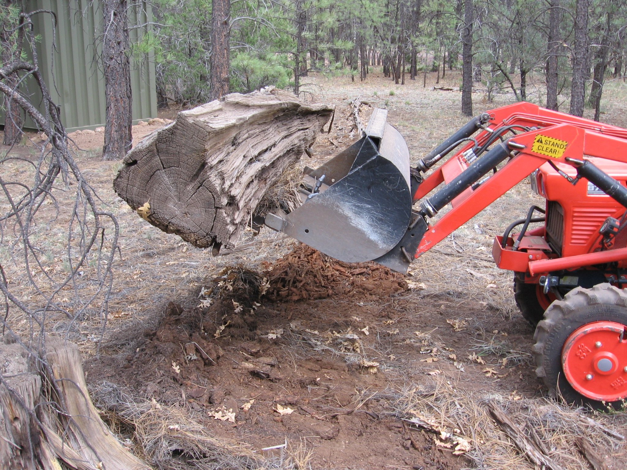

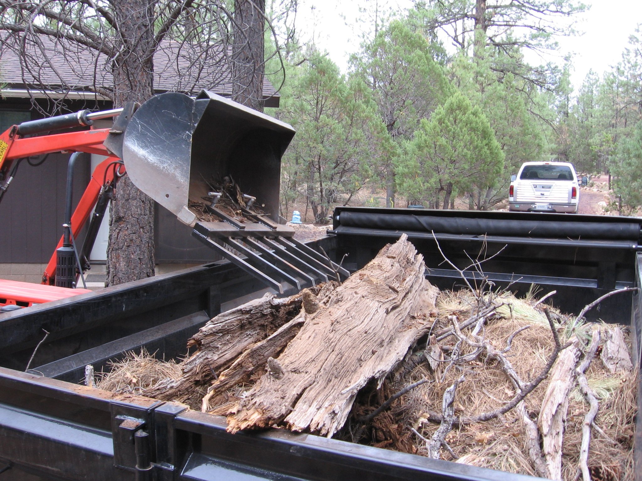

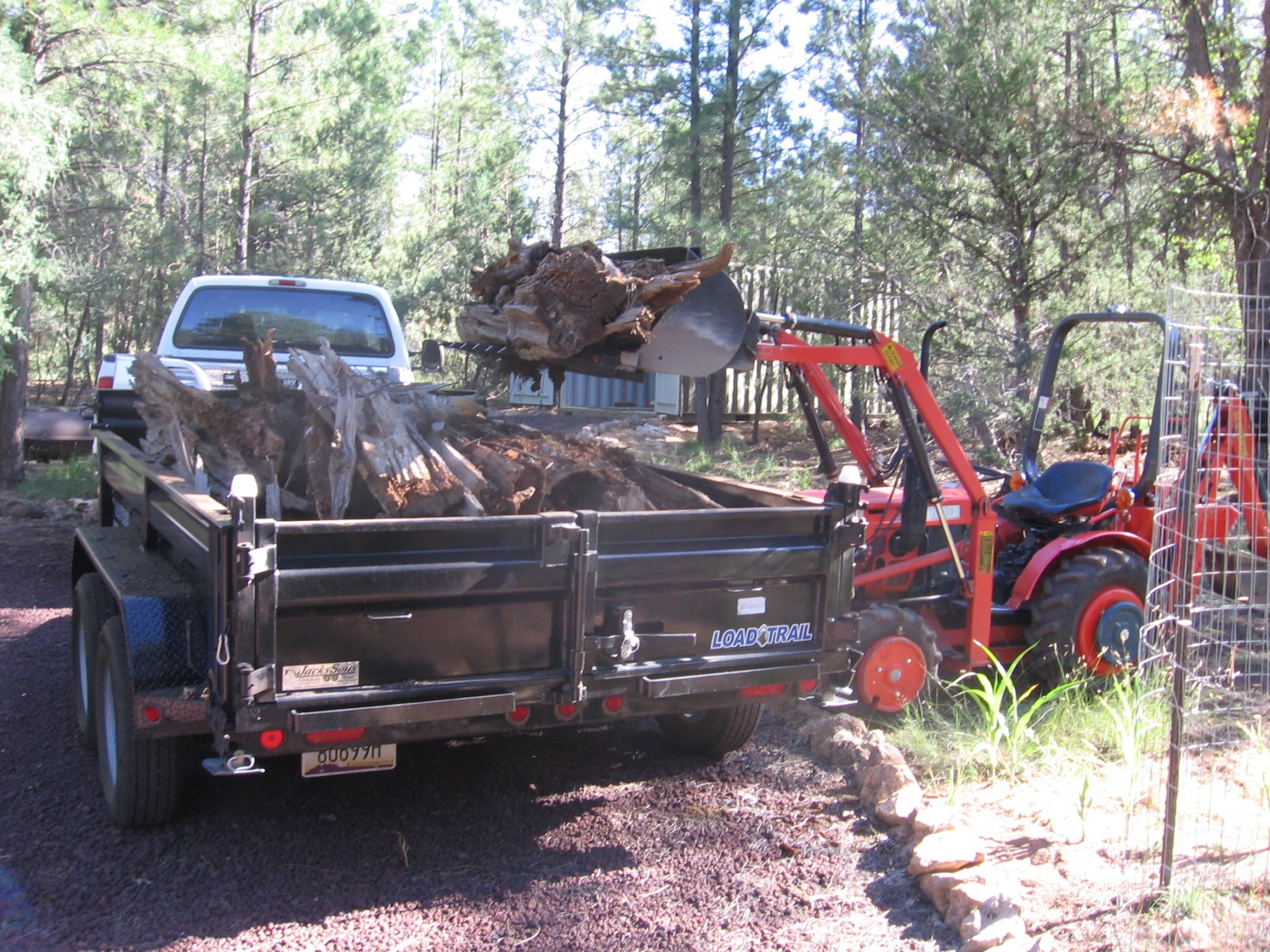

I know this isn't one of the implements you asked about, but I find my brush forks to be my most useful implement. If you have brush/slash/logs/etc to clean up, they are amazingly handy. I even use them as forks sometimes.
IMG_0082.JPG brush forky.jpg IMG_0047.JPG IMG_0052.JPG IMG_0003 copy.JPG IMG_0020 copy.JPG
View attachment 111312 View attachment 111313 View attachment 111314 View attachment 111315 View attachment 111316 View attachment 111317
