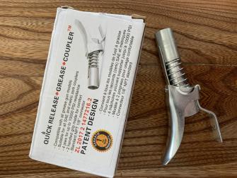

Hi guys, the Chinesium Lock n Lube alternative has arrived, first impressions are positive. It actually looks and feels better than I expected. Seams heavy duty,. Niceley packaged in a carton box and a tight buble wrap envelope... like nothing I’ve received from china.
I like the PATENT DESIGN reference. The direct Chinese translation is probably DESIGN COPIED AND NOW MASS PRODUCED FROM

Kubota sells them too. I ordered one and put on my Lincoln pneumatic grease gun. It's just too big for some places so I pulled it back off & put a the old/regular coupler back on. The lever is in the way for some of the grease fittings in pins like on loader bucket pins and backhoe pins. It's the exact same thing as a lock and lube....my coworker bought a genuine one, I bought the Kubota one. They are mostly identical as far as my eyes can tell.
