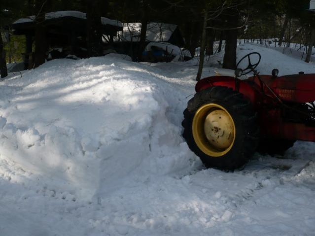

Here are a couple of pictures of the work the Kubota and blower have done.
You can see the cut that the snow blower was taking. I used the technique of raising the blower for the first pass, then taking a second pass.
Still, that lil ol' 12 HP Kubota was working hard.
