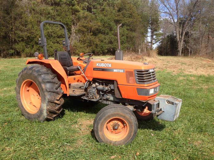

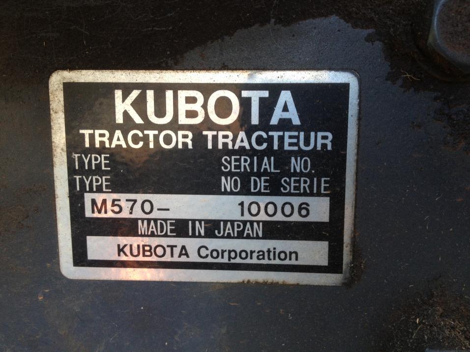

I am the new owner of a M5700 (SN: 10006). I don't even know what model year it is, but I hope to get a loader and maybe even a backhoe for it, some time early next year perhaps. Are such attachments (and associated hydraulics) still made for this tractor?

That model was made 2001-2005 and based on your serial # it's most likely a 2001, but year is not all that important, model is.

Loader and back hoe are a complicated matter
Looking at the picture is it a 2wd and not a 4wd? you might have a tough time even finding loader brackets that will fit it, it took a LA1001 and LA1002 loader in the 4wd and not sure if they ever offered a loader on the 2wd model.
You could always go aftermarket for the FEL through Woods, Westendorf, or others
For the Backhoe I would go Woods, go with a 4 point or sub frame model and not a 3 point model, much stronger.
