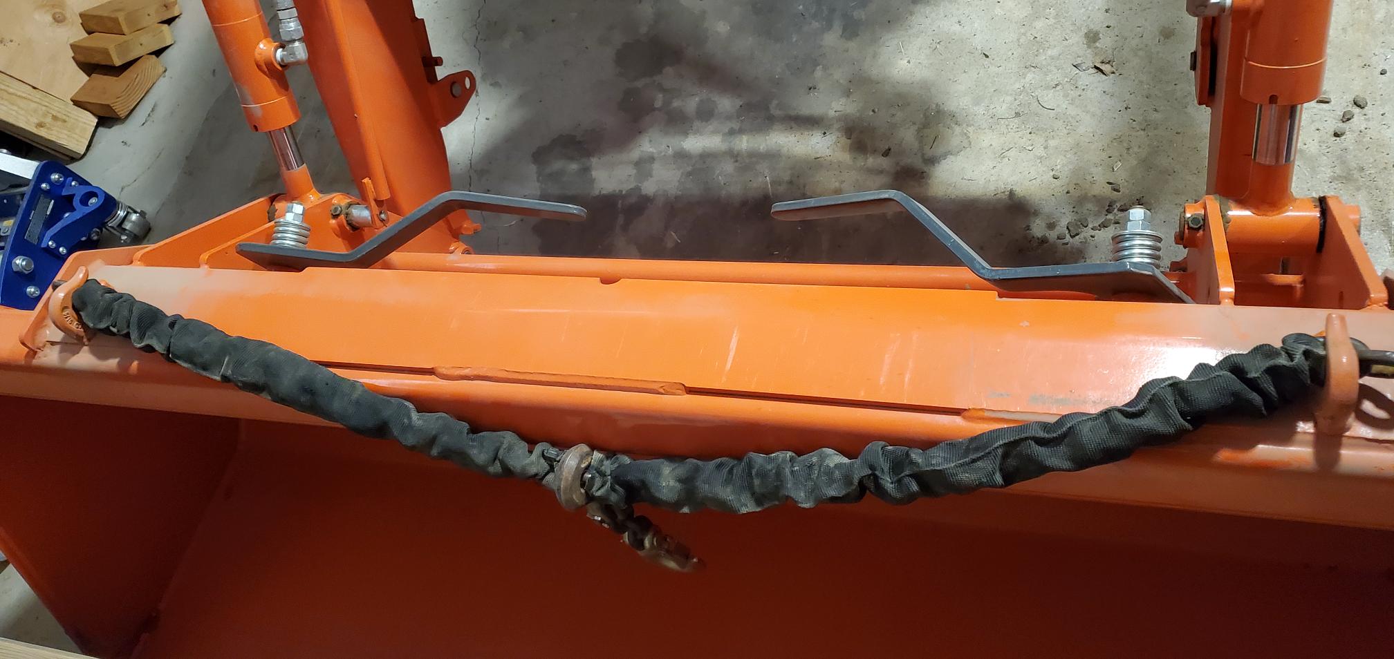

I use a short piece about 44 inches (bridle) to go between my bucket hooks that are inline with the cylinders. I covered that bridle with tubular nylon with a gap in the center and zip tied them in place to keep from causing unnecessary paint damage to my bucket.
I use a couple of chain links between a regular hook that attaches to the “bridle” and a slip hook to attach straps etc. A slip hook will slip since they are designed to do that which could unevenly load the cylinders. If I want to use chain, I attach the regular type hook to my bridle.

Jim I am a visual guy. Can you post a picture. I am contemplating putting something on the bucket. One hook in center, one on each end or loops in the bucket. Not sure yet.

I hope this is an ok picture. I probably could have made it a little longer to leave more room for the hook, but it works great.
Obviously, it is easily removable since it’s only links in the hooks. I thought of this approach to avoid a center hook since I heard about buckets being bent from the pressure at a center hook.

Thanks Jim. I like that set up. Hope you don’t mind if I copy it. Did you weld your hooks or bolt on?

With the chain that short, you will have considerable tension pulling the hooks towards each other.

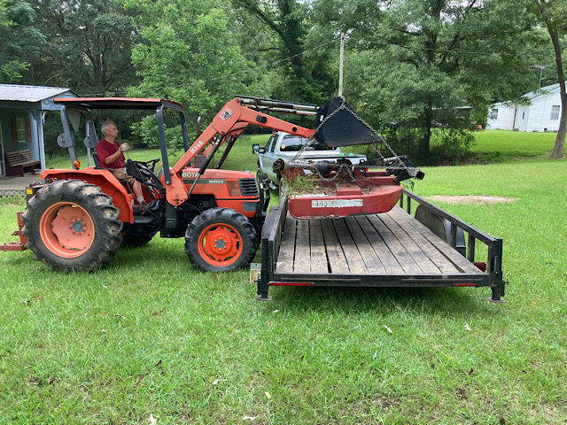

I continue to be well pleased with my decision to attach my hooks to the side of the bucket with a couple of links of Grade70 chain and Grade 8 bolts. It gives the hooks the ability to swivel when necessary.
This was yesterday loading my Bushhog on my trailer for repairs. (The rear wheels had been removed)
The hooks on the side keeps the bucket out of the way.

Always a trade-off. Longer chains give you less potential lift height.

I’m thinking that using a chain as a “bridle” will expose the bridle-chain to considerably more stress than it would in simple tension. If/When it snaps it may “sling” violently releasing links as projectiles. It also places angular stress on the hooks…not their strongest position…and can rip the welds more easily than straight pulls.
To prevent bending the bucket with a center-clevis or center-hook, a reinforcement angle or plate should be welded (or bolted as a second choice) along the top of the bucket-lip behind the rolled edge. Placing the clevis or hook onto the plate by welding will thoroughly strengthen the entire assembly.
I’m not an engineer but this idea of a short chain as a bridle should be carefully re-evaluated, IMO.
