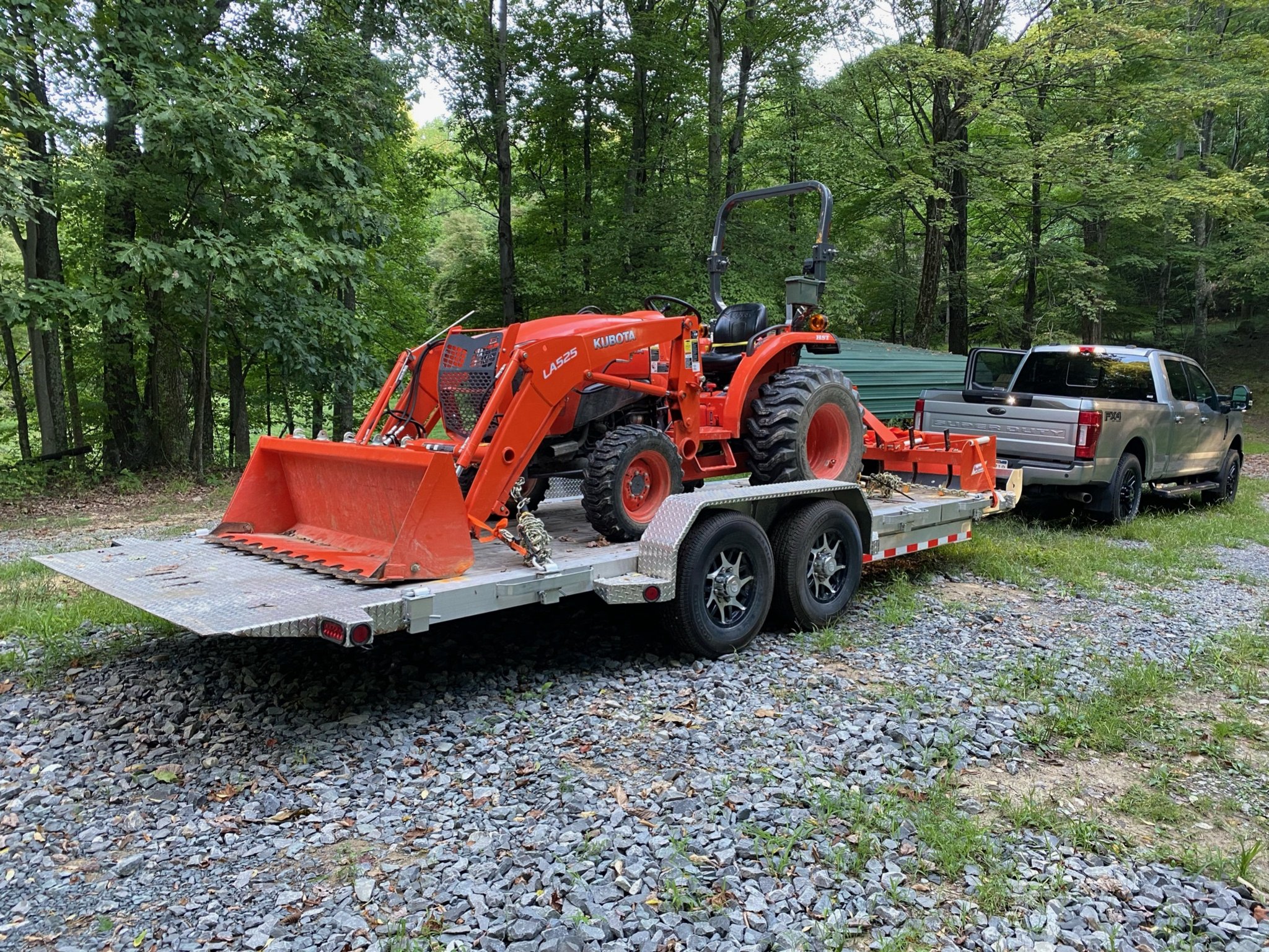

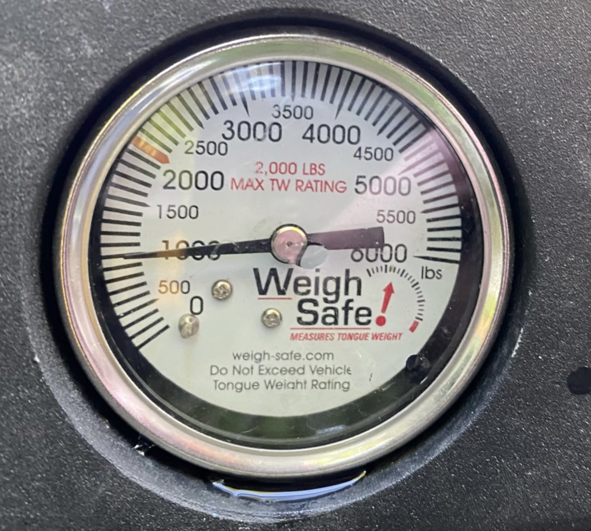

Can measure the before and after of the wheel well heights above the tires to check for squat, and can also get a hitch with a tongue-weight scale built-in—somewhat pricey but worth it if you have a lot of combinations and trailering to do.
This was on a trailer and l3301 with a box blade and FEL, totaling 8000#

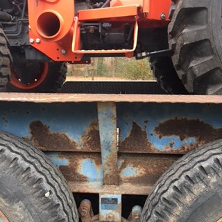

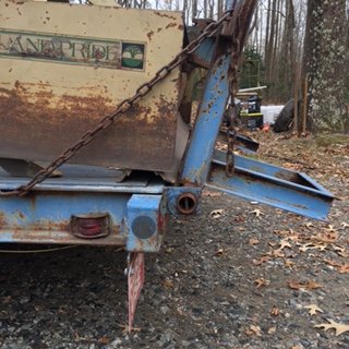

I ran into a hitch on trying to determine the best spot on the trailer to load to when I tried to secure my ramps with the finish mower hooked up. The ramps come in contact with the mower right on the grease fittings for the casters so no choice but to move it forward and run a little hitch heavy. Guess I'll be welding pins on for rigid bars to the ramps to secure them straight up and toss the old chains, then it'll be back to working out my load positions. I figure I can dangle a small marker chain from each tractor and reference line the trailer. I probably sound too uptight about proper trailer loading but I have seen way too many trailer wrecks and all were because improper balance and trailer braking problems. I also know that I am running total towed loads at close to 100% rated on occasion.

Great pics. I went cheap on the trailer but having seen your trailer I may keep my eye out for a tilt, my Hudson is an old style flat bed equipment with the drop down ramps. I new I was lifting the truck some when loading but I guess I had the tractor in four wheel the other times, this last time I lift the rear of the truck enough going up the ramps I also pushed it and had to back down put the truck and the tractor in four wheel to load up. I looked up the weigh safe hitch and liked what I saw. I think it will be worth it since I'm currently towing three different trailers (dump, horse and equipment) and three different tractors I could be hauling at any given time.

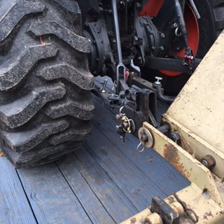

My trailer is a 16 foot and a tight squeeze also. check out the attached pics.
This set up has my tractor farther back, I used to set the bucket on the tongue.
The hitch I use now is lower and the ball is closer to the receiver.
This setup eliminated the jerking and the front axle tires getting hot.
I'll be making some mods to the trailer when I have time, like 2 years after I'm in the ground maybe sooner. The quick hitch ends added to the length but they're worth it.
