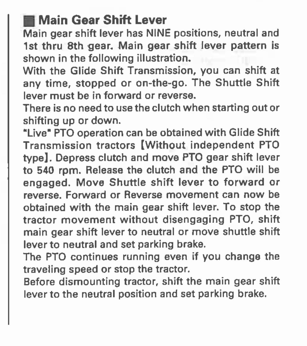

The hydraulic clutch is disengaged when the main gear select is in 'N', the shuttle is in 'N', or while shifting gears.
There's an Owners Manual at KubotaBooks, unfortunately no WSM. Here's an excerpt:
BTW, I see yours has a parking brake light on the dash. I may see if I can use any parts to add one to my L35.

L2900 GST's are considered live PTO. If you had a gear drive L2900, "independent" PTO was optional. It used a separate clutch to engage and disengage the PTO. The independent PTO was not an option on the GST-equipped machines because you can achieve an independent function of the PTO in a round-a-bout way.
29,993
6,177
Mine has the GST. Which I know means I don't need to use the normal clutch in order to shift, and you can totally feel the hydraulic clutch disengaging when you do that. But is there another way to activate the hydraulic clutch?
Just to clarify, in a GST the hydraulic clutch is for movement only, not for PTO operation.
So a GST has a live PTO because you can put the shuttle in neutral without disengaging the mechanical clutch and the PTO will still spin, and you can also engage the shuttle with the pto spinning without using the clutch.
I use mine for snow blowing and it works great to be able to vary speed and direction without ever effecting PTO speed or operation.
And FYI (for others reading), with a GST can switch between any gear at anytime without pushing in the mechanical clutch and shuttle between forward / neutral / reverse without using the mechanical clutch.
