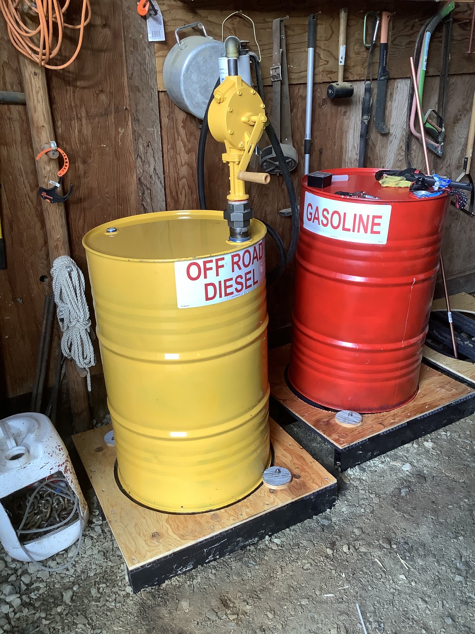

I was able to lay hands on three 55-gallon steel bung drums used for food grade contents. After securing them upside down on the FEL, I blasted them out with the power washer and let them drain completely.
With appropriate color paint and some stickers stating the contents, they were each ready for their own Fill Rite FR112 rotary pump (10 turns to the gallon) and Goldenrod water/particle filters. A pipe union at the bung lets me fill the barrels by unscrewing and removing the pump, plumbing and filters as one unit.
I placed them on plastic 30”x30” pallets from Northern Tool, and added a 3/4” plywood lip to prevent them sliding on the plastic. An over-center plywood cam holds them steady in the ring. Use the forks to load them in and out of the pickup bed.
The copper anti-static rod can be seen next to its gasoline storage barrel. It was pounded into the earth and connected with a grounding cable. Pretty cool!

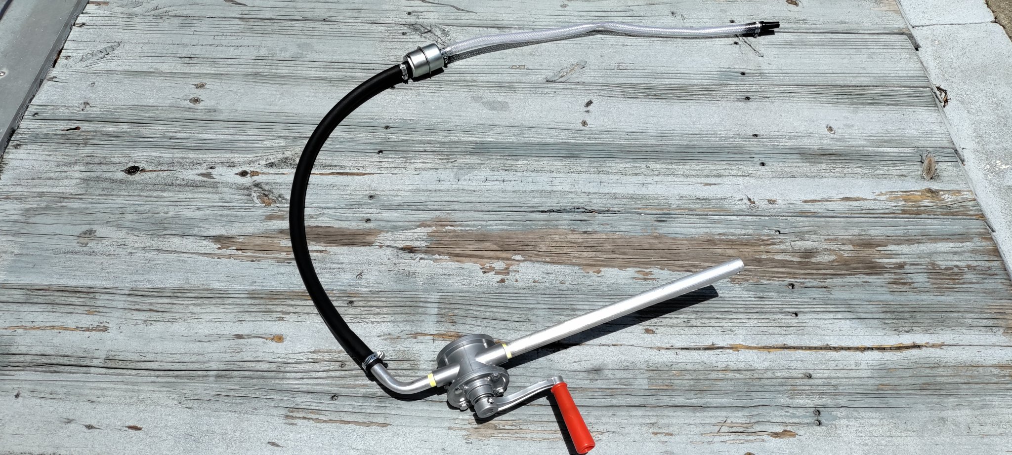

Well, still beating this dead horse with a different stick, I bought a metal crank pump from Amazon for about $24 that had mixed reviews. It has some manufacturing issues like the threads on the pipes are rough and it did seem to be dirty from the manufacturing process. So, to fix those issues, I bought a 1/2 in. inline filter and some Gasoila brand sealing yellow tape for the threads. I also added 2ft. of 1/2in. ID hose and clamps to make it easier to use. To my surprise, it did not leak anywhere and the flow rate was about the same as with the battery operated pumps (when they work) with a moderate amount of cranking. The only potential issue is with the suction pipe being on the short side, so on a 5 gallon, it will reach the bottom almost vertically so that the crank clears the side of the can. Probably, a short piece of hose might alleviate that issue.
ahddib
L2501, 5' bushhog, FEL w/ bucket and Grapple, and post hole digger.
Jun 7, 2022
Alabama
That's beautiful. I wonder if you could easily modify the crank to accept a drill attachment to spin it with a cordless drill. I have shoulder problems so even spinning that for a minute would end up a painful experience.

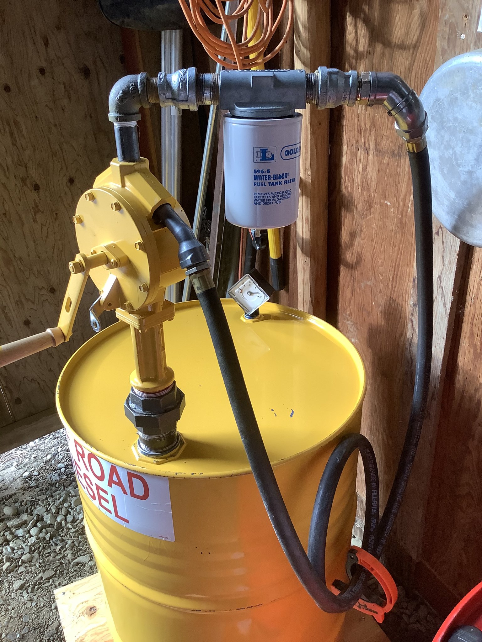

As long as we are still beating this poor bastard. . .
In another thread I showed what I did with a 55gal drum. It was used for some type of food transport but had a big sealed plastic bag inside holding the material so the drum was spotless. $30 with lid and clamp.
I found an inexpensive 12v diesel pump kit on Amazon. Add in a fill cap, vent cap and a rolling drum base (if you want) and you are done. I'm pretty sure I have <$200 in it.
That's a nice setup!
What brand fuel gauge is that? Where did you source it?
