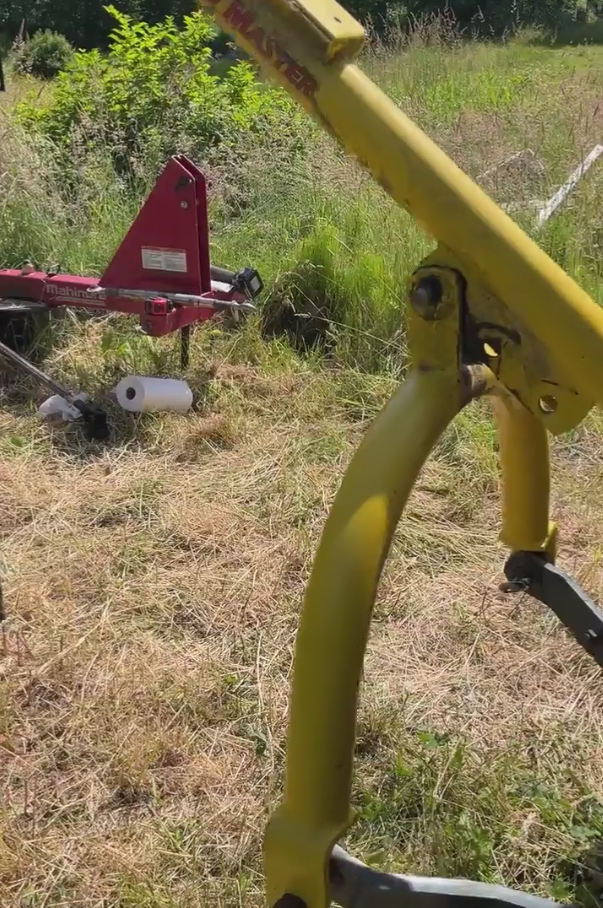

Lift arms on 2350DT stuttering with auger attachment

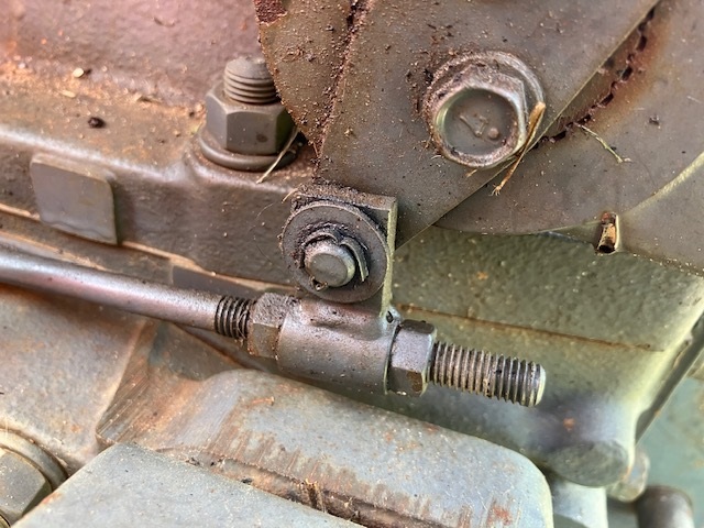

My suggestion has nothing to do with imbalance. I also think you are barking up the wrong tree with the position control rod. If you are deadset on messing with it do as the Wolfman says. Adjust per the WSM else you will be creatimg a new problem.
I'm thinking Dan may be correct. Hard to tell from the picture angle provided, but the adjustment on mine (same tractor) has never been changed and it doesn't appear to be markedly different than the OP's.

I was wondering about the lift geometry as well but it only happens with the PHD and from what I can see everything is free to move; there does not seem to be any binding in the PHD or its connections to the tractor and the PHD yoke is perpendicular to the lift arms.
"Curioser and curioser" as Alice said.
Ir works fine with other three point implements so its seemingly specific to the PHD geometry.
See what happens if you disconnect the top attachment point and use a loop of chain or rope to hold it up.
Do you mean where the PHD tube attaches to the bracket on the tractor above the PTO? Will do.
(If this IS the problem, it's going to be very interesting indeed to come up with a workaround!)
The "geometry" thing is sounding more and more plausible, although I don't recall the problem with my old tractor, but I haven't used it for several years so it may have done so to a lesser extent.

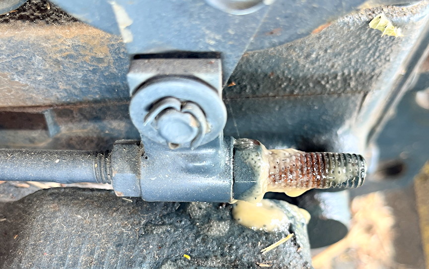

@Flintknapper: That does look about the same as mine.

Does this shudder make the implement unusable or is it just a nusiance?

Yeah, looks like a geometry issue to me too. I would move the pin to the middle hole in the bracket if you have enough range of motion to get the auger out of the ground. You don't need the auger to be 12" above the dirt in order to use it.
10,069
5,378
Yeah, looks like a geometry issue to me too. I would move the pin to the middle hole on the bracket if you have enough range of motion to get the auger out of the ground. You don't need the auger to be 12" above the dirt in order to use it.
I woulð have alreafy tried all three 👿
6,616
8,811
Me too! 😂
Well,. it doesn't make it unusable, but it is worrying. (Damage?)
- I've already tried moving the yoke to the middle hole. No diff.
- Purchasing a new PHD ain't gonna happen, given that I haven't used mine for several years and have no demand for one now aside from a couple of holes for a neighbour's new gate.
As to suspending the rear attachment point to chain as an experiment, that's going to be difficult since I put a sheet metal canopy on it and can't put anything over the ROPS now. I'd also have to re move the auger so it doesn 't bottom out when the other end is raised. (Minor problem, though.)

Did you try the hole nearest to the rear of the tractor as well?
Your lower lift arms appear to move up and down as smooth as can be, and if you removed the yoke, or at least unpinned it, the PHD would move up and down in a smooth manner too, since it's rotating freely around the pin on the rear of the tractor. So it's only when you pin the yoke to the upper arm (or whatever you call it) that the problem occurs. So it's back to a geometry issue and binding.

Boy you like to make things harder than needed.
Unpin the boom om the PHD. run a 18" long piece of rope through the pinhole and tie into a loop. Pin the loop to the top link bracket on the tractor.
Removing the boom link at the bracket from the equation and letting the end of the boom "float" (constrained only by the rope) should tell us something about whether the geometry. is an issue. I'll have to remove the auger as well because it will ground when the tractor end of the boom is raised but that's not a big deal.
Of course, if the problem doesn't reappear with the rear end detached - ie really a geometry problem- it'll make for some very tricky McGyvering to rig up a solution for when I actually need to use it. But I'll worry about that when I get there.

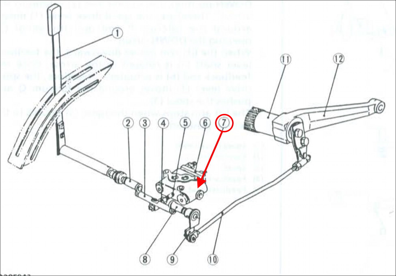

Had another "rassle" with this today, but no joy :( I looked through the "3-point shudder" links and they gave me some ideas of things to check.
First thing today was to see if I could physically lift the PHD when attached normally (ie bracket and lift arms.) Not being the 220-lb. linebacker I never was nor related to Arnie S, this was a challenge but I figured if I removed the auger and if necessary the gearbox I might be able to do it. Got the auger removed but not the gearbox as I didn't have the PHD suspended again after initially checking that the problem was still extant; couldn't hold it properly to knock the pin out. Nonetheless I was just able to ascertain that the PHD would lift without obvious binding.
Then tried detatching the boom where it is pinned to the bracket and holding it loosely with some NMD14 wire as I couldn't find any suitable rope. Unfortunately the jerking when lifting recurred, so I am fairly sure that geometry isn't the issue.
I did check the movement of the FB rod as well as the connection opposite the Position control lever to be sure the roll pin was intact etc. and everything seemed normal.
I then rermoved the PHD entirely and checked the lift vs the movement of the Position Control Lever. When I just push the PCL back in one movement, the lift arms rise smoothly., as in the video I linked earlier. But when I push it back incrementally, ie to see where the lift action begins, it does seem to lift in stages, although smoothly. (???)
That is how position control works. When you move the PCL up to an intermediate position the lift arms raise to match that position and stop. Move it a little higher or lower the arms move accordingly and stop at the newly selected height.
If the hydraulic cylinder starts to leak down the feedback rod/linkage automagically commands lift from the control valve without moving the PCL . That moves he lift arms back to the selected height and then the valve automagically returns to neutral.
Your valve appears to be behaving normally in that regard.
According to you it works smoothly with everything EXCEPT the PHD and the PHD is not binding. That makes zero sense.
