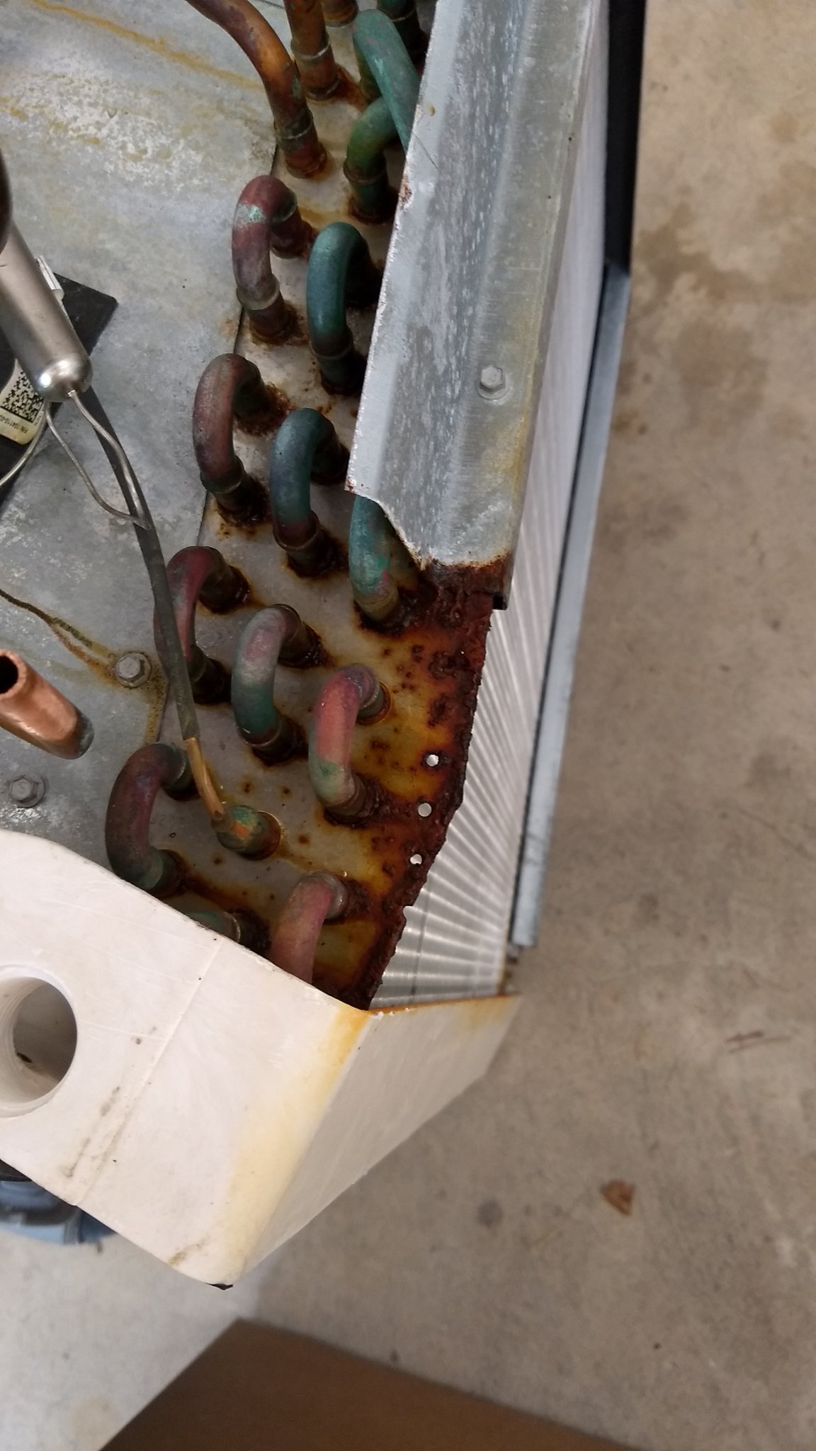

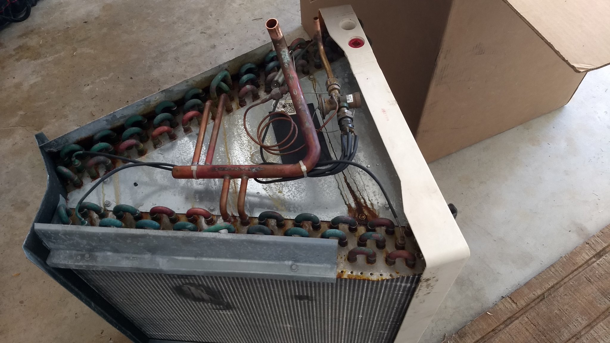

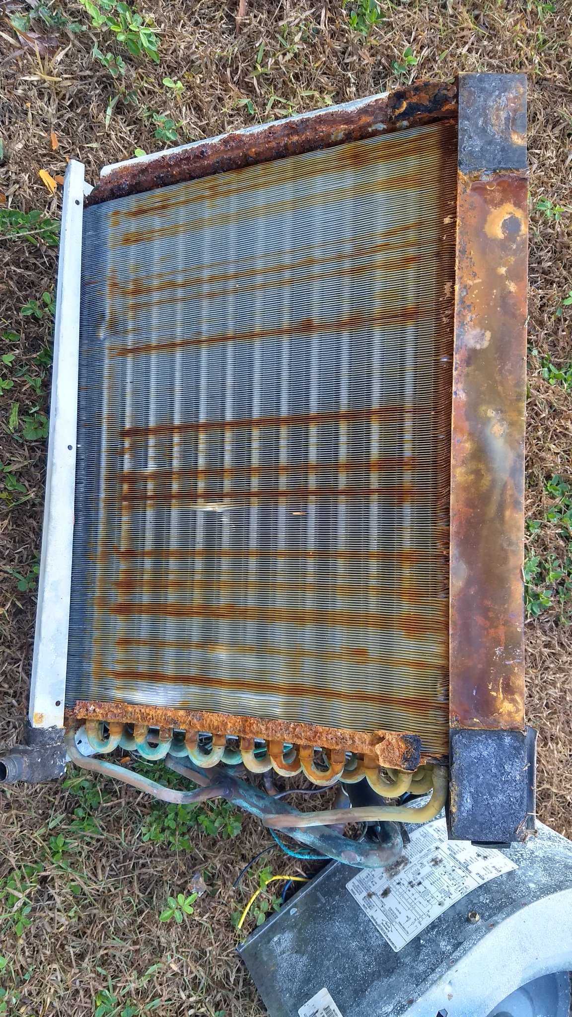

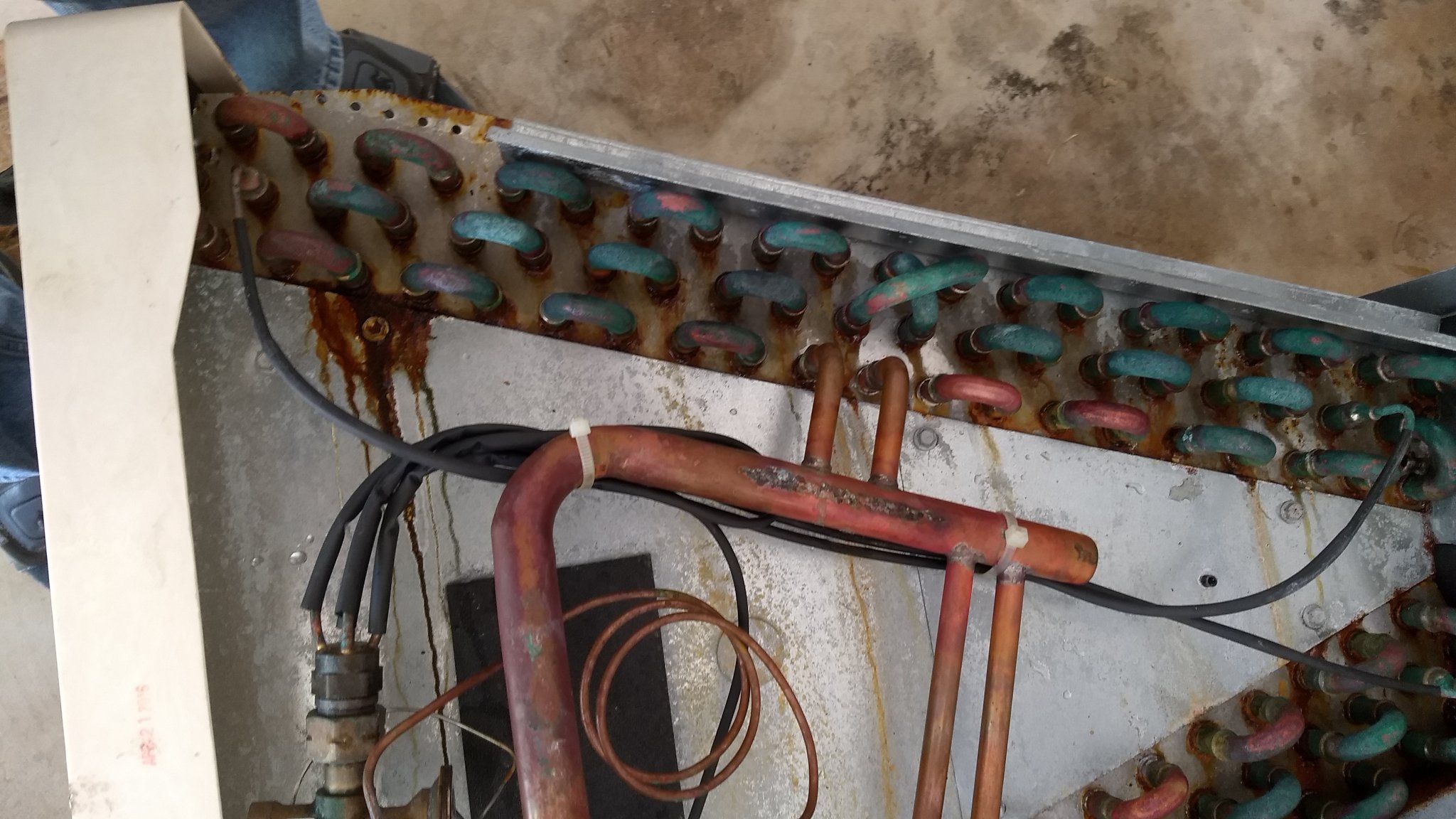

Be aware that every brand has issues with the coils:
But I am having problems with everything with the Lennox. Only the compressor and the condenser coil (and maybe a control board) are still original since 2016.
The corrosion is everywhere this is a three year old Lennox coil:
View attachment 87602 View attachment 87603 View attachment 87604 View attachment 87605
So spin the roulette, try your luck and pick a brand that is not Lennox if you need a new unit.
This is a 15 year old Bryant coil that was not leaking.

Have the new system coils Phenolic coated by who ever does the install for your environment , high RH and salt air not a good mix.

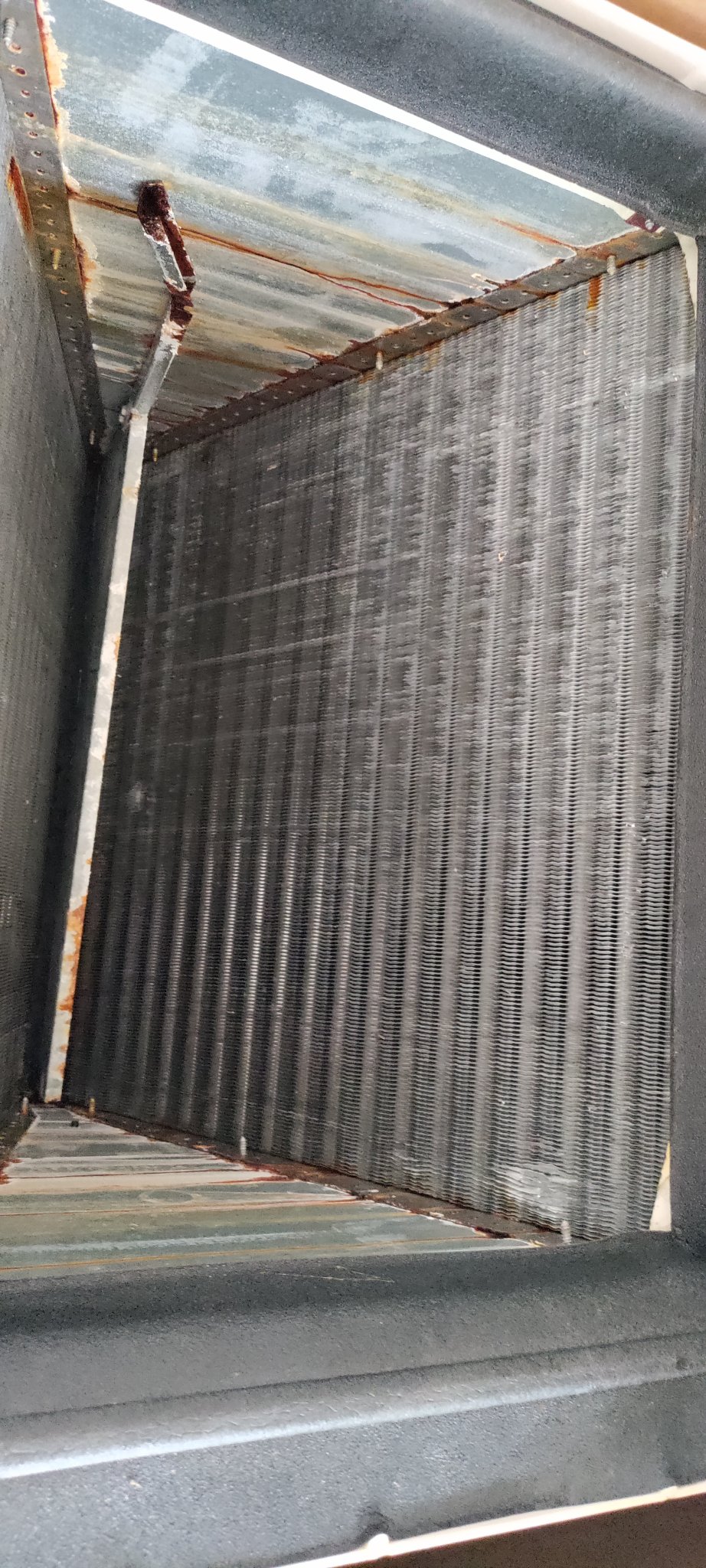

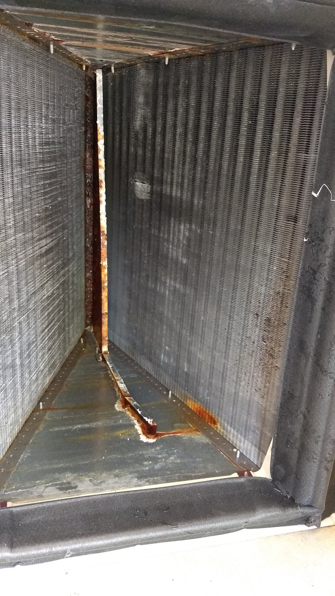

Well, out of the blue the dealer showed up with the evaporator coil and it is installed. Even under warranty they charged me $993 for refrigerant only. Now, lets see what will break next.
Three year old coil:
New one:
