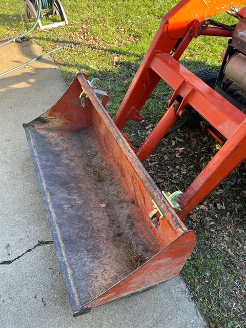

I installed a couple of hooks on the bucket of my BX in the fall.
I recently purchased 25’ of bill chain and some hooks. What lengths do you recommend I make for use with my bucket hooks. I think 25’ would be too long. I was thinking maybe a 15’ one and a 10’ one.
Thanks

My chains are all 25’. You just hook what you need for the job, but you have full length chains for tie downs for towing.

I''m sure a 25 foot chain would work. What you're doing at the time dictates what's a reasonable length. I have a couple chains. I think they're about fifteen feet each. I generally only need one though and as suggested the excess can just lay in my bucket. Even at that length one is usually long enough to attach to both hooks on my bucket.

Smaller chain, less weight, more length. You're only gonna pick up so much with that BX2200. Even with the hydraulics turned up, just because your FEL can take the strain, does NOT mean you should be putting that kind of strain on those turf tires. 1/4" chain will likely do most of what you want to do with that small machine. I use a 25-foot 5/16" chain with my LX2610, which is a lot larger/heavier than your BX2200, and that's more than sufficient for most of what I do with it, including pulling some rather large stumps on occasion. Another option is to add a third grab hook and d-ring aligned with the cylinder (centered). Then, you can use the chain you have at full length since you don't have to double it to avoid torsional stresses on your FEL. Consider swapping at least one of those hooks on the chain to grab hooks so that you can use the chain without cinching, i.e. a fixed loop size. I'd also consider open hooks like that with the safety latches. That keeps them from falling off which is not only inconvenient but can also be very dangerous to the tractor and you. Those are good hooks, but the safety latches make them better.
Keep your larger chain for tying down the tractor on your trailer. It's an inertia thing. A tractor going 60 MPH on a trailer has a lot more kinetic energy than one going 6 MPH on its own feet. You want the tractor to essentially become a part of the trailer, and not come to visit you in the cab of your truck. But for general pulling and lifting, a 5/16" chain will be plenty for anything your BX2200 is capable of.

I have a 5 gallon bucket full of mostly 3/8" chains that have hooks on both ends. When tossing them in the bucket the two hooks are hooked on the rim of the bucket next to each other. Want a chain? Grab a pair of hooks and go.
In recent years I've added some 1/4" Grade 70 chains to the collection. A single GR70 WLL is rated at 1.5X the loader capacity. A few now have logging hooks on one end. Much nicer than regular slip hooks.
I've been running slotted angle for about 20 years on the different tractors and like the versatility. You can pick from the front or rear of the bucket. Extra chain can be dropped into empty slots to keep it out of the way.

These are the hooks I got with my 5/16 chain. I also have a set of AG tires/rims for it in the garage I still need to put on. Figure those will be better for moving snow in the winter.

I am not really sure what you are doing with the loader / chains but for just lifting, I think straps are my preference for the loader when it is something my forks can’t hold properly…I keep two sizes, a pair 3 ft long each and a pair 6ft long each. That seems to be the right combo for lifting up for both my tractors. Neither really can lift anything very high so there is no need for something longer. If I am using a chain it is more for pulling a log…and in that case I want the log as close to the tractor as possible and I am only really using the log to pull out to where I can get closer or to simply attach to 3 pt and then lift / pull with 3PT. Generally with a log chain keep it close to the machine. I think depends on how/what you are comfortable with.

It is for lifting. Also for securing larger/awkward items in the bucket so I can curl it etc without them falling out.
