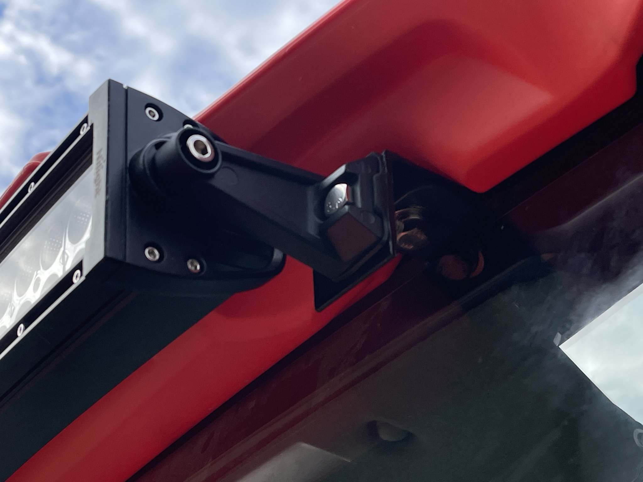

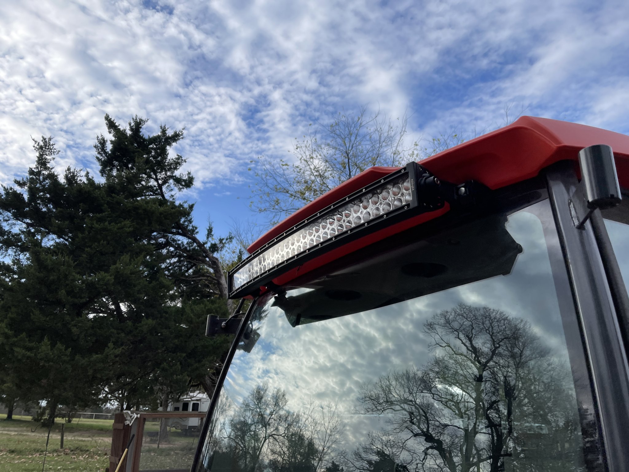

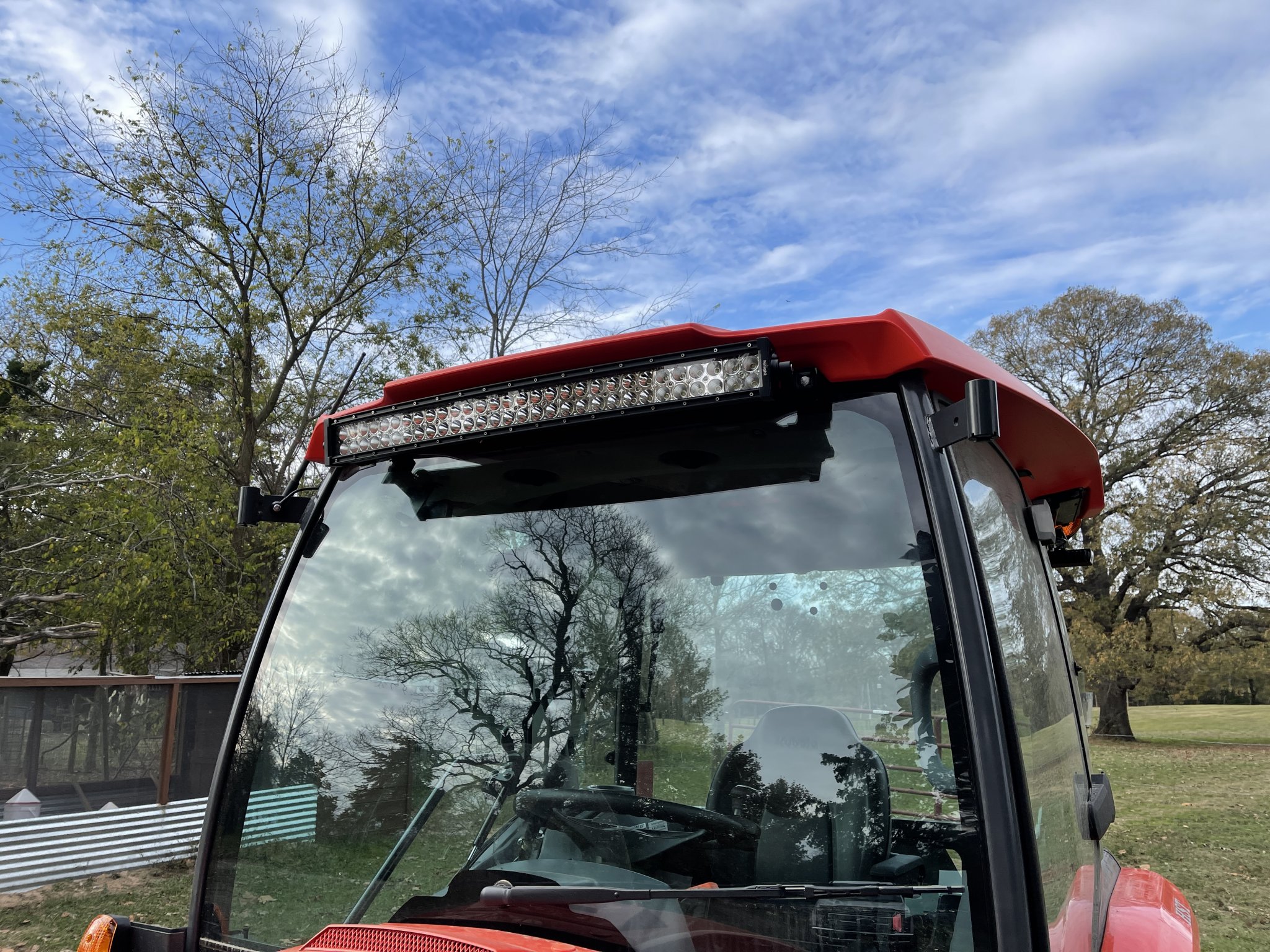

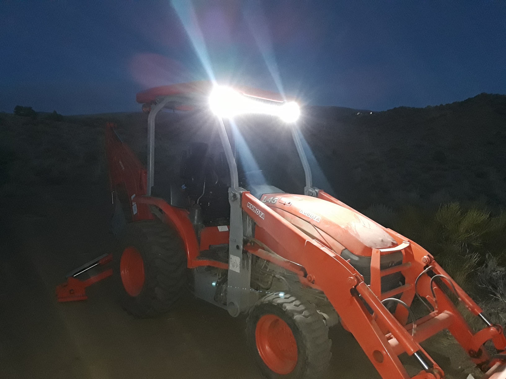

I added a light bar to my L45 and could not be happier. Used existing holes and wiring.

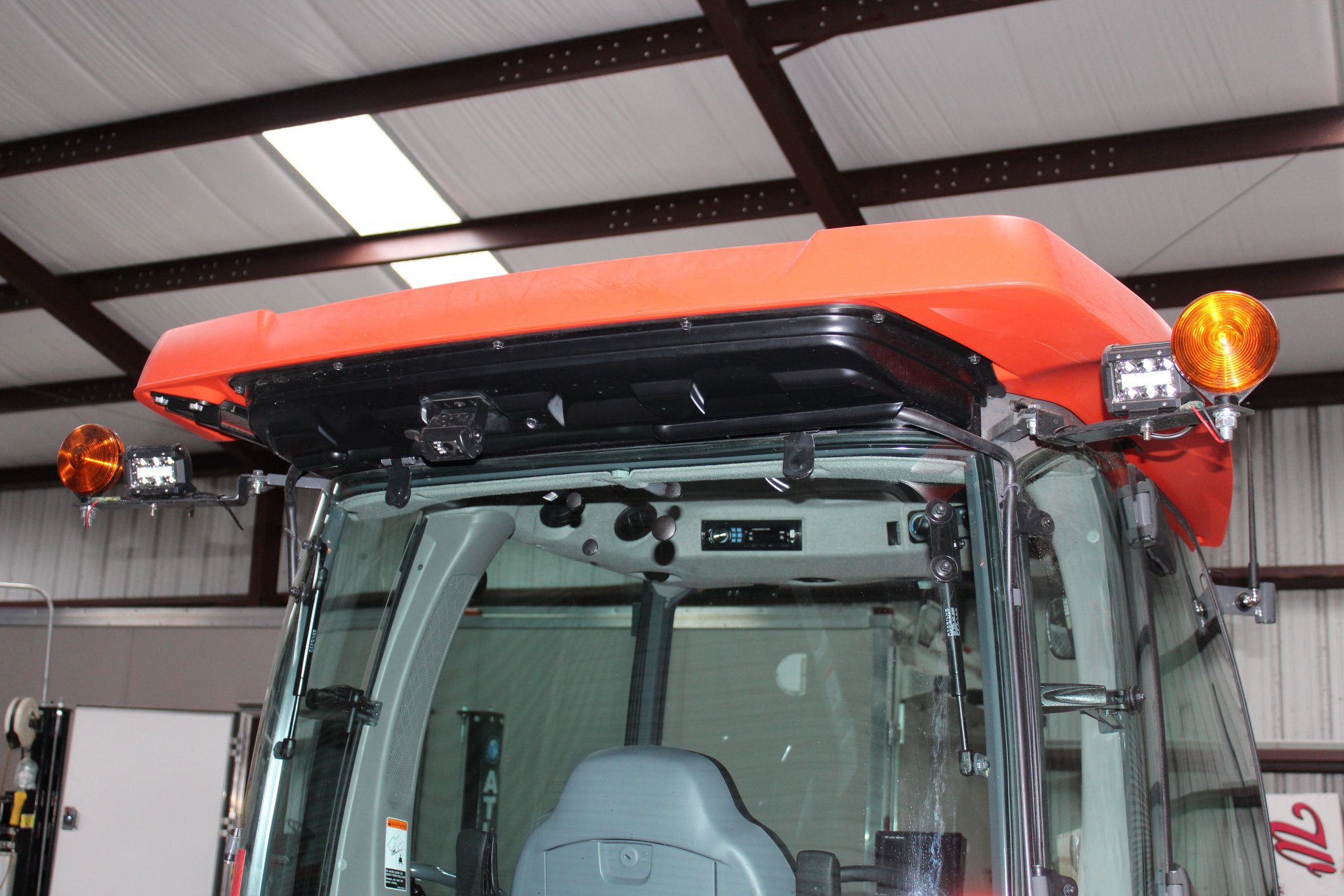

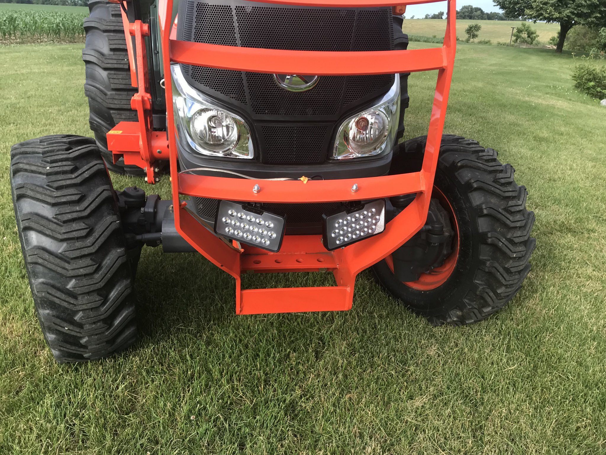

I've tried various types of lighting over the years. Started before LED's came out. The current setup uses Maxxima floods as replacements for the 4 cab-mounted lights, 2 more in the grille guard and a couple small cubes mounted inside the tubes of the FEL frame.
The 2 forward cab lights are good for general purpose and particularly when plowing snow or using the FEL. When mowing at night, these are rarely on. The create glare from the hood that make annoying reflections in the glass. The angle of the light hitting the grass doesn't give good definition to the cut/uncut line.
For mowing at night, the two floods mounted in the grille guard work very well. The light hits the grass at a sharp angle and the cut/uncut is easy to see (much like the uneveness in vinyl siding when the sun is at the right spot.
The FEL tube-mounted side lights in combination with the others give 360 degrees of light around the tractor. They were the last to be added. Without them it felt like I was operating with blinders on.
The rear cab lights are handy whenever working at night of course.
