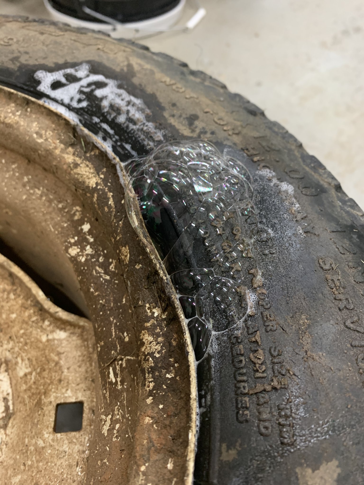

Hi, the front left tire is leaking on my kubota bx2380. The tire (R4) is a replacement for a turf tire that was on the rim before. The previous owner indicated that the turf tire wouldn’t hold air and he wasn’t sure why. Anyhow, knowing the history I’m thinking the problem is probably with the rim and not the tire. So my question: is there a “cheap” way to fix the leaking tire (tube, foam fill, tire sealant) and why would one approach be better/worse than the other?
I’d like to fix the leak but I don’t want to spend an arm and leg to get there. Right now, I'm just filling it up occassionally. Thanks for your recommendations.

First thing I'd do is get a spare spray bottle and fill it with water and a few drops of dish soap, shake it up and spray it all over your tire and INTO your valve stem(take cap off obviously). You should know right away where the leak is once/if you see bubbles. Might just be a loose valve stem, which is fixed in 5 seconds flat with a $2.00 tool. If the valve stem is NOT the problem, and you live in a cold climate use a little compressed air to get the water out of there after your test (ie: ice, later)
If it's a bent rim (for example), or giant hole, well, you'd have to refer to the experts on that.

Like @ve9aa said, fill with air and spray with soapy water. Find where it is leaking. If in tire, plug repair kit is cheap and good to have around. If rim has a bend in the bead, hammer is your friend. If it’s leaking at bead, but no bend, see if there is some trash in between bead and tire, not sealing.

The problem is the powder coating that Kubota uses. If you break the bead and rough up the powder coating, the bead will stick again. Same problem with the rear tires. I have actually seen the rim spinning and the tire not moving as a result. Laid the tire down, and replaced the rubber valve stem with a metal one, and also sanded the inside of the bead edge. Problem solved.
