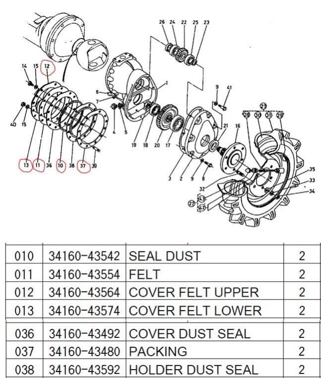

With the front wheels off I noticed a leak on the drivers side and it seems to be coming
from the axle case spindle housing. I need to do some cleaning to confirm.
After checking with the local Kubota dealer it appears that most all of the parts needed to
do this repair are discontinued!
ITEMS CIRCLED IN RED ARE DISCONTINUED
Wondering if anyone has any expertise in this area and has had to go the route of making
any of the required components to stop a leak?
It looks like a felt ring (id, od, thickness?), a dust seal (id, od, thickness, made of what?)
and a packing (gasket) are the wear items.

I know guys who use to use the black roofing felt to make gaskets like that.
If the leak is enough to make you want it fixed, you'll just have to get it apart and see what's there. If it's just a gasket and not a shim determine the thickness and go to the auto supply store and see what they have.

I think this scenario is going to be repeated more than any of us with older tractors would like.
The sad reality is that parts for these old tractors are just not going to be made, there is not enough of a call or $$ potential for it to happen.
Now as far as your repair, you will need to evaluate if a little leak is overwhelming or livable, most of these old tractors leak here and there and will for many a year with no real problems.
If you decide you must fix it, very carefully disassemble it and evaluate each part.
The wiper seals can be made out of Felt, leather, and other materials, you'll need to evaluate what is needed.
The parts you list do not seal oil that is done by part # 26 and another on the other end that comes out of the axle, the "ball" portion of the system is not a wet portion, just greased.

All of those parts are available for early B7100s, can't speak to your model. As stated, there is nothing magical about the felt, or the gasket. The seal (B7100) is a molded piece of rubber, kind of a flat flange with a raised "wiper" at the contact point with the ball. It would be hard to duplicate, but if absolutely nothing was available, I'd just try a thick rubber gasket/wiper. Better than nothing, or scrapping the tractor.
Incidentally, speaking from much past experience, when assembling this type of "ball" joint, always soak the felt in oil, (I like 140w) thoroughly saturating it before assembly. If you assemble it dry, the first time you drive through water or use it in the rain, it will absorb & trap the water, & rust the crap out of the ball surface. That will make short work out of those nice new wiper seals you just put in.

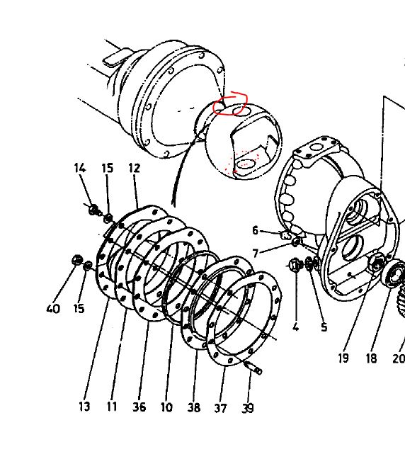

Trust me I know that, It was dry as a bone took forever to get it full of grease.
Just like my old Willys when I got it !
May be it is just the separation you get, like in a grease gun?
33,601
8,843
Ok, still interested where did the grease come out?
The reason I'm grilling you is are you sure you have a oil leak and just not overage of grease that is breaking down and leaking out?
Like I said that ball joint is a "dry" joint so too much grease could be the real issue.
This is where grease comes out when lubing, top and bottom.....
Somewhere (here) I read that this should be greased until full, I "assumed"
that was the way the u-jounts and king pins got lubed, similar to my
old Willys. On it you made a blend of greases and packed full when reassembeling.
Perhaps you are right, that is usually the case with your wealth of knowledge,
maybe I should dis-assemble and clean out?

I'm a little unsure or the exact details on the in and outs of over greasing this part.
My gut tells me that over greasing is not all that bad as it would keep moisture out.
I'll dig into this further.
10,803
8,272
I don't think I would be too concerned with grease getting in there. There are many people that will pack a bearing, then fill the cavity with what ever oil it calls for with out any negative effects..
