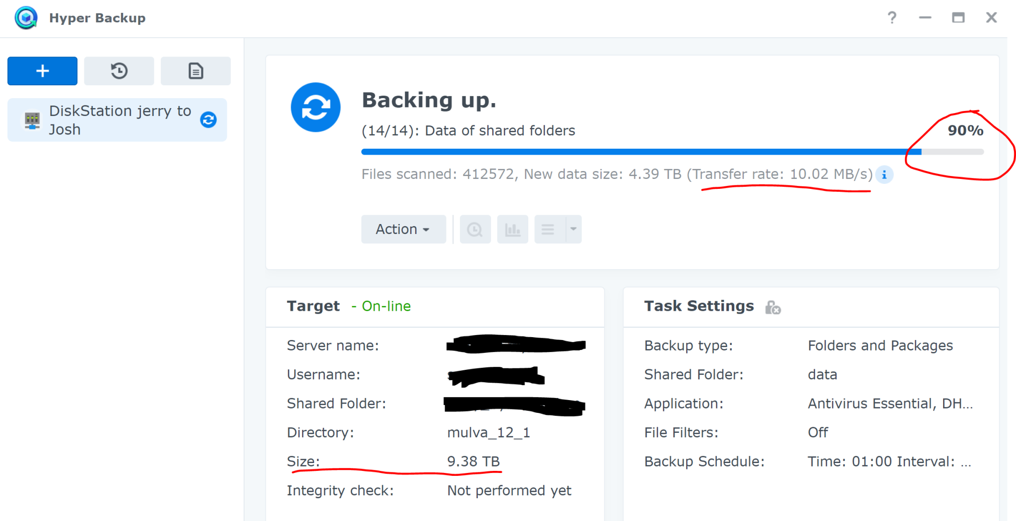

Two of my sons and I have been backing up our important data to each other's systems. One of them lives in CT, the other in MD. Until recently I have been limiting my backups to what I would call 'critically important' stuff. After a conversation with one of the boys we decided to back up all my data including 10's of thousands of high res images and a fair amount of video clips.
We all have Synology network attached storage units with virtually unlimited storage (>100TB) and the Synology backup app makes setup easy enough even for me to do.
So after running 2 full weeks I just checked it:
Looks like when its done it's going to be just over 10TB. After that, at 1 am daily, it will backup only what has changed (and keep the original).
One less thing to worry about.

While it does give you a fairly good backup, you'll find out that it will get slower and slow as the load goes up.
I've had 2 of them tank and lost everything on them, luckily, I had another alternate backup.

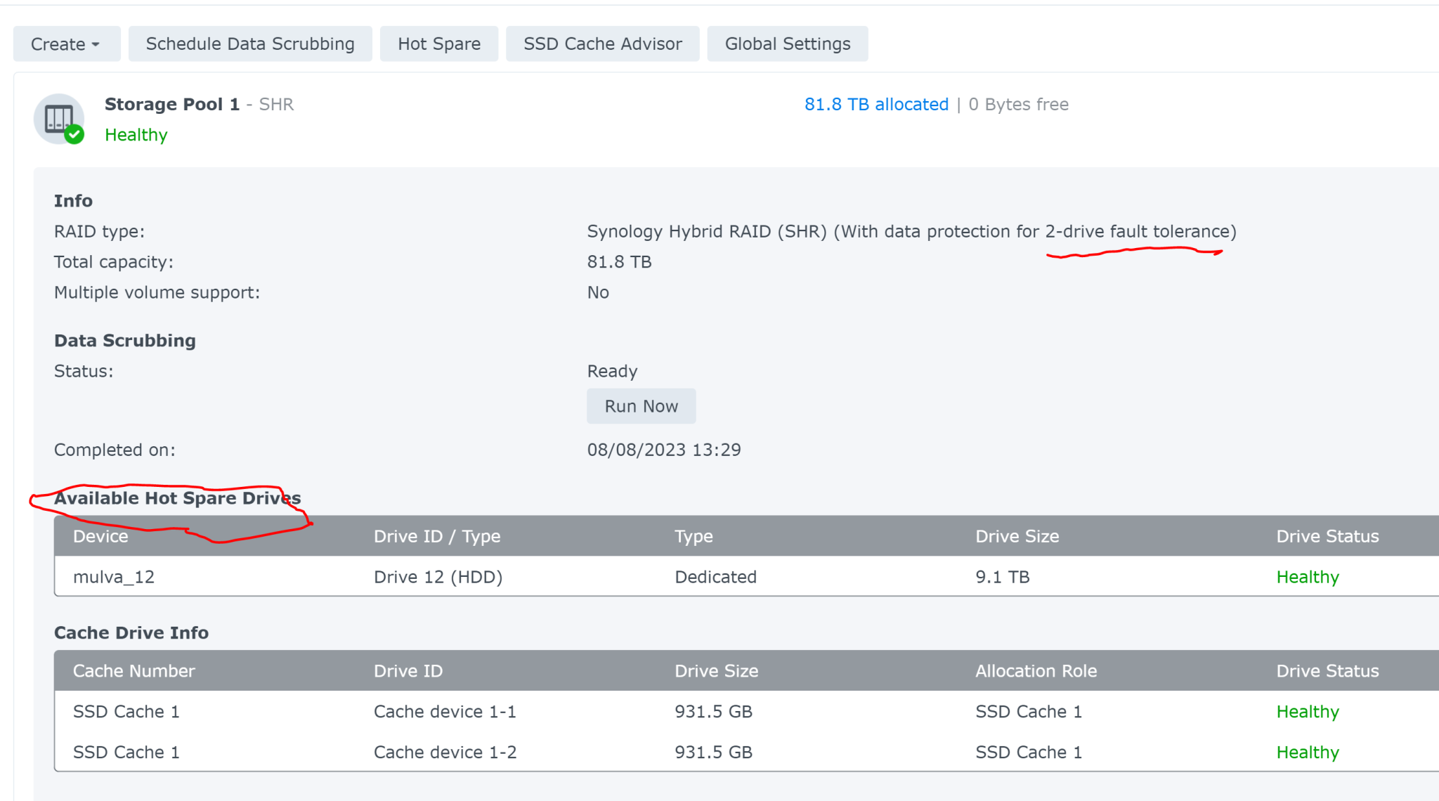

I don't know what you were using for hardware / software but I think I've taken a pretty secure method to retain my data even if (when) there are drive failures:
The RAID system I am using can recover from 2 drives failing simultaneously. It is true that the rebuild can take quite a while as the data stored grows. Small price to pay.
The speed of saving large amounts of data is only limited by my lan speed, or in the case of remote saving, the speed my internet carrier provides.
The backups going forward will just be incremental, microscopic in size compared to this 1st save,

Keep in mind that RAID can fail when the definition goes bad for any reason. In the case of any proprietary system like Synology or similar, if you loose the definition, you lose the volume-data. Years ago, I happened to lose two RAID definitions simultaneously on backup systems. I had most of the files on other drives, but it was a pain to find them all. RAID sounds good until it fails. ;)
Also, any automated system can fail or be problematic as well. Many of them don't know the difference between adding a file or removing one, so some process causes a mass deletion event, it will delete the copy from your backup as well.
