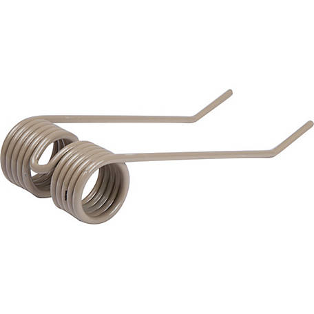

Might put an ad on FB Marketplace for parts baler. If you start from scratch you could use something like these. I replaced all my teeth a couple of years ago and I think there are 40, 10 on each bar. You need the spring large fender type washer, lock washer and nut. Be sure to stagger the spring location.
Tractor Supply, $4.09 each! Crazy prices.
