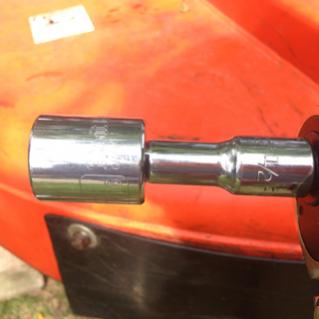

Just tightened these on my RCR 1872 with the help of a friend. All 4 bolts were loose (!)
Was able to get it done from under the deck, using a ~2' long torque wrench with a 2" extension. The wrench, extension and 15/16" socket slid right under the stump jumper and securing it on the bolts was pretty straightforward. Just needed to spin the blades a bit in order to see the nuts though the hole in the stump jumper. Friend tightened the bolts from the top. Hope this helps anyone who needs to do this procedure. When working under the deck remember to secure it with jack stands or something solid so you don't have to worry about it dropping on you.
