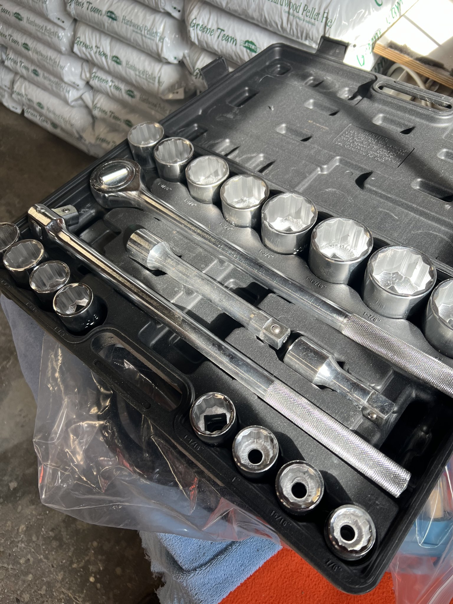

For what it's worth, this is a 3/4 drive set I got from Harbor Freight years ago.
All 12-point, so not good. 1 3/4 and 1 13/16. No 1 11/16. Does have a breaker bar and extensions.

The 1 1/8 is the internal diameter with 12 (pitch) threads per inch. (1 1/8-12). The 1 11/16 is the outer flats on the nut and are measured directly opposite from each other. See if you can rent the tools and if available use 3/4 or 1 inch drive.

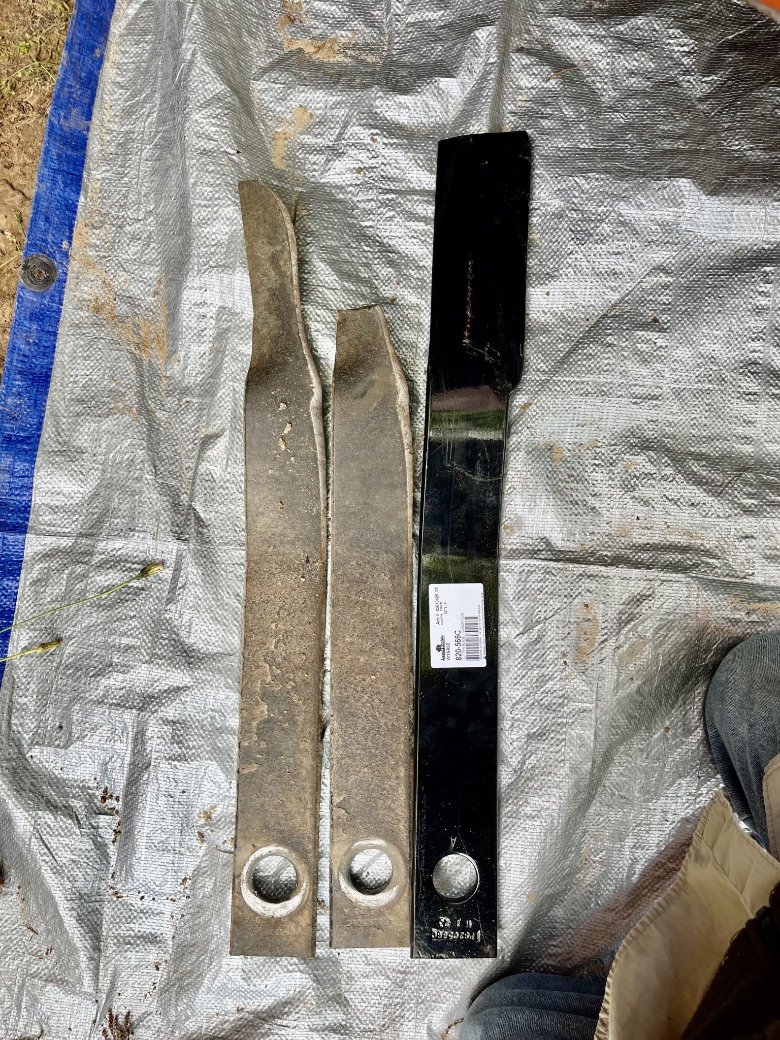

Well, I gotter done. The $120 impact wrench along with an extension and a 1 11/16 socket loosened each nut after a minute or two. Much easier than I expected. The old blades were in really bad shape and now the cutter doesn't vibrate like it did.
