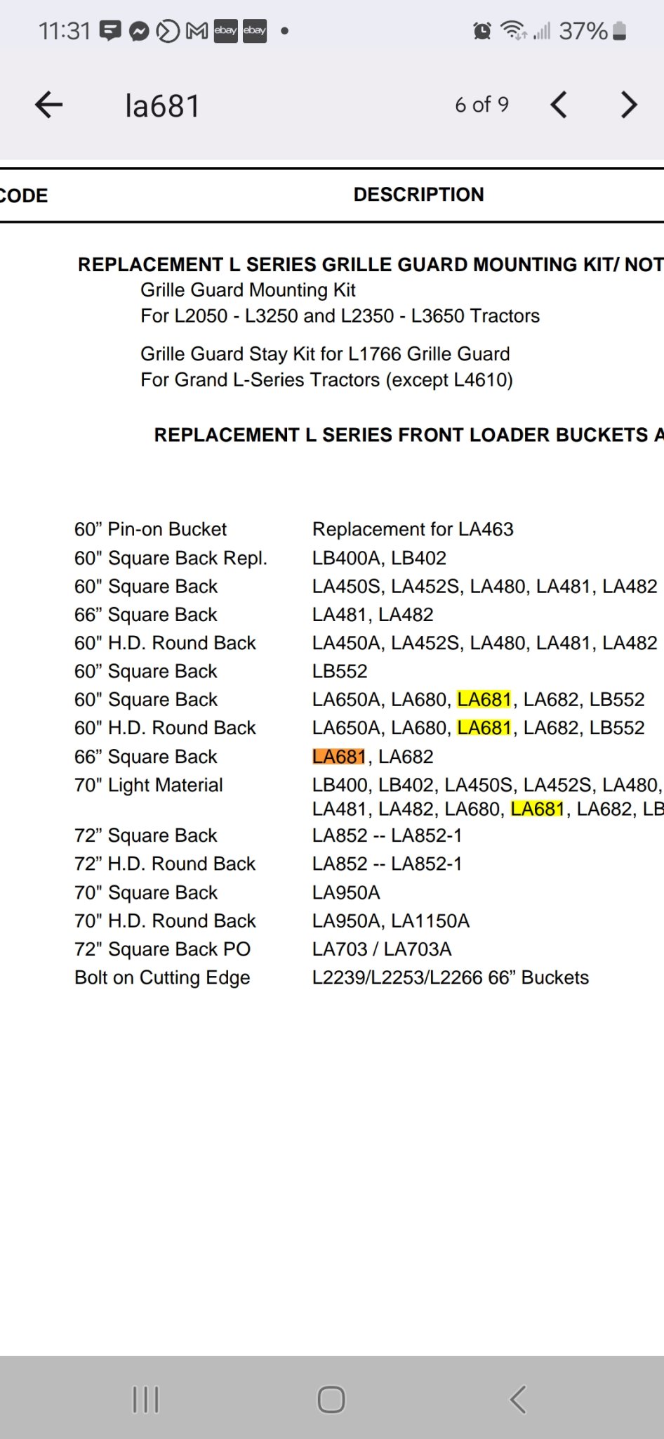

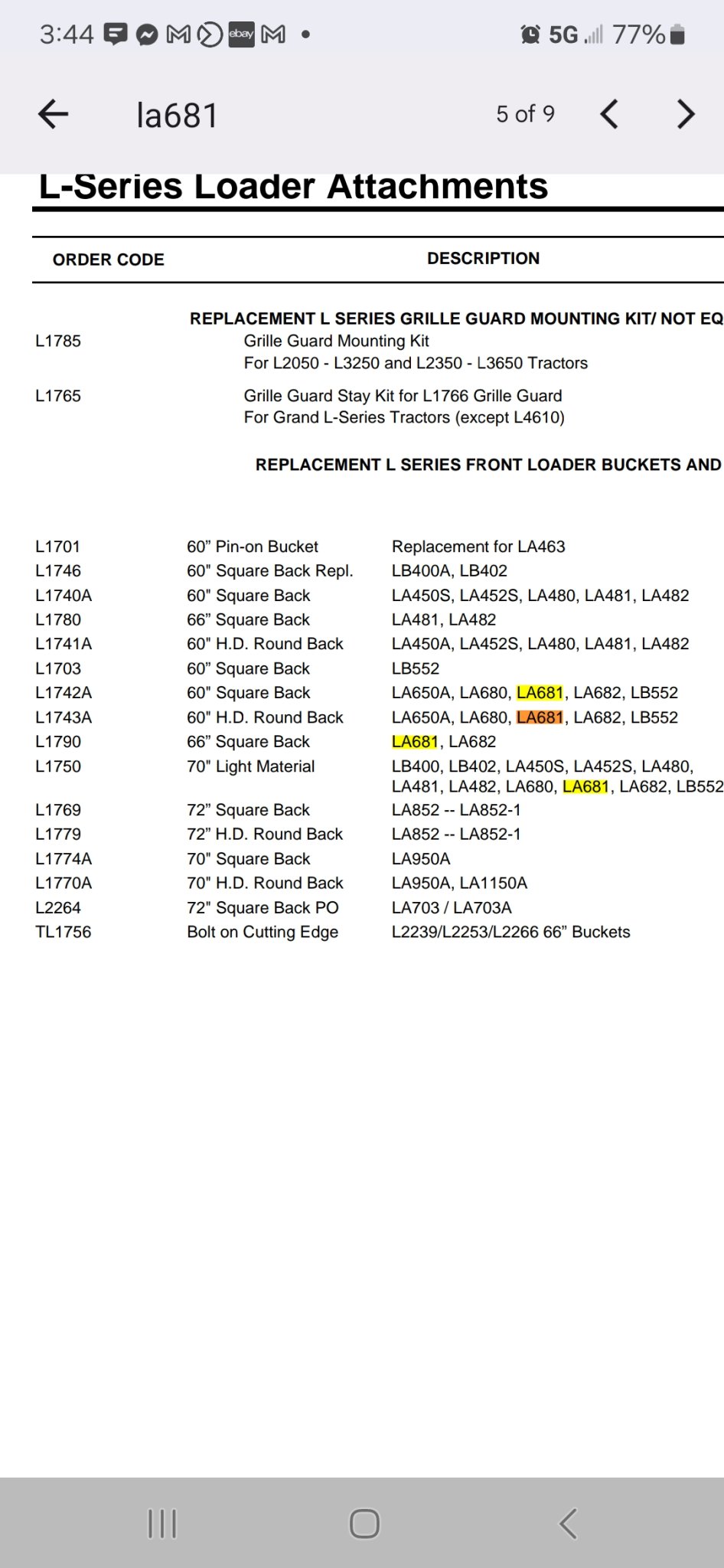

My dealer put a mismatched bucket on my L3710 and the dump angle is short of 6 o'clock.
I think the current bucket is an L1769 (hard to read) but I am trying to find the correct bucket to replace it. I've seen the L1780 in some threads, but wasn't sure what that width was and what the other model numbers were.
TIA!

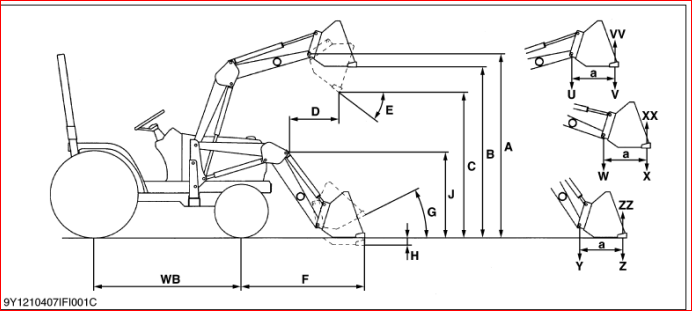

This is NOT your FEL - but you are asking to improve "E"?

An L1769 would be a 72" bucket.
Is your bucket 72" wide?
The stock bucket for the L681 is long obsolete:
P/N 75554-59010
Which was a 60" bucket.
There is a 66" option
7J260-49000 / L1790
Again this bucket is long Obsolete too.
If your happy with the bucket you have, expect the dump angle, have the mounts reworked to get you the proper roll back and dump angles.
One other way to get around issues like this is to swap over to a SSQA style quick disconnect, then there will be mutiple options of buckets available.
