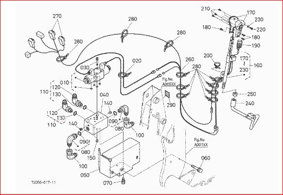

Just for your future reference you have a B2650HSD
Call one of the Wholesalers and they will set you up.

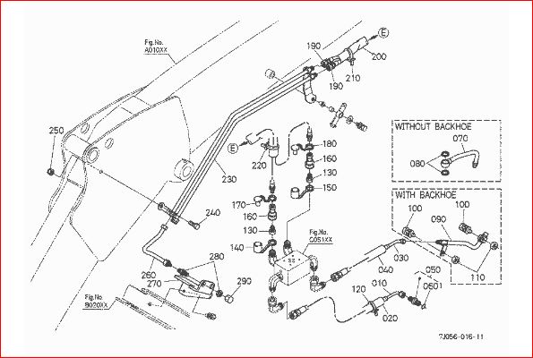

Oh and I Actually mis-spoke, the valve mounts back on the support pillar and the lines run up front to the quick connects.
Valve mounting location.
Quick connects mounting location
