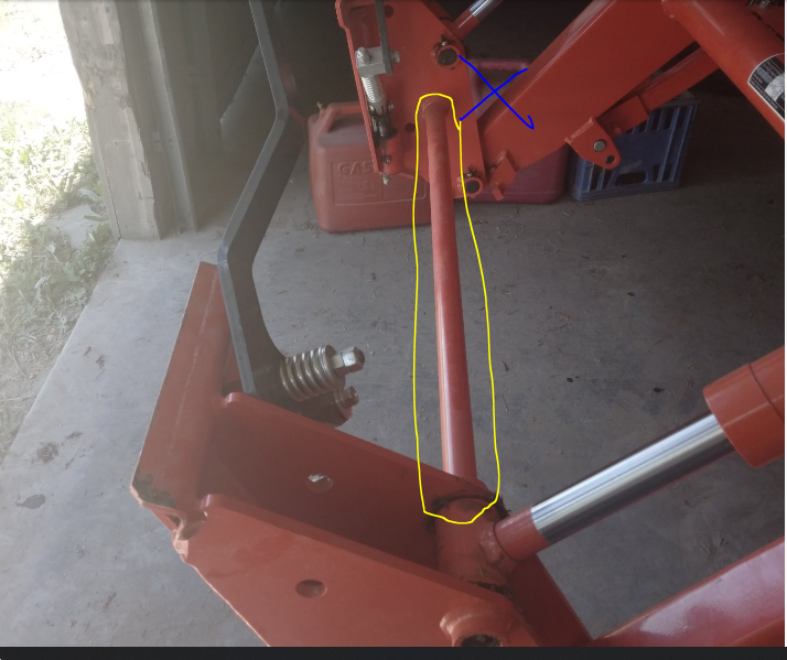

LA525 FEL on a L3901, left bucket cylinder advances more than the right bucket cylinder. Pics show it clearly. I had just finished loading 6 buckets of light hay silage ( I use it for mulch in the garden) into a wagon and noticed one side of the bucket was not secure.
Any help would be appreciated.

There are multiple posts on here about that:
It's SSQA bent or SSQA out of sync or SSQA out of alinement.
Looks like in one pic you tried to open up the hydraulic lines, not going to help.
You have twisted the tube in yellow.
To fix it take a block of wood to stop the pad that closest to the loader arms (blue x) and use the hydraulics to roll the other one back till you get it in alinement.
