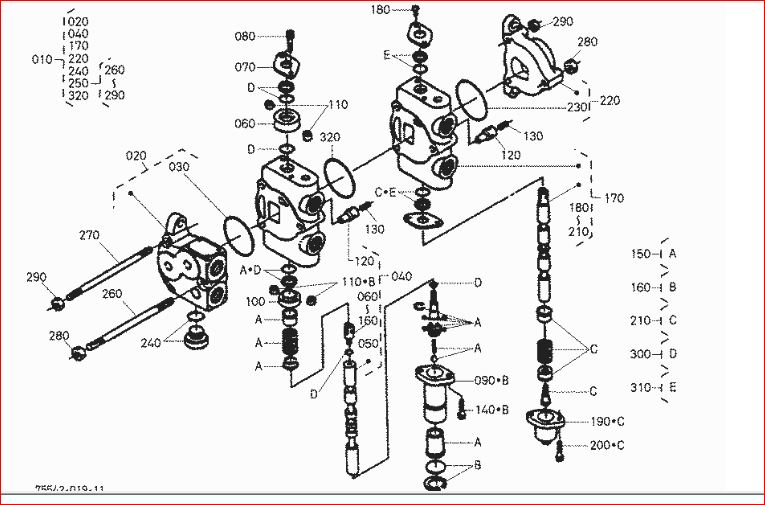

Does anybody have an exploded view of the valve. I have a tendency to think I can remember what order parts go back together. Experience has shown I'm not as good as I think I am.

While you have it apart, inspect the spools for wear as well. You can either purchase new ones or have your old ones polished and re-chromed by a good hydraulics shop. Damaged spools or housings can destroy your nice new rebuild seal kit.
