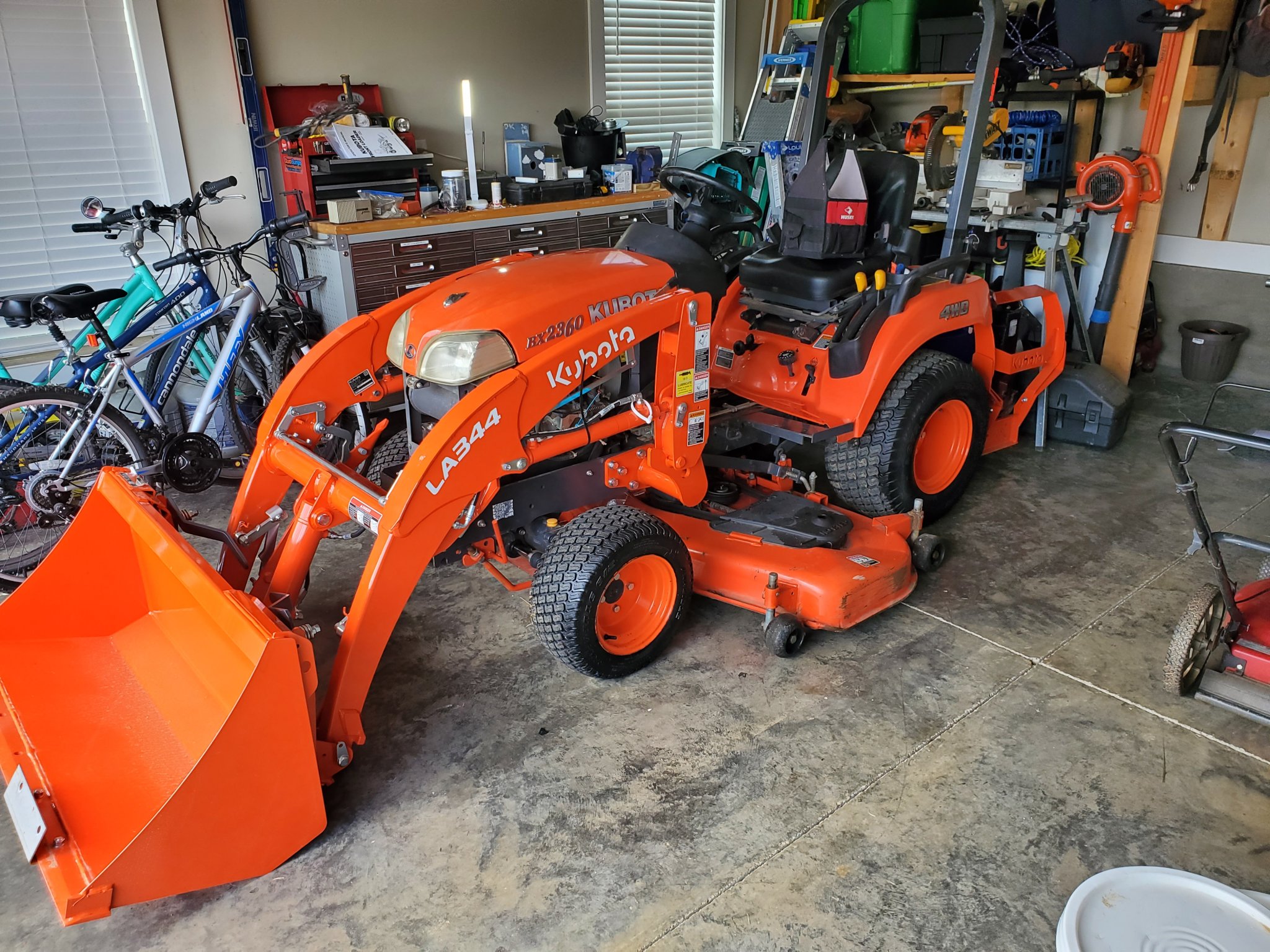

So. It bolted on perfectly. Gotta swap the quick connections. But otherwise it's perfect fit. Still gotta install brush guard.. and oh yeah 😎 kubota will finance it. !!!

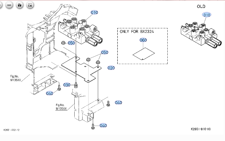

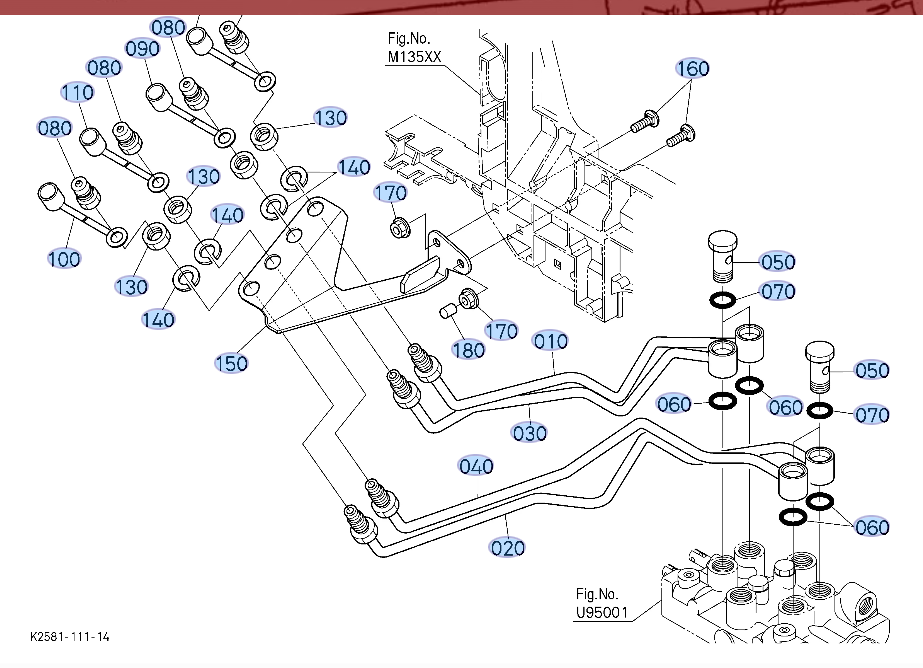

I have a 2009 BX2660 and would like to add the LA344 loader and do the installation. I've looked for more information on the forum, but couldn't find it. Anyone here, maybe derrickroy above have an idea on the parts I'll need as this model didn't come loader ready? Unsure of what comes with the 344 loader kit. Thinking I'll need these pictured below - loader valve, controller, and hydraulic pipes from the hydraulics in the back, but wanted to check with those who've done it before calling a dealer. Those below are all from the BX2660 (accessories) parts diagrams.
