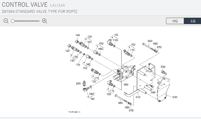

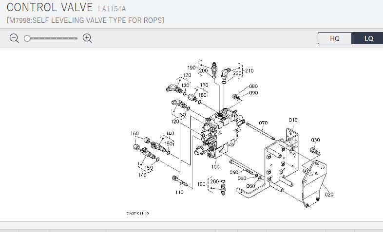

I am having trouble interpreting your description. Sort of sounds like a quick coupler or possibly a seal on one of the hose fittings. Can you identify where in this diagram your washer is located?
4,707
1,011
I am guessing that he means the o-ring on an ORB fitting or the sealing washer under a BSPP fitting. I think they would probably come with the fitting but also know Kubota sells the sealing washers (Dowty washers, copper sealing washers…) that go under some plugs as a separate part number.

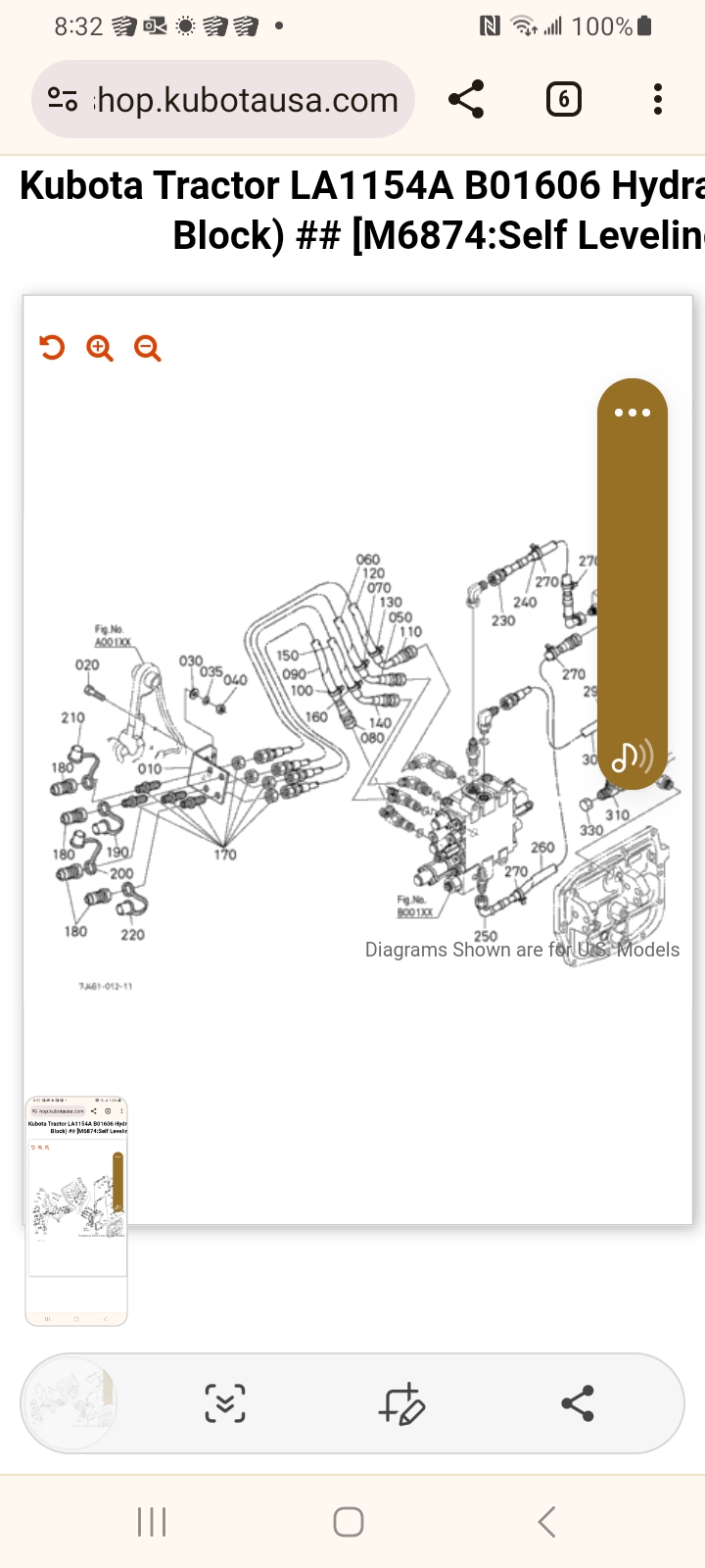

Thanks for the replies. I never received any e-mails showing I had replies, so I didn't see all the responses. My apologies.
Turns out, it's not a dowty washer, it's a washer and an o-ring like is stated above. I replaced the o-ring and stopped the leak. It appeared to be a dowty washer just because the o-ring was smashed hard and flattened against the washer. I didn't use any special o-ring, just one I had laying around that appeared to fit. Hopefully it does the trick.
