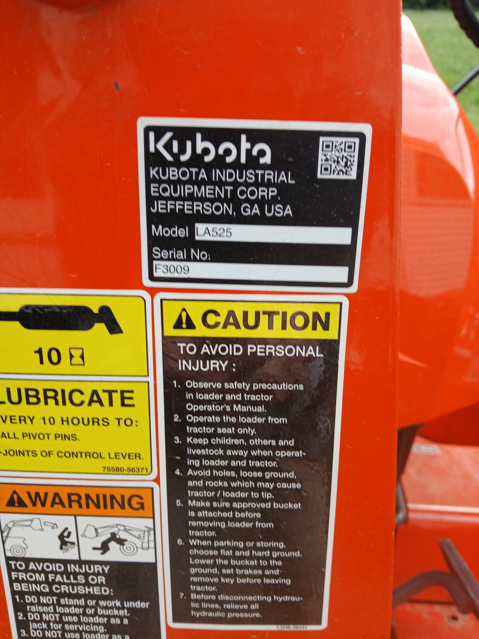

I suggest you check the s/n and/or model number of the loader valve on your loader. The s/n for the LA525 I purchased new in 2021 is F3009...

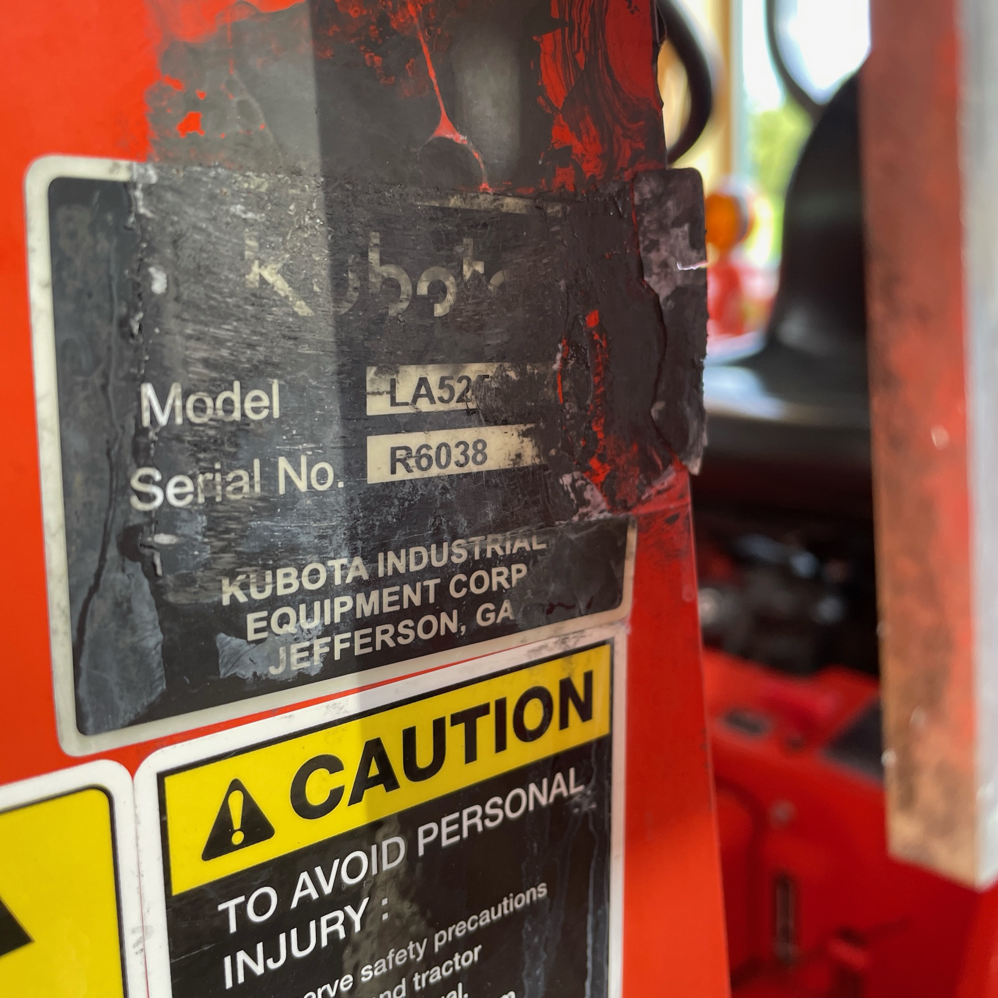

According to my 2016 sales contract, my LA 525 serial number is R6038. But my tractor and loader are older than yours so that number doesn't seem right. SN's starting with A must mean early machines and mine was sold 2 years after the L3901 was introduced. Unfortunately, the decal showing the number on the loader is covered by the mount I used for the front post of my cover. I think I can remove that mount to peek at the decal - maybe that is what I should do.
Will this never end?
So the paper work and the decal agree. I don't know exactly what part is being sent to me today, my supposed expert did have the spool valve model and serial so he could have ordered the correct valve.
How can I have an R number for a 2016 loader and you have an F number for a 2021 loader?

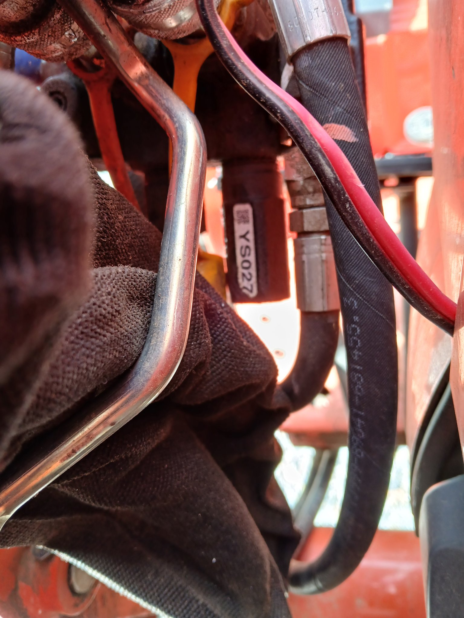

I can't decipher the serial numbers. Have a look at the p/n on the loader valve. Here is mine - clearly the newer one tjat uses the current load check kit.

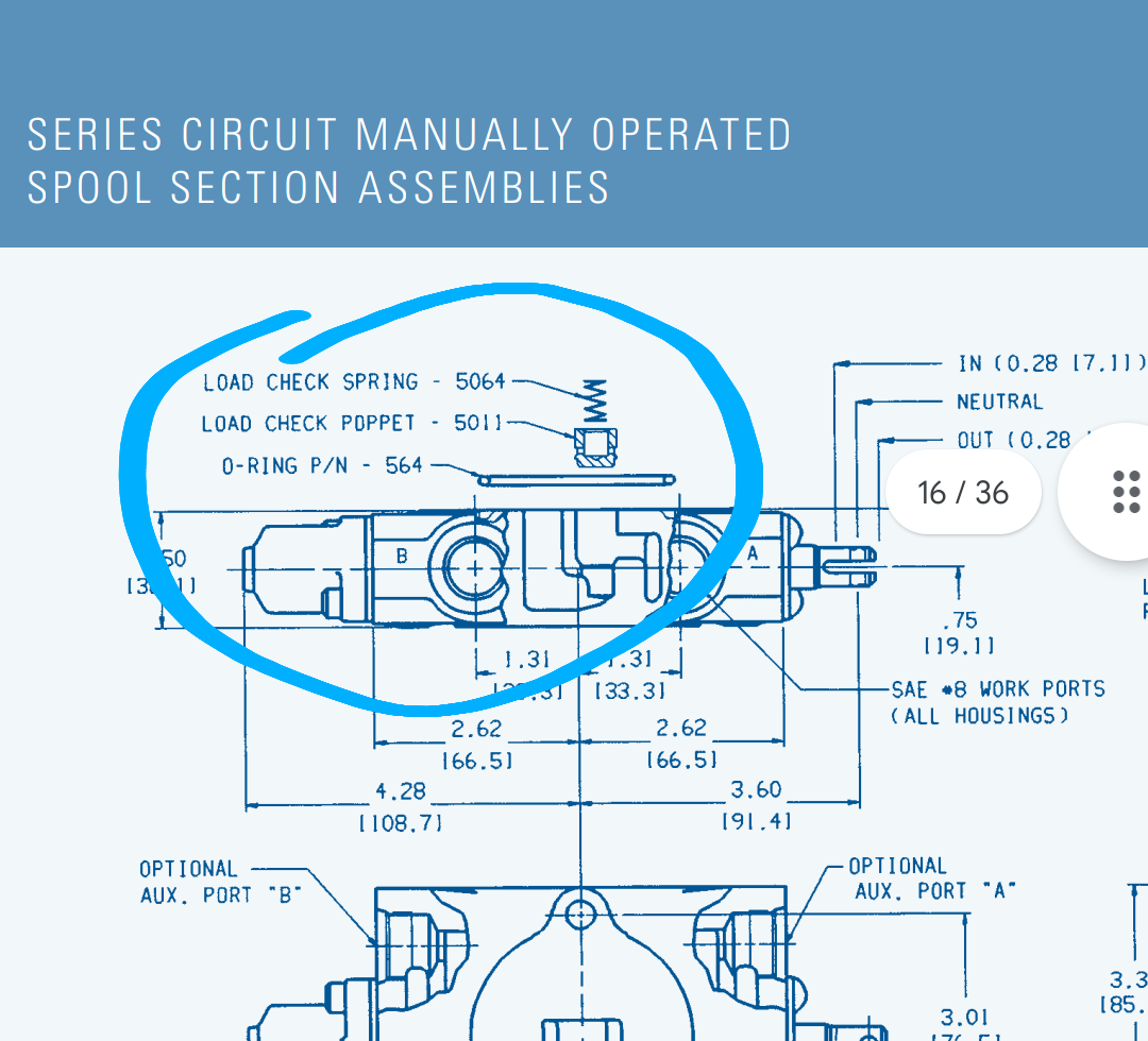

When this thread came up in the new posts I read it with great interest. A friend has a L35 and his tractor loader has done this from day one. He bought the machine used with very few hours on it when the original owner passed away suddenly.
The L35 uses a Husco 5000 valve. You have to separate the sections to get to the load checks. I'd recommend doing it on a bench.

Looks like that is only held in by the adjoining section and could easily be overlooked or fall out during assembly????
Yep, if you're not expecting it, that spring jumps right out. No problem if you assemble it lying flat.
