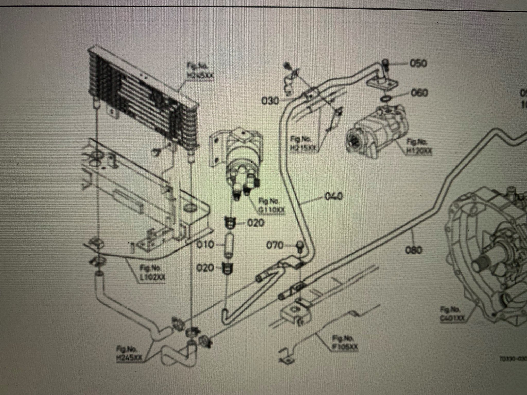

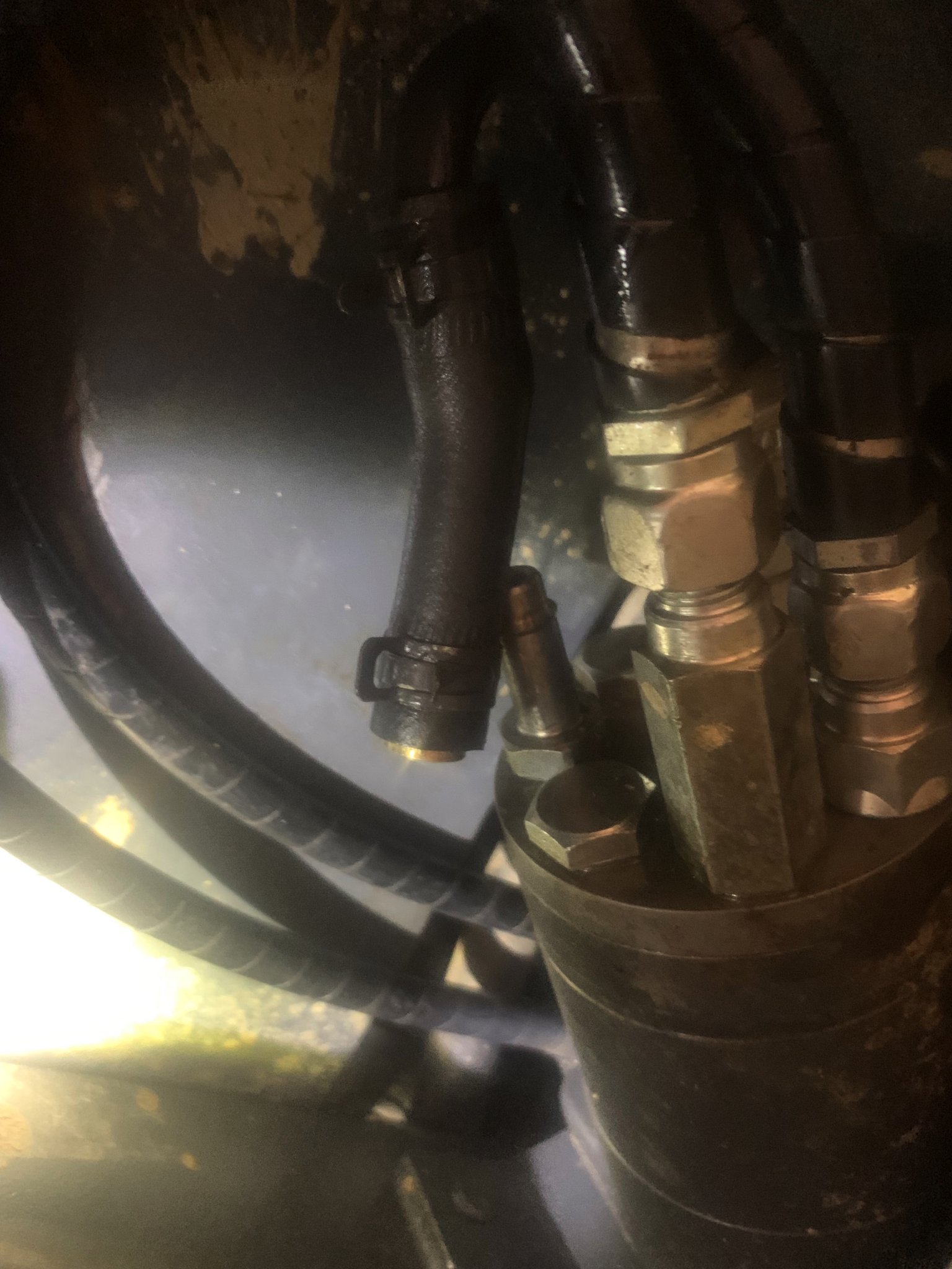

Fig no G110xx is the steering controller. It is located under front of tractor between frame, has 4 lines connected to it. One comes from the pump output 2 go the the steering ram that moves the wheels left or right. Then a 4rth is a return line. In the 1rst image, take small short line 010 loose from controller. Get a 1/2" brass plug that is used for pex water pipe and plug that line. Then get a new line about 12' long that is 1/2 ID and connect it on the steering controller to the place you removed the short hose. Run that line to a cooler if you choose to add one then on to the back of the tractor like I did in the previous image. Make certain to use the spot that has the plug removed with the elbow installed in the image. Some of the spots can't be used for it. Most small coolers don't have a flow direction but look at it for an arrow for direction of flow. The flow is going from front of controller to rear of tractor. I don't know if the cooler is needed but I am in a hot climate and it can't hurt. I ran it first without one and it seemed to be fine. The transmission oil is still going though the cooler before retuning to the pump and it has the majority of oil going though it. The second image shows the steering controller with the hose disconnected and the plug in the 3rd image installed at the end of that hose. The 4rth image is the street elbow that goes at the back of the tractor. It has male threads that are iron pipe threads, this screws into the place where the plug was. The plug has to be remove with an allen wrench. Then you need a fitting that has 1/2" MIP-Male pipe treads on one end and the pex type on the other end for the hose to go onto. It is really easy to get to if you take the bolts out of the seat mounting pan and hinge it up.. If you have a cab open the back window, slide seat partway forward and raise the pan and seat up on rear hinge. Their is a short metal arm that can support the seat and hold it for service position. Like a mini rod that holds a car hood up. All these fittings need to be brass so the oil won't degrade them in my opinion. If you use teflon tape like I did on the elbow, then make certain it is not too close to the end of the threads so it can't get into the hydraulic system. This line does not have any pressure on it just return oil flow so doesn't require high pressure hoses and fittings. You could use them but would be way more expensive. I would recommend getting the hose that is for power steering pumps because it can handle high temps. They sell it by the foot at most auto parts stores. I hope this helps.
