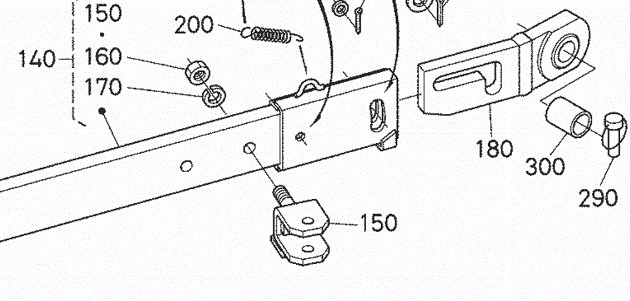

Bracket attaching stabilizer bar to lift arm broke for the third time (once left, twice right) just before finishing. Dealer had 2 right brackets in stock, so I'm not the only one breaking these. Left bracket will be next so will order one if they do not have one (didn't think to check).

I have noticed with mine the power fades when it get worked past 2 hours. The screens are clear, so its not a contamination issue with fins. It had rained previously otherwise id be clearing the screen often. I believe mine is over running the relief. I can hear it hiss in intervals. I still have good hearing, most probably wouldn't notice it since it is not all the time. Mine is fairly new and I haven't gotten the draft control all sorted out. I only adjusted the three point to not over run the hydraulics at max height. Ill know when I put a set of gauges on the lines. Fuel usage goes up tremendously when this situation occurs, and the hst fades as well. Fluid is getting really hot. I have not broken one of the stabilizers like you describe. My hog isn't as heavy as yours. I have noticed more wear/elongation of the pin holes on the outer stabilizer slide than I like. Having a lighter 6 foot, I would expect nothing more than the paint knocked off. If it is the mount im thinking of, it is shared among grand L lineup l5060-l6060 mx5000-6000. I plan on going pull type with my next hog. Any pictures of the bracket/mount?

No photos, but, yes, item 150. All three have broken at the first thread, indication of marginal strength. Yes, I do keep the nuts TIGHT.
