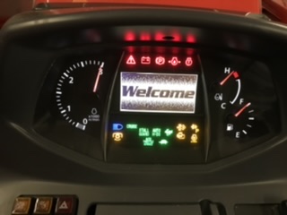

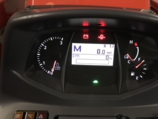

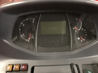

Here are some pictures of the panel, before key on, during check, and after.

So from my pictures, after 10 sec, the battery symbol light should also be on, the “electrical charge indicator”. The fuel pump can be heard to operate. After that screen, and if no glow plug symbol is displayed, I would turn the key against spring and crank to start.
It sounds like you have two questions, what is “normal”, and is it safe to follow the video you saw. It does sound as though after the welcome screen you are not seeing the battery symbol. Is the tractor starting and running normally?
My first guess is that it never hurts to have proper grounds. My free non expert advice is to check with dealer, and disconnect battery first. But this is a guess, no direct experience with modified alternators.
