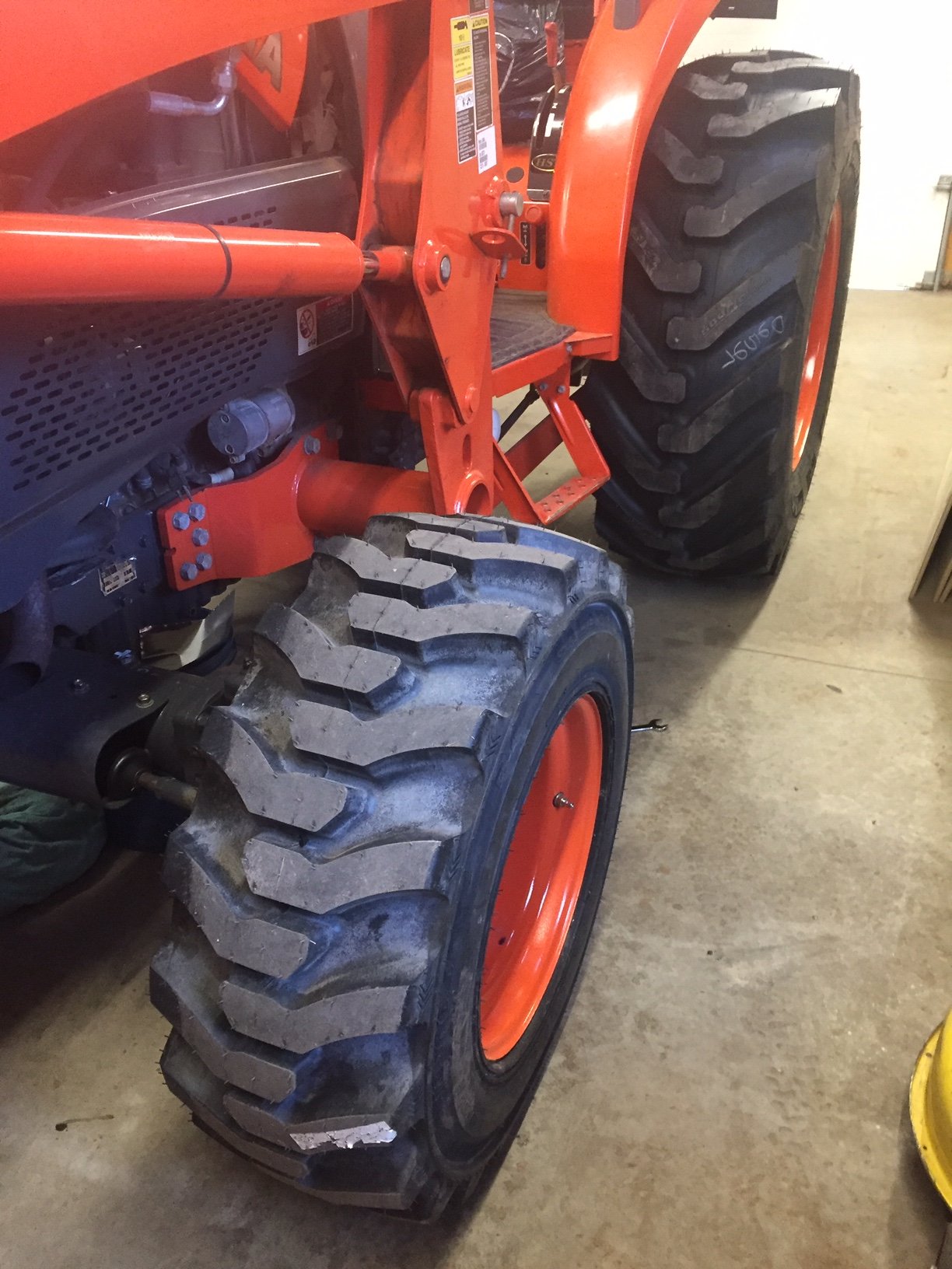

I had same problem with a different model. Dealers didn't know. Not in manuals. Kubota USA wouldn't tell me. Finally talked to a large farm tire servicer. He told me the approach they use for any brand/model of 4wd ag equipment is to always make sure that the front-to-rear static load radius ratio is within 2% of the OEM-spec tires. He advised sometimes you can get away with up 4% but beyond that you risk transfer case problems.
I never did confirm my lead/lag. All I know is the larger set of R4s I have now work a hell of a lot better than what Kubota offers. No problems, turns great, mud clears better, better flotation on the front when using the loader in soft soils, and much better traction.
