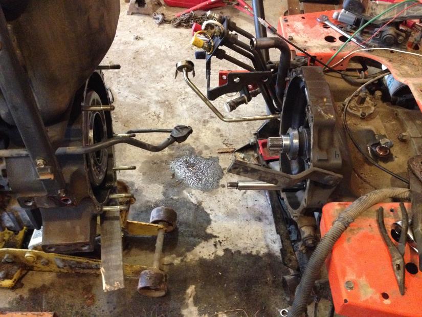

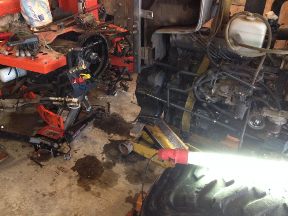

When I started tearing my 5240 apart to split it, I thought the operator platform had to be removed while I was waiting for my service manual. I unbolted the HST pedal and linkage and unplugged a pin connector. It was wide with several pins inside. I remember it was quite dirty.
Could it be possible this connector is loose, or there is damage to the wiring?
