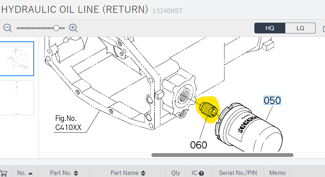

I picked up an HST filter & a transmission filter for my L5240. I got the HST filter off, but the new filter did not fit. They are not the same. I took the old & the new filter back & the guy looked them up. There is a threaded pipe adapter. I put it together the way the picture showed. It did not leak. I had to let it sit overnight, still no leaks. I started it this morning, and the fluid was all pushed out.
Either I didn't assemble it correctly, or there is another piece missing.
Also, any suggestions on getting the other filter off? I've broken two filter wrenches.

OK, first, the old filters are not Kubota, they are WIX. The only number I see on the WIX HST filter says 55. The part number on the HST filter I got from the Kubota dealer says HHTA0-59900. My phone doesn't do good pictures.

You're gambling with the Wix 55 as it's not listed as a cross to the HHTA0-37710.
The HST filter is HHTA0-59900
If you didn't install the nipple into the case properly that could be why the filter didn't stay sealed.
The slotted end ends to be pointed out.

Thank you for that picture. I did have the nipple inserted correctly. I think I figured out the problem but have to get some fluid refilled before confirming the problem. I was looking at the nipple & focused on that as the problem, I completely ignored the fact that the O ring was so loose it wouldn't stay in place when I was holding the filter. I think it probably was not seated when I did my final tightening and when I started the tractor and tried to raise the 3 pt hitch, the fluid just blew by the O ring.

Update: My apologies for being all over the place in reporting my issue with this filter, my eyesight degenerated last fall, and I need to replace my glasses for near vision.
When #050 & #060 ended up not working, I discovered there was a 3/8 inch thick plate with an attached larger nipple that fit the WIX filter. That plate screwed onto the smaller nipple inside the tractor. The new #060 screwed inside the nipple on the plate, new filter, #050, screwed on, but the large nipple blocked the filter from screwing on all the way. I removed the plate & the new Kubota filter screwed onto the #060 nipple that had been there all along. As soon as it quits raining I'll refill the fluid & fire it up.

Yes that's a filter adapter, they fool a lot of people.
