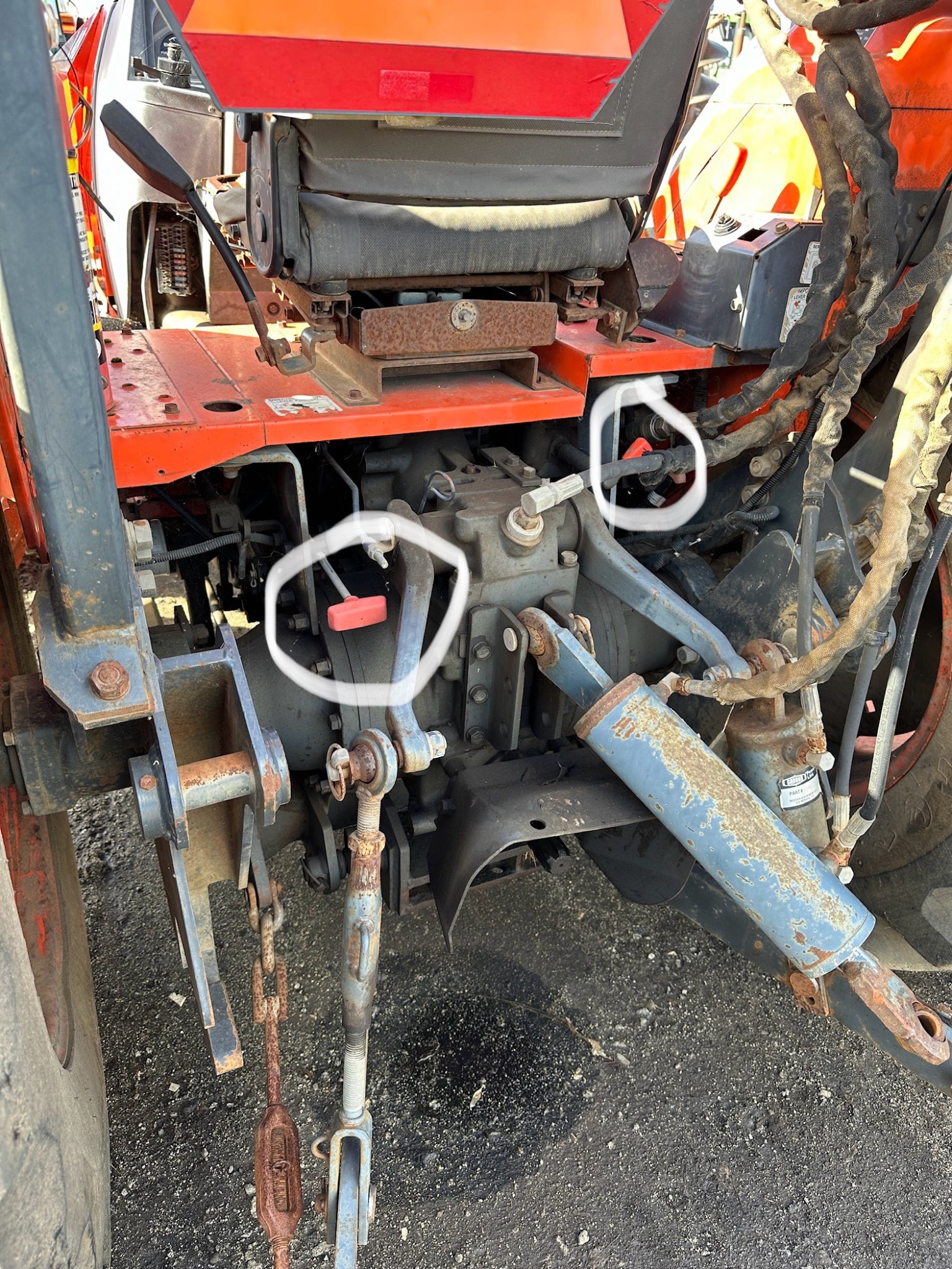

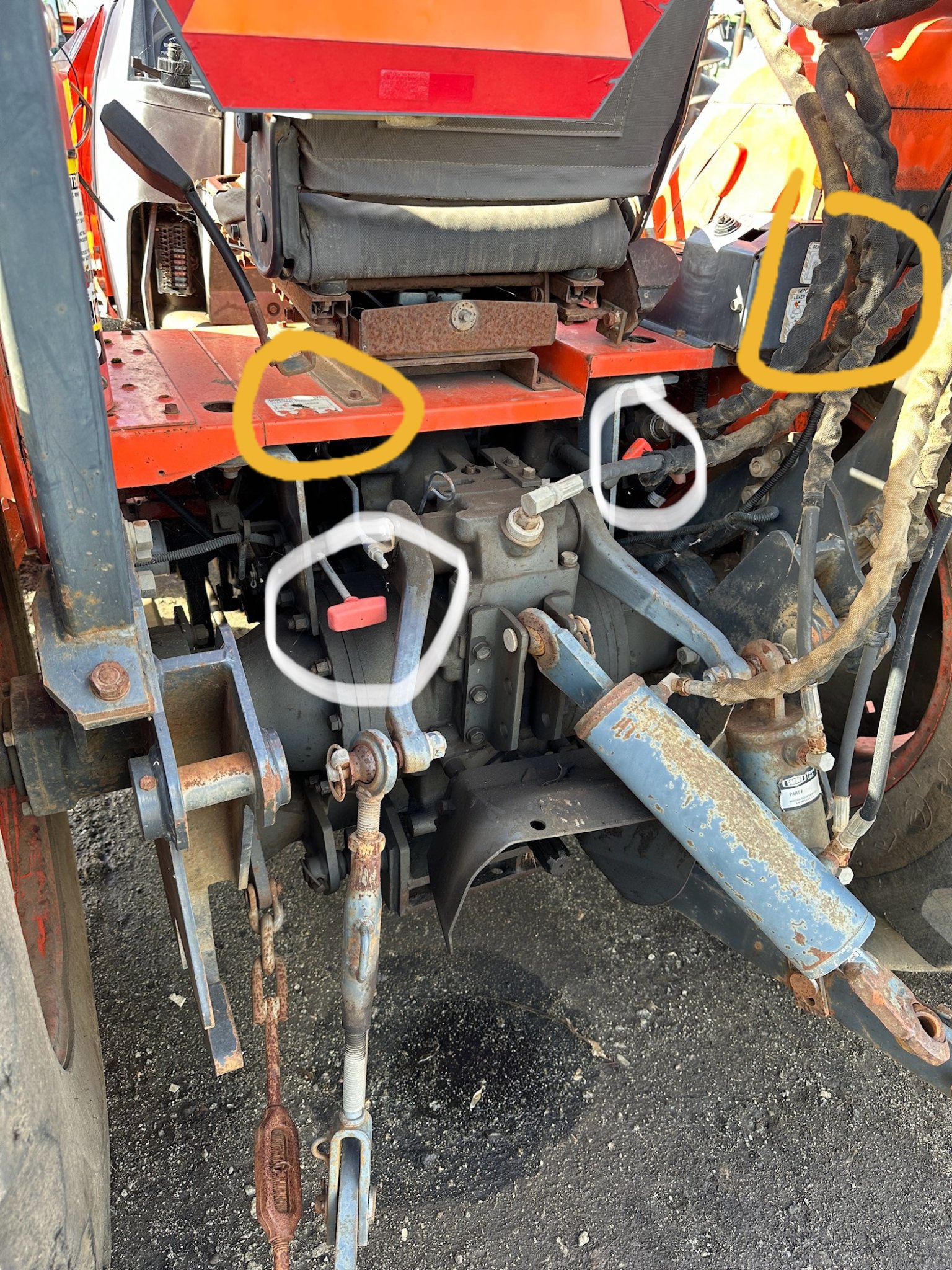

Hey y’all have a question. i just purchased a L48 from auction and was wondering what these two levers/knobs did? And what position they should be in and for what purpose?
Thanks in advance

I don't know what those levers are for, however, I would get some penetrating oil on the three-point hitch parts and let it soak in until you can work on them to get them loose. It looks like the previous owner put all the toys onto that tractor, at least in the rear.

From the L48 TLB WSM....page 12-S2
The lever on the left side of your picture must be in the "Three point hitch position".
I believe that position is pulled all the way out. (should be marked)
The lever on the right side of your picture, must THEN be in the "Without backhoe position". That position should be turned all the way to the right (should also be marked).
I do not have my copy of the operators manual handy.
Per WSM: It is very important that these be set properly, or hyd. damage can occur.
I have the WSM in my hand, but my L48 is far away.
I would strongly suggest that you buy/find a copy of the L48TLB WSM.
E-Bay has 'em:
326051669565 ....$56.44
296053968657.....$49.99 + $8 ship
304942043933.....$64

They are to control the flow for the backhoe when installed.
See if you can find an owners manual if not the workshop manual.
See post #3,...... just prior to your post #4.

All the above replies are correct, they are for the backhoe. I can never remember which way they are supposed to be and my stickers were illegible when I got my l48. Yours seem to be in decent shape for the most part.
