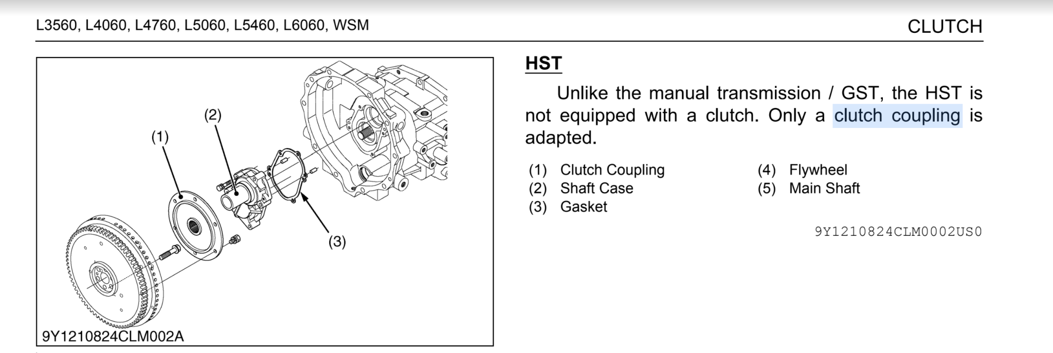

Hello everyone, I wanted to update on this thread and ask for some advise. Ok, I parked the tractor and place a new bucket under that plug, and sure thing over 2-3 weeks entire supply of transmission oil was in that bucket, so I know for a fact that the leak is from that went. However, as you mentioned here, oil should be there and it seems that we have the following. When the water gathered there it wasn't drain and then there was a really cold weather where the water froze. and this gasket (3) I think got ripped. Thoughts?
and if this is the problem, splitting the tractor is the only way to get there, and maybe some of you know what is the part number for this gasket? Thanks

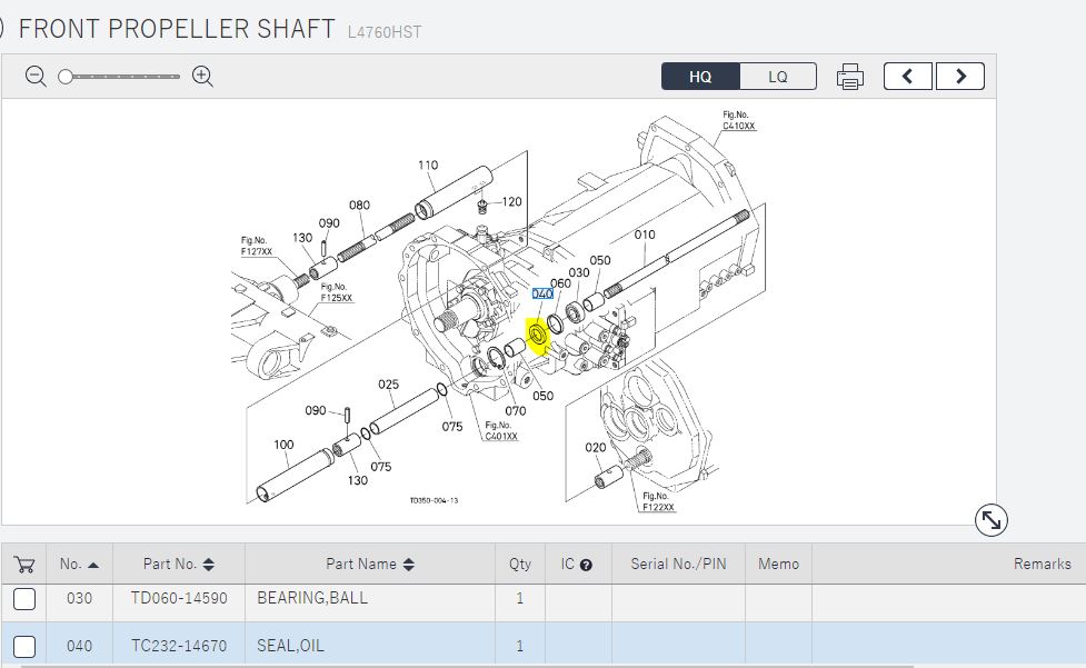

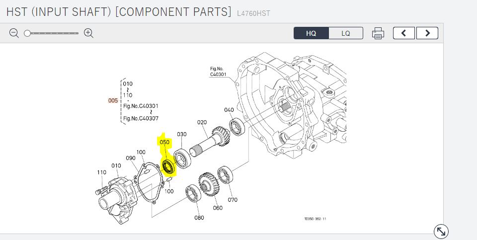

Your leak is very likely the seal for the propeller shaft for the 4wd.
it runs through the case just above the spit pin (Clutch housing vent).
You need to talk to a local dealer about the parts (have the serial number off the tractor) because I do believe there was an upgrade kit for that seal.
It's very very unlikely that it's the gasket leaking, could be the seal on the input shaft but that seal normally doesn't leak.
As far as repair goes I think ( but don't know for sure) that that seal on the propeller shaft will come out the front to be replaced. You DO NOT remove the shaft section that is in the transmission, if you do you will be tearing the whole thing apart to reassemble it.
Propeller shaft seal

Being that you are in Europe parts for your particular tractor might be different (some EU tractor parts are different than US tractors), Rather a shock to see you are pinging in the center of Russia, I didn't think that was even possible.
Is there a local Kubota parts dealer?
Part numbers for what you want to do are based on serial number, so would need to know that to get you the right part numbers.
View attachment 93945 View attachment 93946

Do you have the WSM (aka Service manual)?
The screen shots are from Kubota's parts site online.
