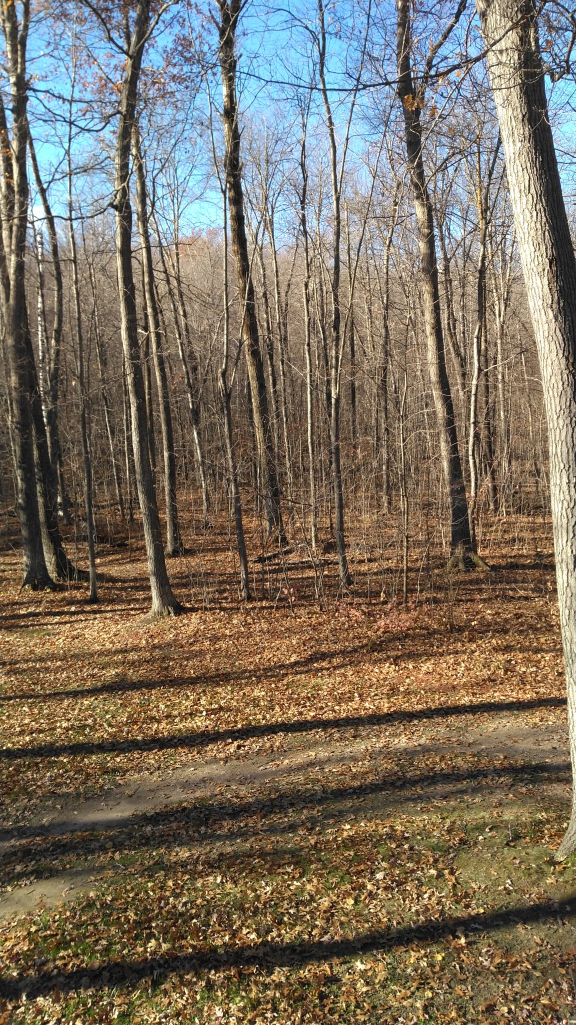

One other thing, what's the best implement to knock down saplings in the forest? A flail? Rotary cutter?
I've got acres of this:
It's hard to see the scale and to know what you consider a sapling. But what I'm seeing is not work for a tractor. If you don't mind leaving the roots, a CTL with a forestry head would do nicely.
I've pushed over saplings up to about 4" with my loader bucket, but it's hard on the tractor. Smaller ones, you can get the bucket under and pop out. Then you have the issue of what to do with them.
The other day I cut a double 6" sweetgum and dug the stump out with the backhoe. It took about 30 minutes. So it can be done, but I'd hate to do several acres unless I had lots of time and patience.
I'd like to clear out anything 1" dia trunk and smaller in some areas.
Hate to have to do it by hand. Hate to rent buy or hire forestry specific equipment, but I may have to. Maybe a sickle type cutter. Not concerned too much about roots. Maybe some sort of fel bucket cutting edge that pinches the saplings into grooves and pulls them out as I drive forward.
A mastication head on a large piece of equipment (loader or excavator) or chainsaw. This size material is not for tractor operations, but once the work is done you can probably maintain sprouts with a rotary cutter on a tractor. For the initial work, talk with your state forestry cooperative extension forester.
Hmmm, my RCR1860 will chew up 1in diameter stuff all day long. And that’s with an L2501. A4701 or 5400 will have no problem with stuff that size. You’re not going to go over it at high speed but I wouldn’t buy anything more special than a rotary cutter for that stuff.
That photo shows a lot of very tall stems that need thinning. Most appear to be larger than 1” diameter and at least 20’ in height. I’m a forester, so I sized this up quickly by looking at the photo. No way this is appropriate for a tractor and rotary cutter.
I was going by the statement the op made “I'd like to clear out anything 1" dia trunk and smaller in some areas.”
That doesn’t give me the impression he was talking about clearing that land down to dirt Removing everything By that statement. No I don’t think a rotary cutter will take down those full size trees and I don’t think you need to be a forester to size that up.
