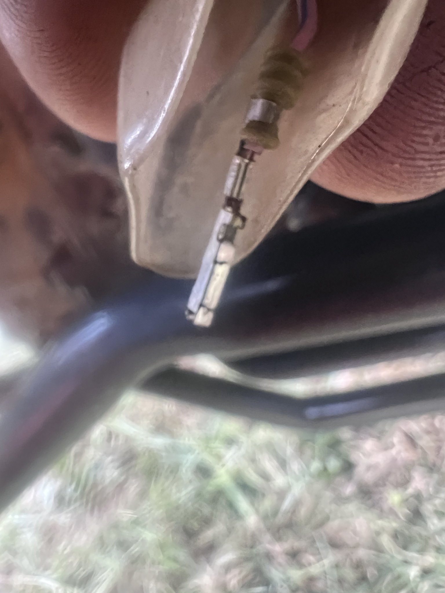

I see this is old but I have the same problem on an mx5400. Wire got pulled out of the connector so pto won’t work. Tried putting wire in connector but it pulls out too easy so probably not making a good connection.
any tricks to reseating these?

I just had the same problem with my MX5400. It's a Deutsch pin and socket terminal and all I need is the socket (female) side. Such an easy fix that you would think Kubota would have old wiring harnesses that they could strip terminals from. Did you ever find a replacement?

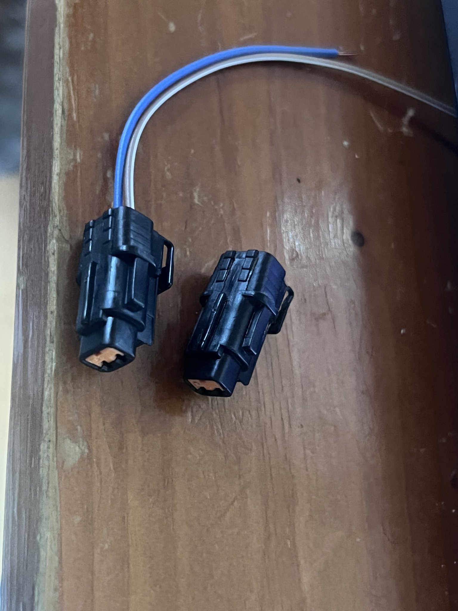

I ordered the hht1k-91103
I got the replacement number hht1k-91103 from daredevil1166.
I ordered the part and got it today and it looks right except it has an extra wire which is fine
I’ll replace it after the rain stops to confirm but should work.

If you take the plug apart you will find that there is a blind plug in the second spot.
