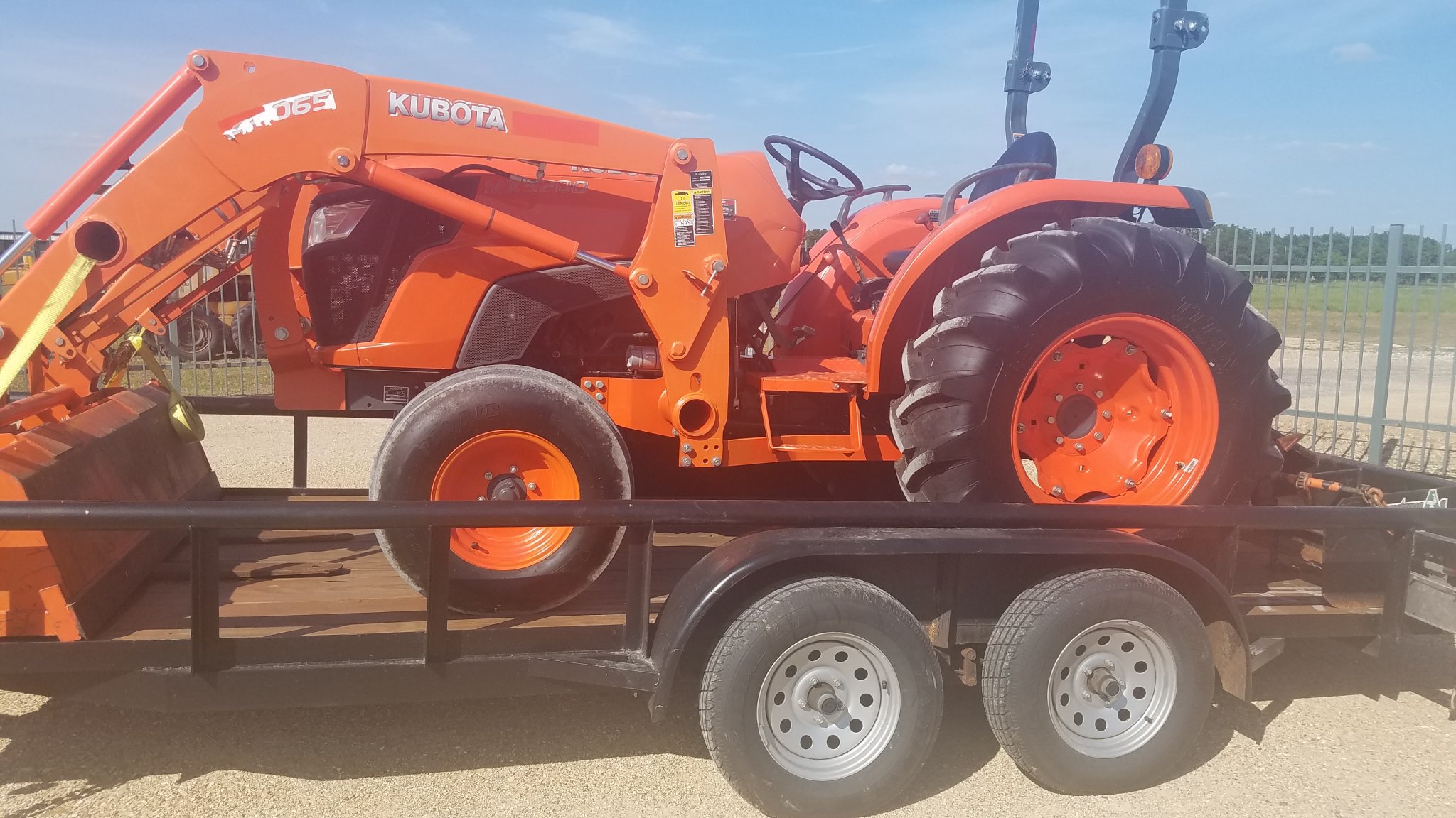

I recently got the 5200 ....and as said the implements aren't an issue. I picked up the conversion sleeves for few dollars and my attachments used on my 1953 Ford NAA hook up fine...cat1 or 2 doesnt matter.
I went bigger to handle round bales with the loader. Personally, I would go with the 5200 for those few times the extra size and hp will be needed.
Fyi...may shop for a good used model. I found this 2014 with 97 hours with the loader and is like new for under 15k. Its 2wd and you may need 4wd, but depends on what your needs are.
