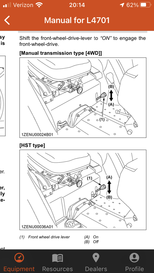

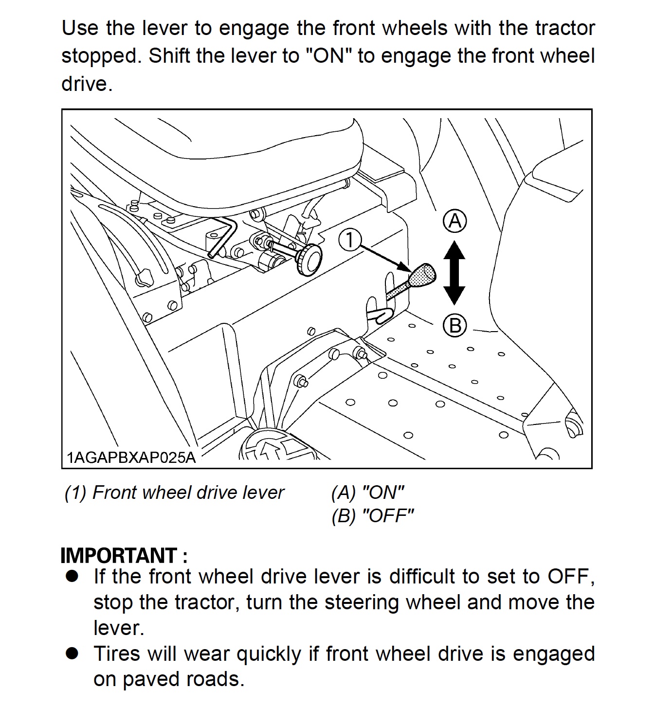

It is in 2 wheel drive now. I push down to engage the 4 wheel drive - the lever goes down but I cannot detect the 4 wheel drive engages.
Thanks for taking the time for any input.
Do you have the operators manual? Down is 2WD (MFWD off), up is MFWD on (4WD). Thats how it works on mine.
2,537
3,623
Which position is 4wd for the L4701 can be a bit confusing, although I’m confident you’re familiar with your machine. For the gear drive, down is 4wd; for HST, up is 4wd. There should be a little picture on a sticker beside the shifter on the tractor but although it’s probably clear to most people, I about have to get off the tractor and study it to figure out what the little cryptograms mean. The movement of the shifter is quite slight.
If you don’t shift in and out of 4wd often, I’d double check the position of the shifter very carefully before tearing into anything.
