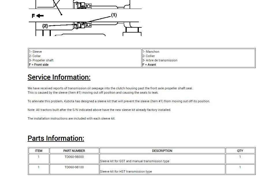

You need this sleeve kit to keep the bushing in place.

Sealing the L-series front drive shaft has been a recurring issue since Kubota moved it up to be included in the transmission. There have been several seal designs, with variations by tractor model and market. The diagram posted above by eserv shows a circlip retainer that isn't present on US models I've seen.
On one I recently had apart, back-and-forth shaft motion is kept quite small by the assembled clearances of the front shaft, couplings, roll pins, spacer, and o-rings. As it goes together end float should be limited.

When I took apart my L48, there was a spacer pipe with o-rings on each end that keeps the 2 oil seals from migrating forward. Page 3-S17 posted below from the WSM shows the original layout, but not the pipe spacer, because it wasn't added until later. On mine there was no circlip, groove, ball bearing 11, or separate collar 060.
Your shaft shouldn't move back and forth that much. For the L4630 there are 4 versions of the pipe spacer and collar(s) depending on tractor serial number and whether you have HST (see parts 030 & 060 on attached parts pages). When you order new seals and o-rings, see if the dealer can confirm the correct spacer and collar parts for your machine.
The oil seals ride on a small polished sleeve on the shaft. The sleeve is lined with rubber, needing 50lb to push along into place. Good luck - Dick B
